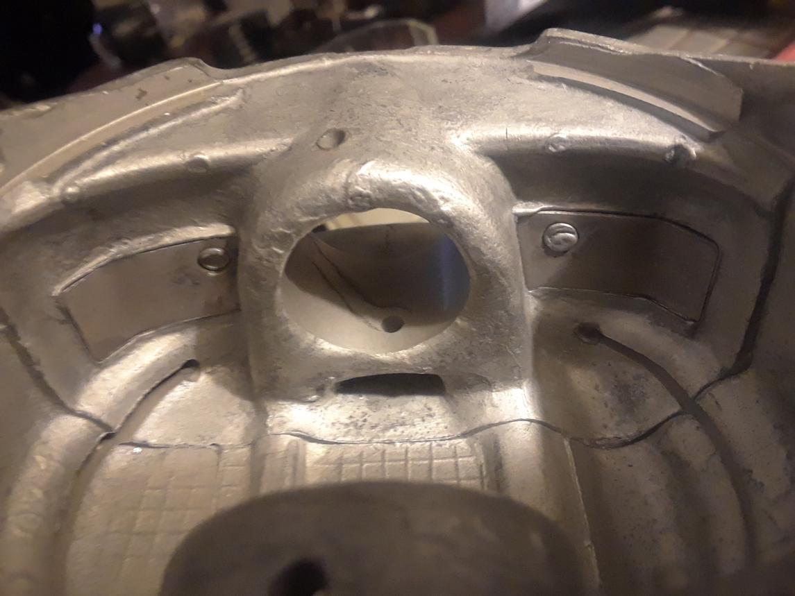

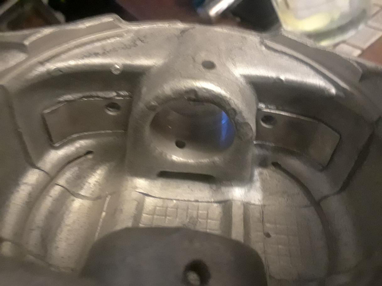

i recently purchased some closeout beck/arnley piston kits from rockauto for cheap, kinda hoping they were japanese oems or close..the korean made pistons i recieved seem a little crude and rough in the casting department, and then im like, 'wheres the pin clips and grooves? these are defective!' then i look in my fsm and read that the pins are pressed in! ive been wrenching on .mostly motorcycles and plenty of cars for a while and have never come across this before and its a little unnerving to be honest...i mean, ive had pin clips fail and wreak havoc in engines before. aluminum expands faster than steel so are the pins floating around? on these pistons and other brands ive been able to pull up pics on, are these steel or stainless plates on either side of the pin bore inside the piston that are also a bit concerning b/c i dont know how theyre affixed or what theyre for or if theyre going to fall off and wreak havoc in my newly rebuilt engine! there are also holes in the plates that seem to be some sort of peened mount that go thru the piston on the rear side of the piston but on the front are blocked...can anyone shed some light on this stuff?

I agree that those castings look pretty sloppy.........but who knows how they'll hold up. Perhaps it doesn't matter? On many, many engines (including small block Chevy and the Toyota 4Y) the wrist pins are a "press fit" in the steel connecting rods and the pistons float on the pins (slip fit). Although it's called "press fit" most machine shops do not actually use a press. Most shops will heat the pin end of the rods with map gas to expand the steel, then the pins will fall right in. You need to move fast though, because once temps begin to equalize they grab on tight. No fun trying to adjust if you don't hit it right, and you'll likely break a piston or damaged the pin/rod if you try, so make sure you get it right. Making a simple jig/fixture to hold things in place will make it fast and simple. I searched YouTube and found a good video of a guy doing this on a SB Chevy engine: https://www.youtube.com/watch?v=dsGFwz1zviM. I wouldn't worry about reliability of this method as I've been pulling wrenches all my life and still haven't seen a pin shift inside a rod. When I rebuild engines I usually just let the machine shop install pistons on the rods. They do it all the time and have it worked out to a science.
Regarding your quandary with using those pistons, I have to admit I'd have an issue too. You can't judge a book by it's cover I guess, but such obvious cosmetic slop makes you wonder. I have a new set of 4y pistons out in the shop so I grabbed them and took a few pics (so you can compare). Mine are also aftermarket purchased off rockauto. Mine came in an Engine Tech rebuild kit and are Engine Tech brand part #P4637(4) .50. Tim

wow, i was thinking the pin was a press fit in the piston not the rod..how about those 4 plates? so, im wondering now if its slop in the wrist pin bore that could cause the 'piston slap' or 'rocker clatter' noise that goes away when warm...
seems a little sketchy the guy in the video heating his rods, even if not red hot could still compromise the rod...
Those steel plates are called "reinforcing struts". They are used in cast aluminum pistons to help control expansion and to aid with support of the wrist pin. When it comes to engine work, we are basically just "installers of parts", & there's nothing we can do about the manufacturing end of things. As such, there's not much point in worrying about this stuff.........except when selecting brand and quality of components.
Piston slap. If you hold an assembled rod/piston in your hands, you'll notice the piston rocks from side to side. When it's installed in the engine it needs this movement to stay straight in the cylinder while the crank moves the other end of the rod side to side. Since the rod is moving side to side, there's a tendency for the piston to "rock" a bit. That's why the piston skirt is longer on the thrust sides (to help minimize this rocking). When pistons and skirts get worn, clearances are increased and they tend to rock more. The noise associated with the pistons rocking back and forth (skirts hitting the cylinder walls) is called "piston slap". Because aluminum pistons tend to expand/contract more when heated/cooled it's most noticeable when the engine is cold.
Wrist pins can make noise too, but those tend to not be associated with cold vs warm engines.......although I'm sure there can be exceptions.
Regarding that video, I'm sure there's better ones on YouTube, that's just the one I clicked on 1st. I didn't watch the whole thing, I just skipped to the part that showed him installing the pin..........and that looked to me like he was doing it right. If you're doing this yourself, the important thing is to not heat the rod too hot. That's why I specified using Map gas (as it would be difficult to overheat). You heat just until that area turns blue, then assemble quickly. If you were using a hotter burning gas (like acetylene) it would be easy to overheat and weaken the rod. If you're installing oversize pistons, you'll need the block bored anyhow, so just let the machine shop install the pistons on the rods. Tim
