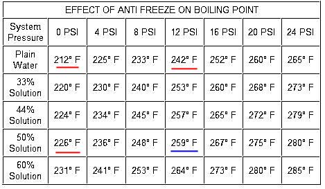

Some facts to consider: @ 0 psi (no cap) a 50/50 antifreeze/water mix boils @ 226° F. @ 13 psi, it will boil @ 261° F. @ 19 psi, it will boil @273° F.
When you shut-off the engine the coolant circulation stops, so engine temps will temporarily increase (I'm guessing around 30°). Other than possible heat soak issues this is of little concern because the engine is stopped (no wear on moving parts). However, if your engine operating temp is >230°, it will likely boil-over after shut-down and you'll lose some coolant (at least with a 13 psi cap). This is the only scenario where the 19 psi cap could help, but it would only reduce and/or eliminate coolant loss. If your van is running hotter than 220° F, then you're better off finding and solving the root cause rather than using a higher pressure cap (band-aid). Just my 2¢. Tim
