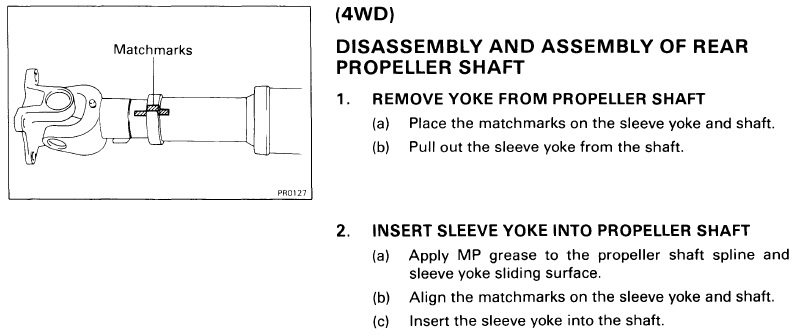

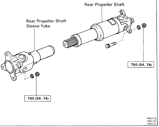

Ok. I went to sleep, woke up, had a good breakfast, and then referred back to this thread, the link posted by boogieman, and the FSM and I believe my crisis has been averted. What I ended up doing was removing the zerk fitting from the drive shaft, which relieved enough pressure to pry off the drive shaft so I could essentially start over and get my drive shaft "back into phase" so to speak. I followed the advice in the thread linked to by boogieman (thanks again man) and reoriented the two halves of the drive shaft so they looked as they appear in the FSM below.
Attachment 5690
Once I had everything back to normal, it was a simple matter of reinstalling the zerk fitting, popping in the drive shaft (which was much easier after removing even more grease), and reinstalling all the nuts and bolts. I took it out for a quick shakedown and the vibration at speed was completely gone as was the growling/grinding sound I was experiencing before, so I'm confident enough that this was the root of all my issues. I'll make sure everything is torqued down properly after work and then I'll put some miles on it and see what happens.
Lessons learned here: 1) Don't put grease through a zerk fitting with the shaft out of the vehicle. If you have to do so only put in one or two squeezes as opposed to the 6 or 8 I did (seriously didn't think enough grease could even pass through that tiny fitting but oh well). 2) READ AHEAD if you have a FSM, as a couple of pages after the first image I saw this:
Attachment 5691
Which would have at least prevented me from freaking out as much as I did. Thanks again boogieman for the knowledge, hopefully someone else sees this thread before they make the mistakes I did so they can save themselves the time and aggravation.

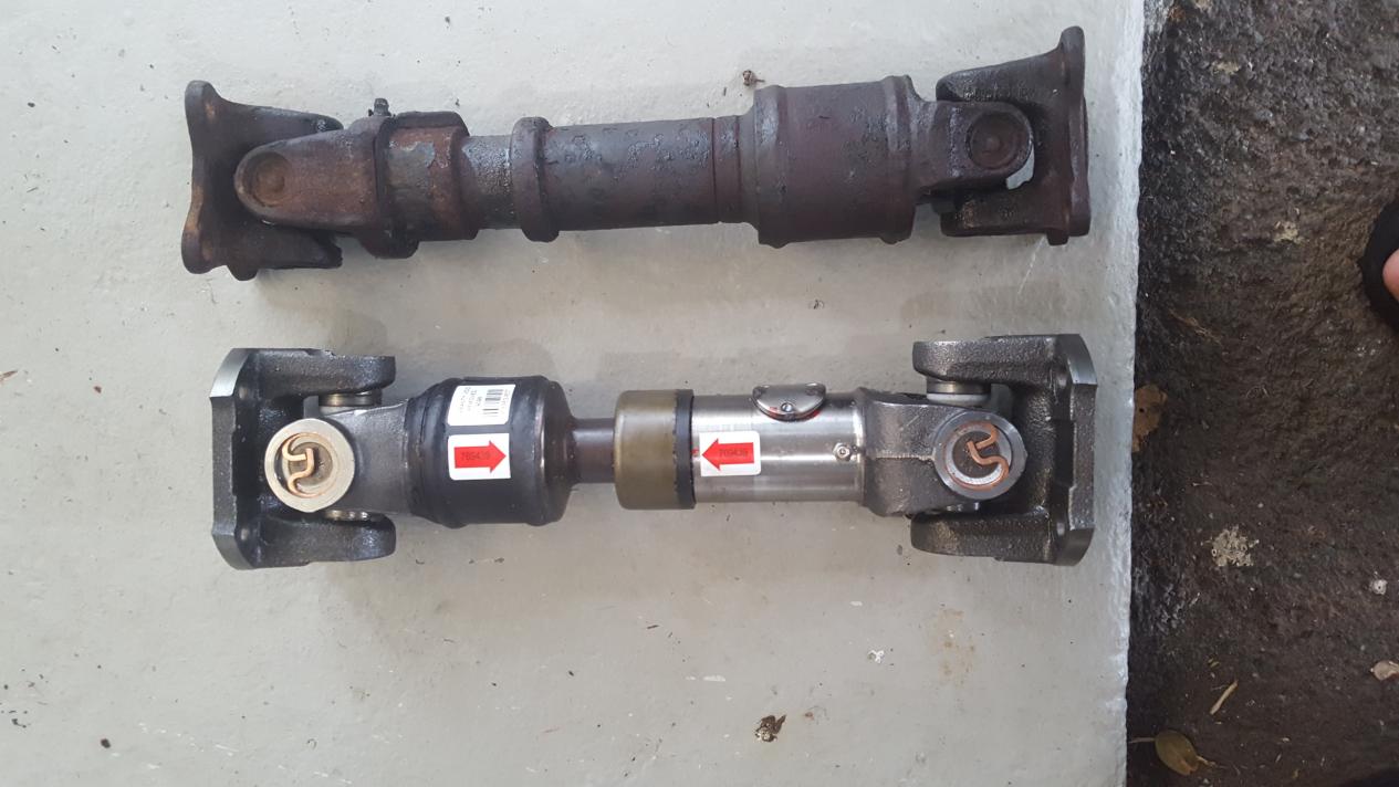

Re: Drive shafts and u-joints
The Powertrain rear shaft arrived in no time. Really good looking piece of work. Quick bolt on and no more clickety-clack emanating from the back.
Attachment 8768

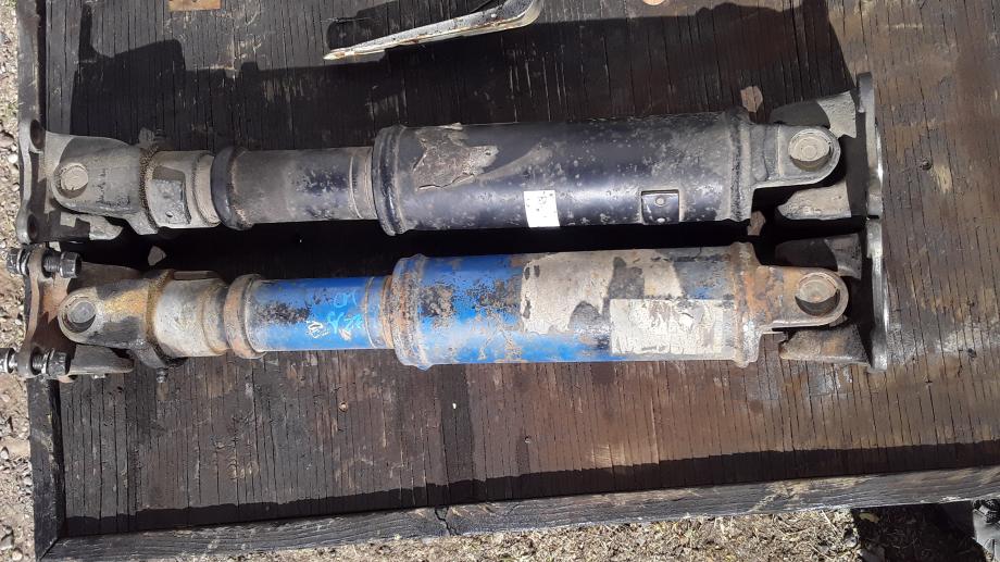

Attachment 10735
well curiosity got the better of me, i needed a hitch for the T100 as well so headed to the upull and pulled the rear driveshaft from a 1991 auto alltrac and its darn near identical to an 87 4x4 but the alltrac is approximately half an inch longer. thinking since everyone wants to lift their 4x4 that this would work as is, or at least get a traveler back home..same staked ujoints but this one feels nice and tight for $19.99 plus all the bs fees..im thinking the standard trans alltracs are probably the same but curious as to the supercharged alltracs..i know the yoke size changed on 2wd sc vs. normally aspriated previas...
