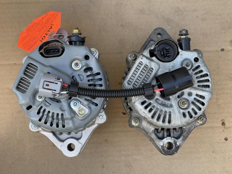

Regarding the wire harness, I did a search and found a "plug & play" adapter:
https://www.ebay.com/itm/16285429297...caAlRqEALw_wcB
In case you wanted to modify the van harness, I also found this:
https://www.amazon.com/Alternator-Re...15387481&psc=1
Here's the pin lay-out (I labeled the bottom left image):
https://hosting.photobucket.com/imag...Harness(1).JPG
Labels are identical to the Denso van alternator schematic on post #27, so you can simply match them up by function. Tim

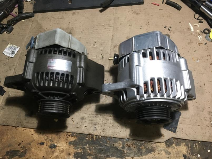

It came in today, and yes, except for the pulley, they are indeed identical. The Van pulley is a 4 rib, the Suzuki is a 3 rib and about 1/8" narrower. All other measurements are the same.
I suppose a guy could swap the belt and just run a bit narrow on the fan, but I think I'll just swap the pulleys...

well i wouldnt say identical, the suzuki alt looks beefy! and after all this time a tacoma alternator would fit with a harness adapter as well? ill also ad that a 85 to 89 mitsubishi eclipse has the same alternator as our vans as well..

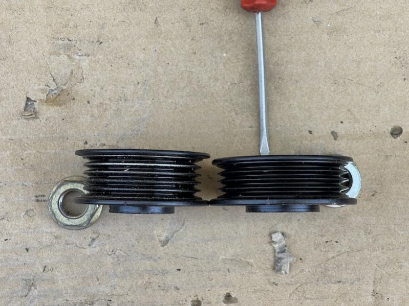

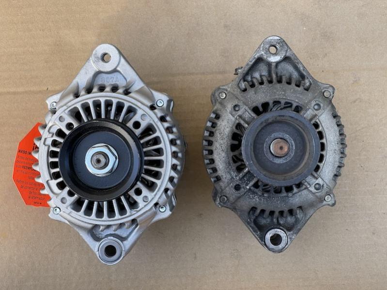

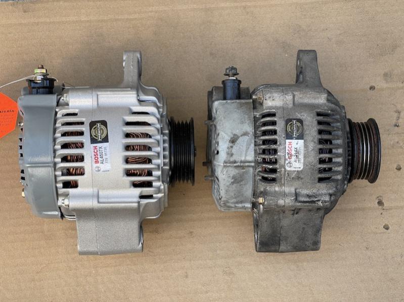

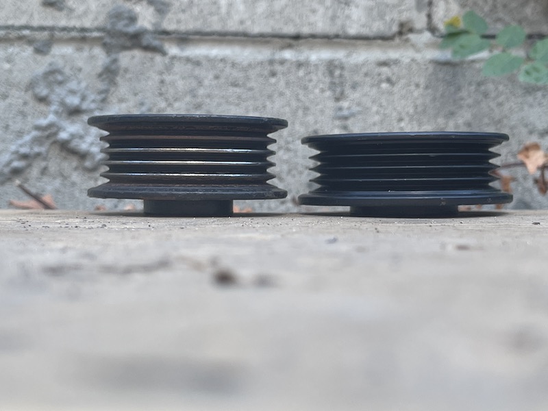

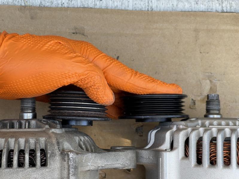

Following up on this as well. Since Denso 210-0461 seems unattainable at the moment, I went with a Bosch AL4507X which is supposed to be the same fitment.
But my AL4507X housing looks exactly like the AL214X alternator in my van already. Unlike tlight's photo where the Denso (is it a Denso?) looks bigger.

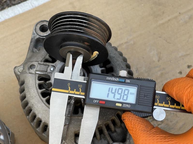

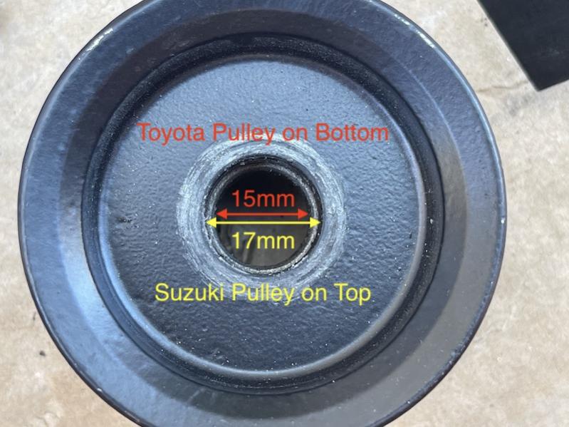

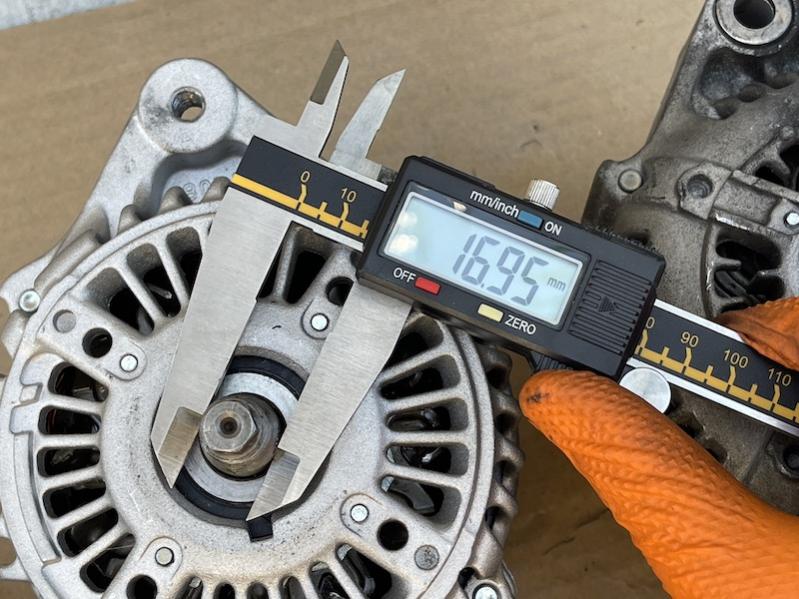

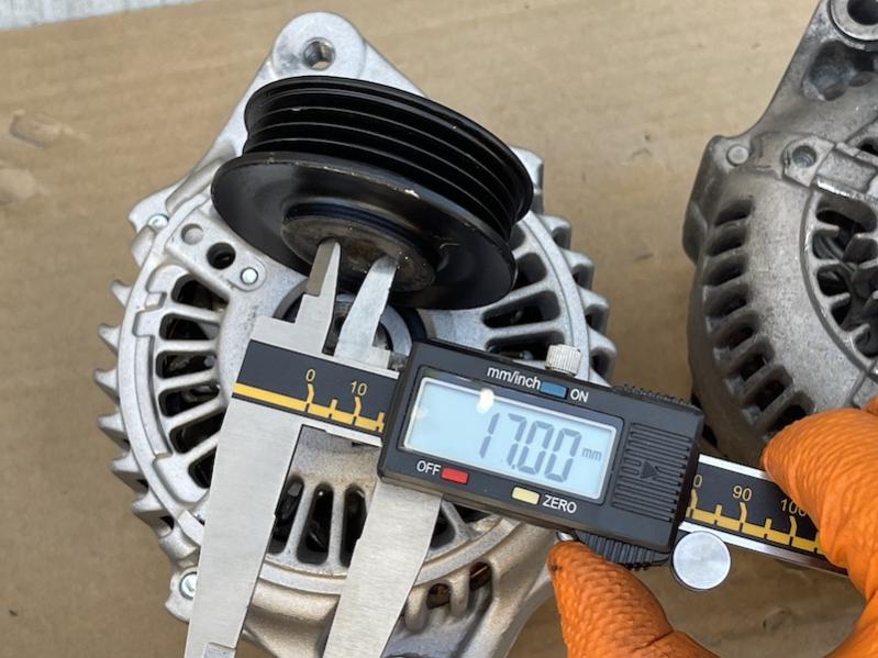

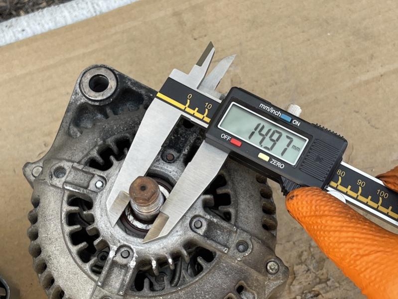

Where I ran into problems is the pulley. The "Suzuki" alternator has a 17mm shaft, but the "Toyota" alternator has a 15mm shaft, which means you can't put the Toyota pulley on the Suzuki alternator. I'll have to look at the pulleys again to see if a 3 rib belt would line up correctly and run straight.
At least I grabbed an extra pulley at the junkyard (which was way too expensive, I think I could have gotten a new one for the same price, but they cut me a deal on my other parts, so I guess it works out), so I might see if I can get it machined to a 17mm opening.

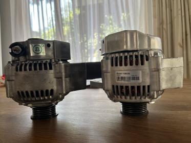

I have not finished installing it, but i had the exact same issue, I got a Wai 13982n alternator. I also could not find a denso from a source I trusted. The Wai alternator was local and cheap.

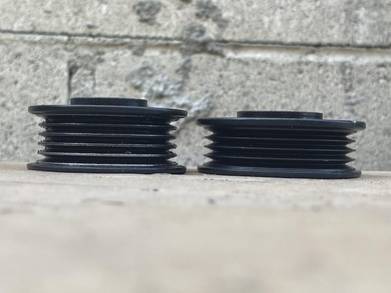

For me also the toyota pulley did not fit,I bought a new pulley, but it did not fit either, so I gave up, and took it to a local alternator/starter repair shop.
(Don’t know why, but these shops are everywhere over here. All (almost) retired men that fix electrical motors and alternators in their sheds)
The guy had two boxes with old pulleys for me to fit. I found one, that I thought fit perfectly, but the repair guy did not agree. He showed me, you should set both alternators on a flat surface, with the pulley down. Then compare or measure the distance from the mounting to the flat surface. If it is exactly equal, the belt will line up.
The guy put the pulley I found, on a lathe, and corrected it for me.
Attachment 11653

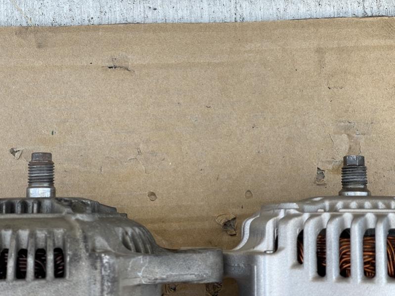

Looking at the pictures, it looks to me like the rotating inner part is half an inch longer, it is longer at the backside of the mount.
Ah yes, I just discovered that too. The length of the pulley shaft seems to be different, so the backside of the Toyota pulley would also need to be machined down a bit.
It's too bad I cut my belt getting the alternator out. It had worn down to 3 ribs. It would have made a great test belt for 3 ribs!
The good news is that I've figured out how to get the alternator out the top side on a 4WD with just the overflow tank and bracket, lower fan shroud and the alternator tightening adjustment bolt removed (it's still a tight squeeze!).
I also learned that the Bosch alternator is 95 amp, while the Denso is 105 amp. Makes me wonder if there are more differences to the Denso alt, but a different pulley and shaft diameter/length would seem like weird changes for supposedly interchangeable alternators.
