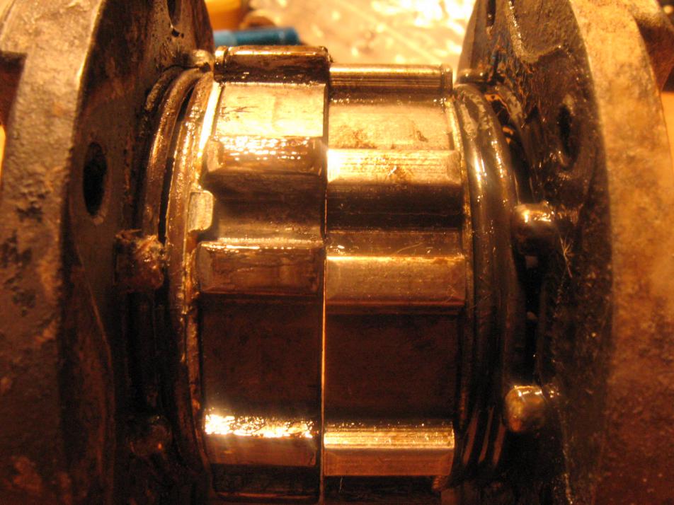

So it should come as no surprise after all this that the day comes for the procedure and things certainly do NOT go smoothly at all.
I took the best looking/feeling pair of hubs I bought out to my folks place in the country. After breakfast I tore down the passenger side wheel, removed the bad auto hub (which wasn't straightforward as one of the torx head screws was stripped and I had to drill the head out to remove the brake assembly!)
Getting the bearings out/cleaned/repacked was no problem even though I never did it before (although I read the procedure over many many times)
Then putting everything back together with the new parts from the WabFab kit, I get to what I THOUGHT would be the easiest part, installing the manual Aisin hubs. I bolted down the hub body and when I went to put the dial on, exactly according to the FSM in the "free" position, it wouldn't be totally "free".....the driveshaft wouldn't turn but there was a clicking sound which made it obvious that the clutch in the hub was touching the axel.
Anyway this just tripped me out. The guy I got the hubs from sold them as working and they were clean and smooth, so I didn't rebuild them. I took the dial off and re-did the whole tension spring/pawl/large spring setup according to the FSM, and still when I put the dial on it wasn't "free".
Also in the FSM, in the section under tearing down/building up the manual hubs it says to check the dial in the body to make sure the bearing in the body moves smoothly in the "free" setting. These didn't do that, either hub. I should have tried this at home, but like I said the guy said they worked....
Anyway after hours of putzing around and blowing my brain about why they didn't work I was losing sunlight and had to get back to Philly for work. I put the hub dial on the body without the clutch and spring so I could at least drive home.
Now when I get back to Philly I have the 2 other Aisin hubs there, which I should have brought for comparison. I tried them in the "free" position....the bearing in the hub body moved smoothly.
I took the dial/clutch off the working ones, put it on the body of the one I was mounting, it worked.
What the hell?
Here's the answer: there are two different size clutches!!!!! The ones I was mounting have a thicker clutch which makes it so you can't totally disengage the hub! Its an obvious difference, see the pic.
Which tells me these hubs I was trying to install, which supposedly worked, could NOT have worked, ever. They must be mismatched? Anyone have an answer for this?
Well at the end of the day my right front driveshaft is now FREE, so I expect my gas mileage to go up.
BUT...........the noise I originally started this post about.....ITS STILL THERE!!
Man, you gotta love this stuff!
PS in the pic the one that works is on the left, I haven't measured but thats quite a difference I think!
MarkAttachment 547
