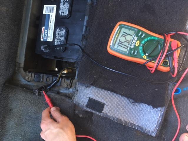

Hey guys! I just joined the proud ranks of Van owners when I bought a 1988 Toyota Van Wagon LE (2WD). The van has a couple of issues that I think I need to figure out (what better way to learn, right?). I’m hoping someone might be able to help me out, though.
When I bought the van, I was told that the battery drains after a day or two (pretty vague) of sitting, which sounds to me like a parasitic drain. I’ve been keeping the battery disconnected when the van is sitting so that it won’t drain, so haven’t really put it to the test yet! When I check the current between the battery ground table and the (-) terminal, though, I get a current reading of ~5A, which I understand is well above normal and means something is drawing current. I plan to look around at some of the posts here about similar problems, but I wanted to pose the question here, since I have a couple of clues that might help narrow it down for this specific case.
First, does the amount of current say anything about what it could be (or isn’t)?
Attachment 5640

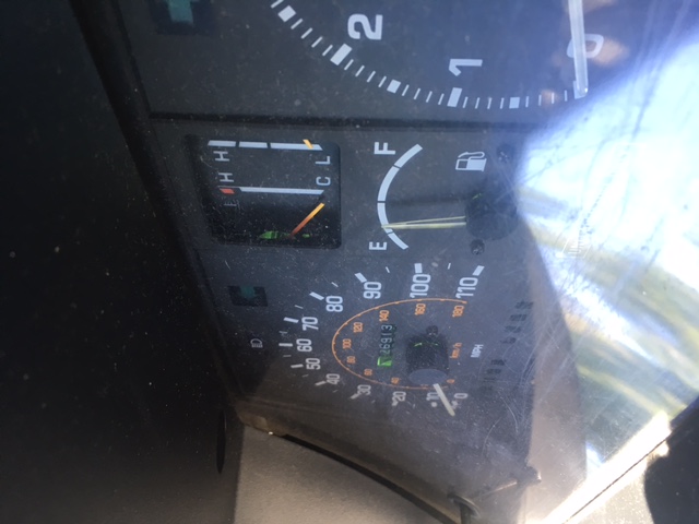

Second clue is that when the battery is connected but the key is out of the ignition, there are some green lights that are on behind the dash (see picture). Does anyone know if this might be it and if so where to start looking for the guilty component?
Attachment 5641

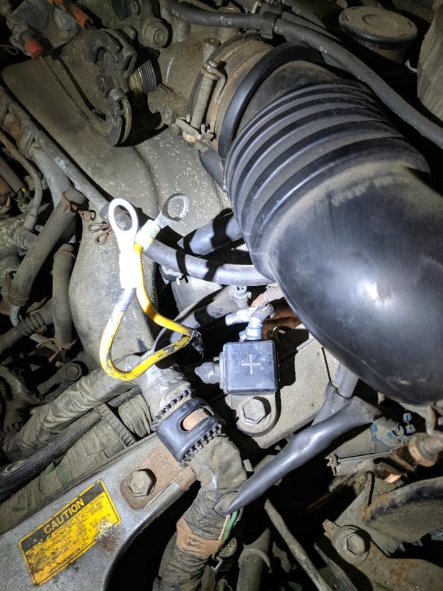

I'm looking for some help on my battery drain. I'm getting a .3A reading, I've gone through the draw test and found that none of the fuses under the dash have an effect, when i disconnect the wires at the + box, reading goes down to .05A so this looks to be the problem. However, when I'm looking at earlier posted pics of the + box I only see two wires connected to it. In my van I have 4 wires connected at the + box. For some reason there are 2 extra wires that are just jumpers straight from the positive battery terminal, the removed yellow wires in the picture below, when i remove these two wires the drain drops. I tried to just leave them disconnected but my van wont start. Anyone have an idea on what might be happening here? Thanks
Attachment 9063
Check your FL 1.25B fusible link that's talked about in this thread: https://www.toyotavantech.com/forum/...le-link-thread. I'm guessing that fusible link is compromised and someone ran those other wires to bypass it. I don't like "hack jobs" so if it were mine I'd remove those yellow wires and repair it proper. This may not solve your slow drain issue, but I'd do that 1st, then check for drains again. If there's still a drain, then go through the procedure outlined previously to try and find it. Tim
