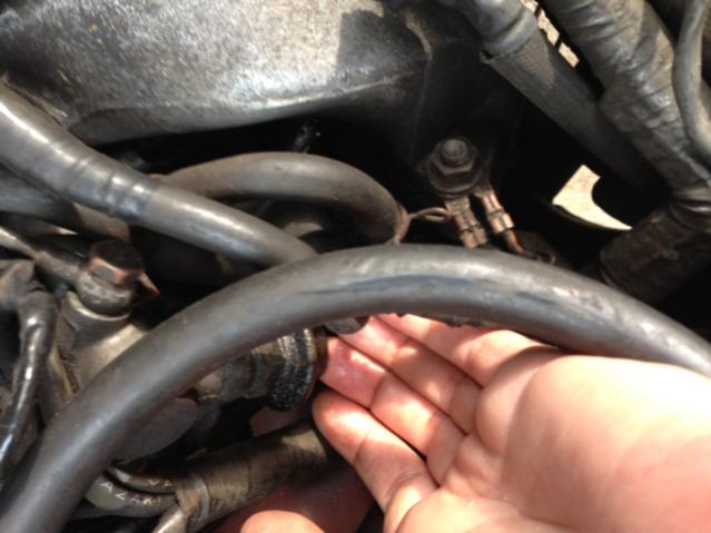

Noticed a bit of fraying on injector 1 connector wire - still hanging on and van runs ok, but looking a bit dicey at best.
Wondering if anyone has documented the specific process Tim outlines in this section of this thread (pic below)?
Ideally I would love to clean that whole area up (spray degreaser?) and replace that wire ( and connector?), but may be best to just leave it alone.
Re: Replacing Fuel Injector(s)
#1 injector connector is the most exposed and the most likely to fail. The good news is it's also the easiest to replace (no need to split the manifold). #2 is a little more difficult, but still accessible enough (forget about #3 & #4). That #1 connector in your picture looks pretty rough. If that were mine I'd at least replace that one.
thanks Tim - very thorough!
I think I'll go for just 1 & 2 connectors for now. Leave the injectors in place and just grab those Denso connectors + pigtails you referenced.
So just unclip (pry?) the connectors off and then pigtail the new connector to the old harness, right?
Any tricks to getting the plastic disconnected from the injector or any other plastic bits on the injector itself that I should be careful of since I am guessing the whole unit will be pretty brittle?
Also - is it OK to just spray some degreaser all over the area so I can see what I am doing? With the distributor is on other side I should be safe (?)
When you get the new connectors you will see the part you pinch to release them. With that knowledge you should be able to just pinch and pull the old ones off. The eBay ones I referenced come with short pigtails of wire. Cut the old wire back a bit from the old connector, strip and attach the new connector. You could use standard butt connectors, but due to the critical nature of these, I highly recommend soldering then protecting with shrink tubing.
Yes, you should be able to spray with an engine degreaser and or other such chemicals. If you use carb cleaner or something harsh, it can damage paint and maybe some plastic parts. I would also check the product for flammable warnings and take appropriate precautions. I personally use Mineral Spirits paint thinner as it cleans well without damaging paint or plastic. After the chemical treatment I use a pressure washer on a low pressure setting to finish the job and flush the flammable thinner off the engine.
After rinsing, if doing the passenger side of the engine, I will usually pull and dry the inside of the distributor & cap with compressed air. A 15 minute drive down the highway after flushing will finish drying the engine and surrounding areas. Tim
