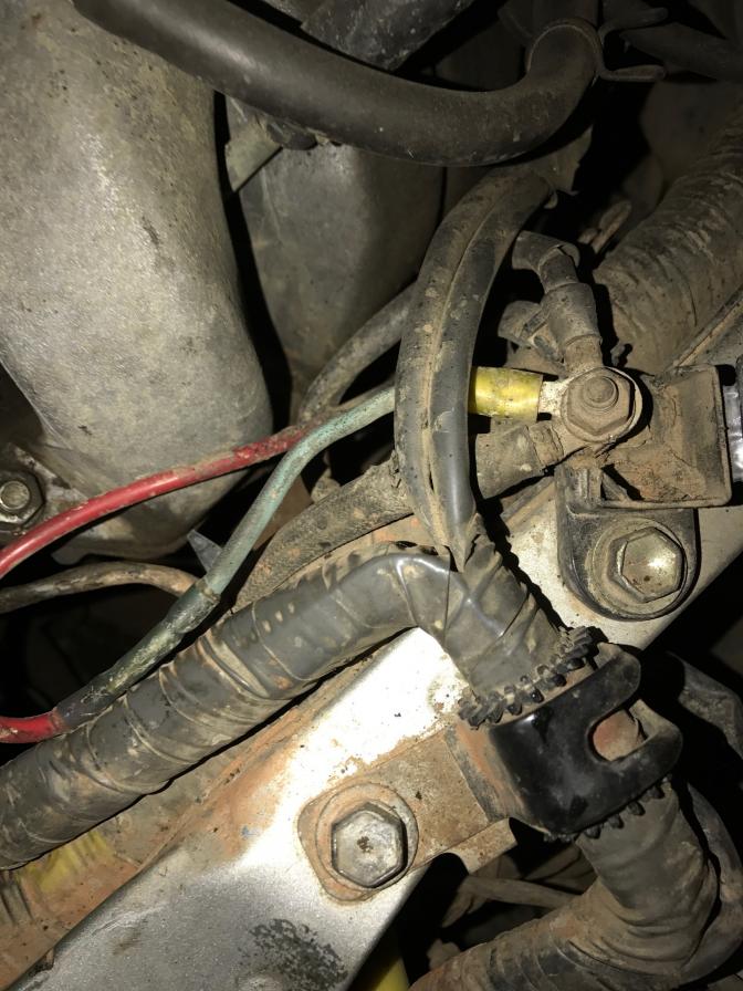

The FL 0.5G fusible link appears to be missing from my battery compartment:
Attachment 5173
I traced the wire and if i followed it right it runs to the + junction box. is that short green section thats been spliced in a fusible link? Should I worry about this or does this look acceptable?
Attachment 5174
There was a 1.5" section of thin solid core wire coming from the harness to my battery (+) where FL 0.5G should be. I put in a weather resistant fuse holder and 15 amp ATO fuse like Tim suggested.

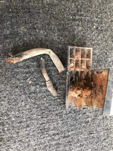

Ok, so mine broke off at the ring terminal. See photo below. However, the van still starts up normal and all electronics seem to work just fine (besides my christmas dash)
Does this mean the FL1.25B has been bypassed? I'd inspect further but I'm not quite sure what to look for. I'm a bit baffled that the van runs as normal with it completely disconnected :cnfsd:
Attachment 5234
I'd have to assume that too as it would be quite a trick to get those circuits powered up "wireless". Fuses, breakers and fusible links are not required.............unless something unexpected happens. If something shorts out, you could end up needing to replace the entire van rather than just a fusible link. Since vehicles burn so hot, it's not uncommon for them to take-out other vehicles and/or structures.
Of course that kind of result would be unlikely, but I'd recommend not tempting old Murphy. Tim
Whenever I repair vehicles with "hacked" wiring, the 1st thing I do is inspect all accessible areas and look for hacks. Factory wiring is neat and clean. Hacks usually stick out like a sore thumb. Whenever a hack is detected, I remove all the "added" wires, then reconnect any cut or damaged factory wiring by observing the color codes. After bypasses and hacks are put back to original configuration I'll then test and troubleshoot to find, and then repair the original problem in a proper way.
In this case you already know the FL1.25B is the issue, so that should make the last part easy. I would assume the hack to be a larger gauge wire (probably 8 or 6 gauge) because anything smaller would likely not have been able to last this long. When looking for the hack, I'd start out checking the battery for an extra wire on the positive terminal. If there's one there, follow it to the other end and remove. If I had to guess, I'd suspect they ran a wire from the batt + to the + box next to the Air Flow meter (where the alternator output wire hooks into the system). Good luck. Tim
I just went back and looked at your pics (earlier this thread) and see an extra wire at the + box (there should only be 2 wires here).
Yeah, I'm at work at the moment, but if i remember correctly i traced that red wire back to the postiive terminal on the battery....ill have to double check (where the FL0.5G was missing - see photo from earlier in the thread) i assume that green section of wire spliced into that red wire from the + junction is a fusible link wire to replace the missing FL0.5G...?

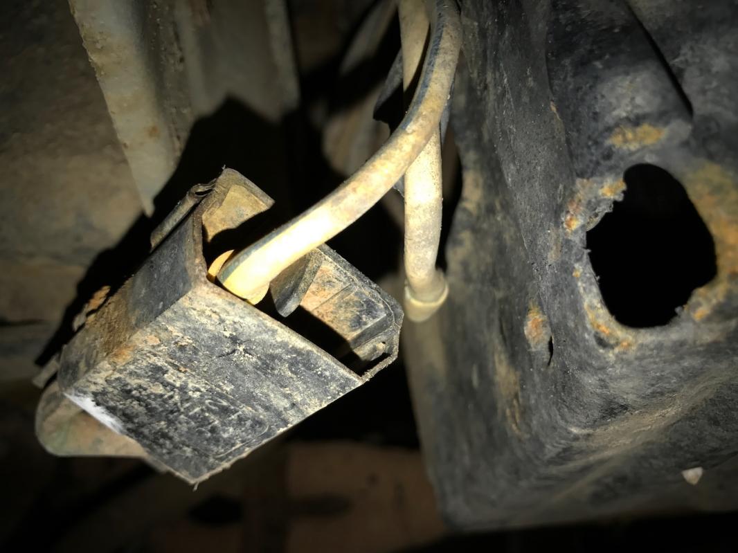

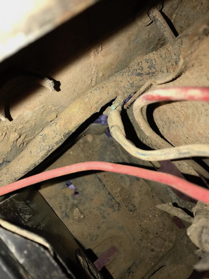

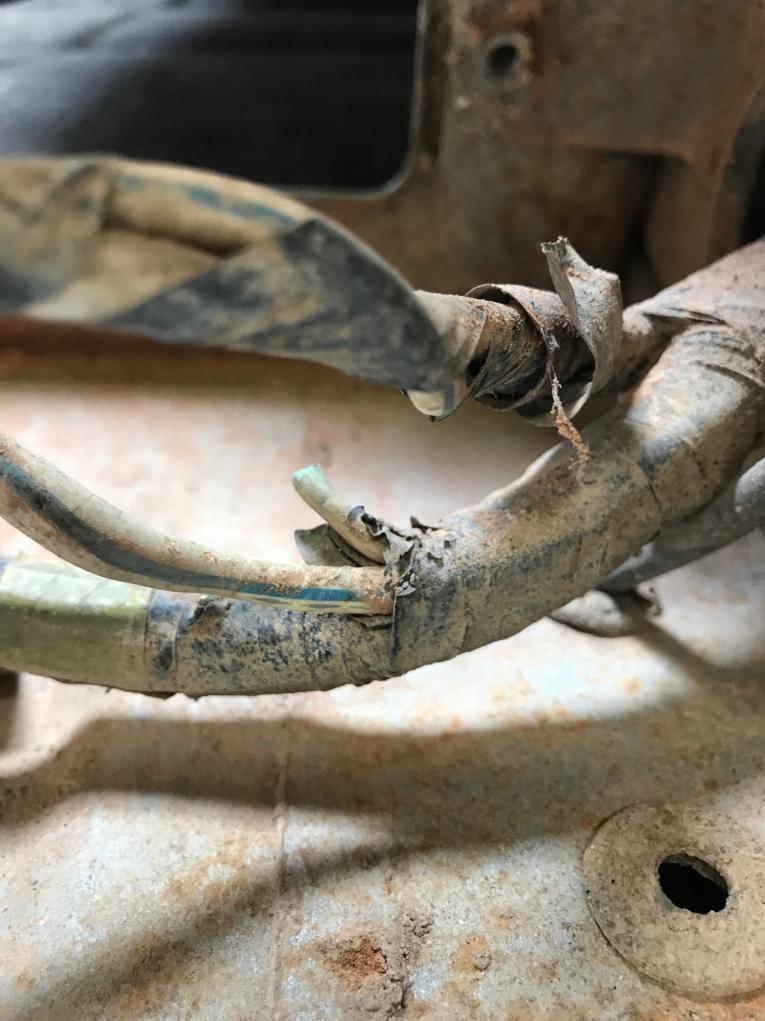

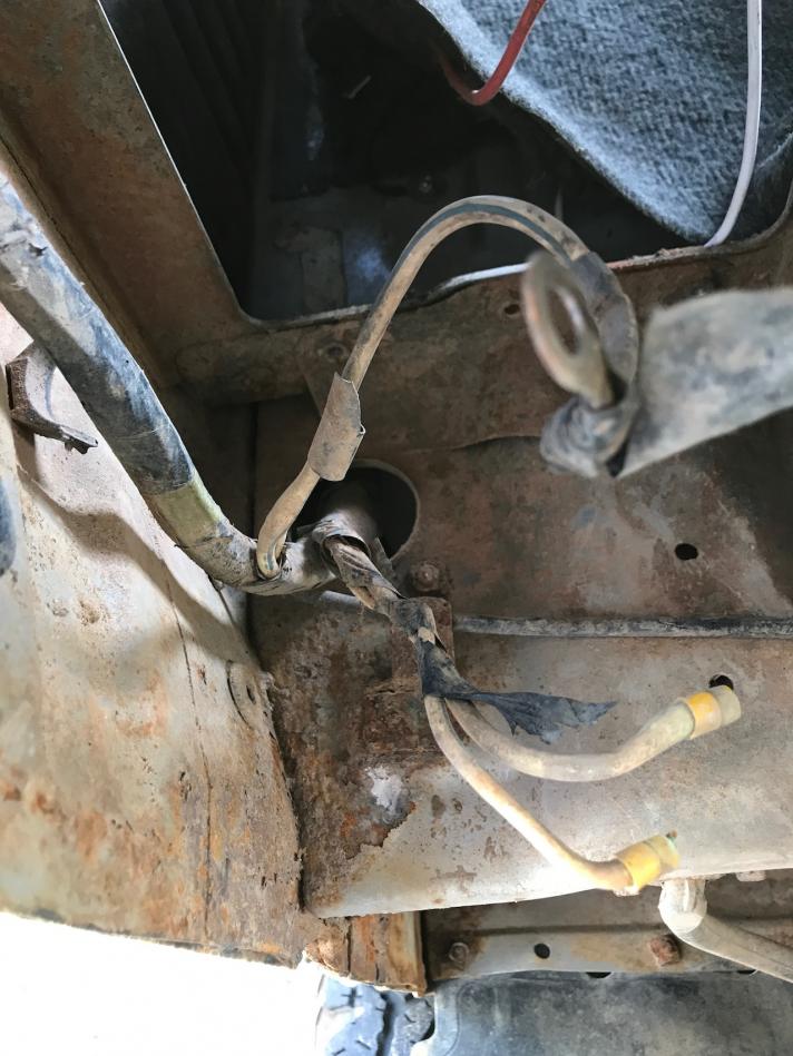

Ok, pulled out the battery and battery tray to get a better idea of whats going on. The two wrapped white/blue wires were running to the fusible link which was totally toast, the third white blue wire was running to the positive battery terminal, and the red wire (top of photo 2) was coming from the + junction next to the engine to the positive battery terminal. See attached photos. Hopefully I can fix this situation and it will also resolve my christmas dash :)
If anyone knows the wiring and can explain what the PO did here and what steps to fix it proper I'd be super grateful. Im a total noob when it comes to wiring/electrical.
