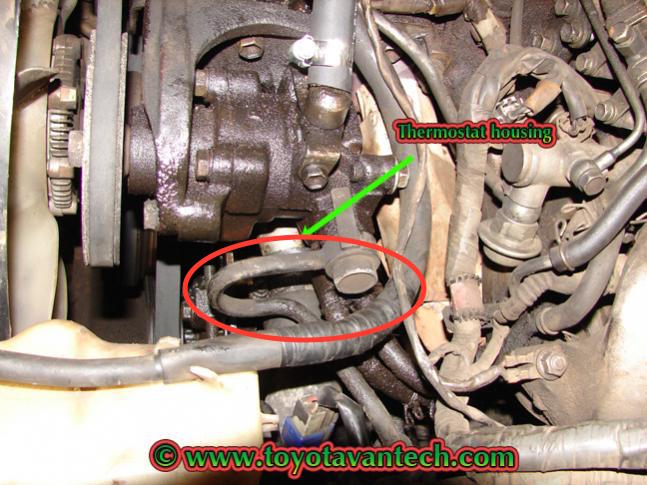

Are most of the pics in the thermostat replacement guide of the 4WD? I suspect that this is a picture of the 2WD, because I'm working on a 2WD and I think I have to remove the part circled in red here:
Attachment 9248
in order to remove the tstat housing.That hard line leading from the power steering pump is in the way on the 2WD, so I should probably... drain the PS pump and remove it to get access to the tstat? Or ought I be able to remove the housing with that line still in place?

Toyota has at least 3 different versions of that PS hose (2wd & 4wd), so there's always going to be a variable there. I still don't think you need to remove it though. If you pull the coolant recovery tank there should be enough room to access the T-Stat. Removing that PS line would be nice regarding T-stat access, but maybe not worth the mess and/or the risk of creating a leak there.
BTW, the recovery tank is removed by simply pulling up on it. It can get stuck pretty tight, but if you wiggle it back and forth while maintaining a constant upward force it will pop-off the mounting bracket. Tim

Thanks, Tim! I managed to get the thermostat housing off without any PS disassembly. There was just enough room in the elbow of the power steering line to get the bolts off, one. click. of. the. ratchet. at a time. I also discovered that I really, really need 2-inch and 4-inch extensions to go with my 3-inch extension, if I hope to get it back on.

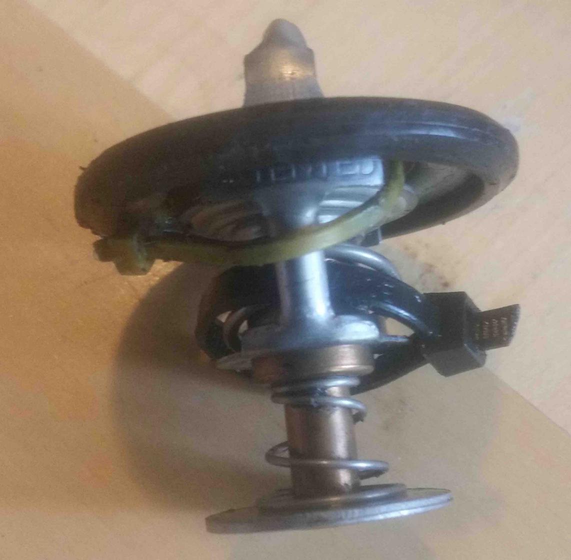

Also, I heeded y'all's warning and bought OEM replacement parts. Check out what I found inside:
Attachment 9249
Obviously the previous owner didn't understand the importance of using... OEM zipties. :dizzy:

LOL, he obviously had more knowledge than the engineers who designed it. Hopefully there's no duct tape or bailing wire elsewhere in the system :rol:

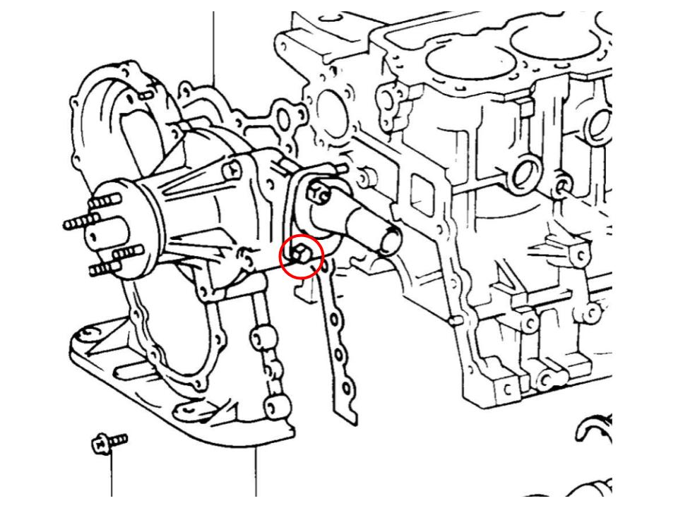

Can anyone tell me about the bolt circled in this image? I was changing out the thermostat in my 86 cargo van today, and I mistakenly removed it instead of one of the nuts for the thermostat housing. Luckily I had removed the alternator, so it didn't get doused in coolant.
Did I really screw up here, or can I just tighten the bolt back down and be on my merry way?
I'm also doing the water pump and fan clutch while I'm in there.
Attachment 10123
Re: Replacing your van's thermostat
That's an adapter plate of sorts that transitions between the timing cover and the t-stat housing. Just taking the bolt out then putting it back in shouldn't cause a problem. I would however recommend you keep an eye on it when you do your initial start-up/warm-up to make sure it's not leaking. Tim
