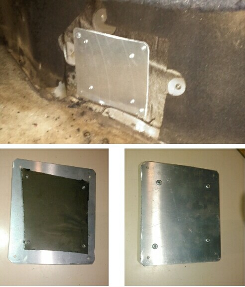

I vaguely remember dealing with that years ago before cutting the access hole (as pictured earlier in this thread). Hasn't been an issue since. Did you cut an access hole?

The second go around to correct the leaking bypass pipe I brazed the holes with an oxyacetylene torch and brass, then I bolted it onto the throttle body/manifold, and after that I installed the manifold. The last thing I ended up doing was connect the hoses (without the access hole) and everything is sealed up tight now for 2 weeks.

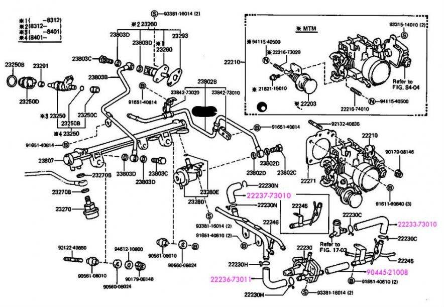

the pre-formed hoses on the underside of the intake (part numbers in purple) are all NLA.
Attachment 5468
I have some hose the same size but it kinks when I try to bend it at that angle. I was able to replace the one small straight piece obviously, but the bent pieces kink pretty bad.
is there a way to form it to the proper shape? or maybe use a different type of hose material thats more flexible?
Re: The hose of death thread
That really sucks............I was wondering when that was going to happen. Those are all vacuum hoses with ~1/2" ID (to direct air through the Auxiliary Air Valve). The only thing that comes to mind is to find some 1/2" ID formed heater hose with tight bends, then cut parts out of it to match what you need. When I get in a spot like that I ask the guys at my local Napa to let me look through their inventory. There's also some weird shapes and bends available at the Dorman HELP! rack.
Then there's brass nipple elbows pushed onto straight hose. Another option is Unicoils. Gates makes devices called "Unicoils" that you put over straight hoses. You get one that fits the OD of the hose, then you can bend sharply and it prevents kinking. They work, but I'm not crazy about them as they make the hoses heavy and clunky. As these vans get older and parts get harder to find, I suspect there will be a lot more of this type thing we're forced to do to keep them on the road. Good luck. Tim

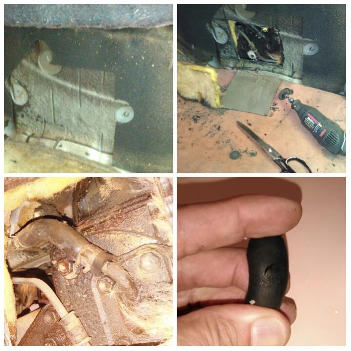

The other day after driving the van on some morning errands I noticed some smoke coming out from underneath the driver side of the van, I opened the door and could hear a drip and burn off with smoke, because of where it was located I thought for sure it was the Hose of Death!!
Contacted my MasterTech and informed him of what was happening and the following day Sunday afternoon I drove it over to his house for a quick diagnosis. He jacked up the van and rolled under with the creeper for inspection and found not only that the Heater circulation molded hose was dripping but the Hose Of Death had developed elephantitis (fully expanded) unfortunately I couldn’t get a picture of that from laying on the creeper.
Thank you Tim for documenting this thread, I sent him the link for review as an easier option for the repair and he loved it.

Hose of Death ready to blow
https://i.imgur.com/sZBCgJQ.jpg
https://i.imgur.com/4m8PPUe.jpg
Cut access hole and replace with the Gates Heater Hose, new clamps, heater foil wrap and seal back up
