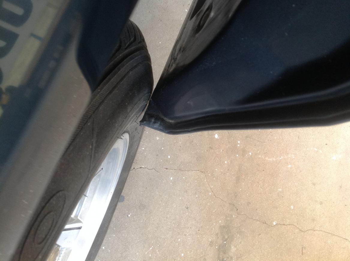

Yes, KUMHO. Its the max the sliding door will let you get away with: 2 millimeters gap
Attachment 8458
Re: Urgent need for advice on space van wheels (OEM and alternate rims)
Thank you. My Hankook Optimas in 205/70 R 14 are on the way. We will see if they are skinnier or fatter.

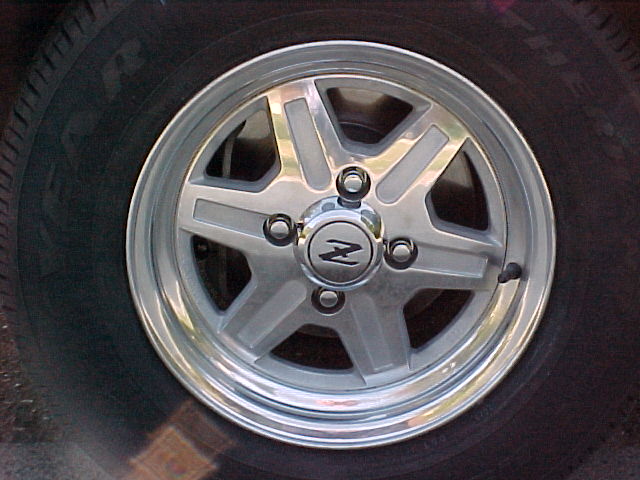

I had a set of 1981 280ZX 6 spoke alloys on my 87 2WD Cargo. They worked great with the standard sized 195 75R14 tires. Think they were 6" wide with +12 offset and a 70ish mm center bore.
I'll try to find a picture and post it of my old van. They looked really sharp!
They looked like this.
Attachment 8548
Yummy!!!!
Gorgeous Wheels! Nice deep dish. Crisp, simple lines. Should match the van very well. Pics please:drool:

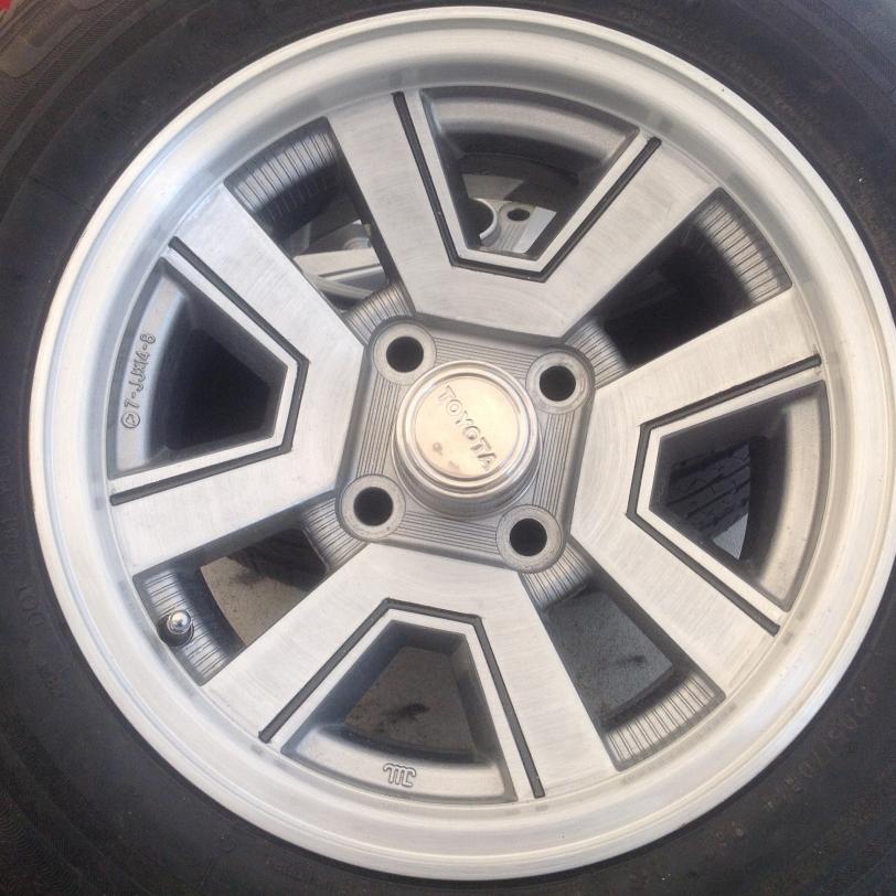

Wonder if the old stainless steel Toyota center cap would fit?
Attachment 8549
or the vintage one with the"T" alone. If I remember well the center bore on the 2WD is 67 m/m. I could be wrong.

Hankook Optimo (H724) P205/70R-14 on baby supra wheels rubbed when steering hard in reverse, and barely cleared rear sliding door. mine was an 85 van. 2 wd 5 spd
Kombi
Attachment 9647
I’m running H724 195/75R-14 and they ride great and don’t rub
