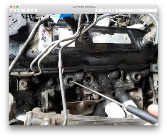

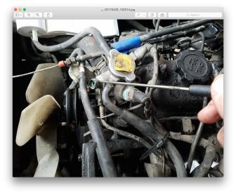

Hi -
I have a bunch of stuff under the hood dismantled, trying to address issues with the fuel injectors and power steering leaks -- I am also trying to fix anything odd that I come across while I have such good access, but my knowledge is a bit limited. Hoping someone can help me identify 2 spots:
Attachment 5282
I am assuming this is some kind of coolant temp sensor? There was nothing attached to it and it was caked full of a dried silicone type substance.
Attachment 5283
In pictures of Tim's nice clean engine these holes have bolts in them. What do these holes do?
Thanks for any guidance.

BigDawgGottaEat
Attachment 5283
What? No bolts here in any of my engines. Not sure why these holes are here, but they serve no purpose that I know of. Here's a view of this area on my 86 van:
http://i8.photobucket.com/albums/a23...ps9957cd3a.jpg
That "sensor" is worthless anyhow and IMO you're better off the single wire that goes there is grounded out. It's actually a temperature switch that only activates when the coolant temperature reaches 230° F. It's talked about in the "HEAT SOAK" thread. If you find the wire that's supposed to go there, simply ground it out (perhaps a previous owner already did). Attaching that wire to a ground point will improve your van's ability to combat heat soak issues. Tim
