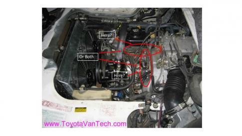

As my 86 LE is being finished up and now will live and operate in Florida, my concern about Hot Soak has escalated.
With that in mind and April coming around the corner when temps here will really begin to climb I am making ready for a serious Hot Soak issue with my LE.
That being said and studying your detailed response with extra cooling added to the van for after engine off conditions gave me some thoughts.
This is quite a project and if needed I can do it but I thought of something else.
In your opinion, can an external air source (fan) drive air directly to the suspect area that is the cause for Hot Soak.
A similar model is used in piston aircraft by way of external electric fans moving lots of air through a Scat hose to the location in need for the extra amount of air. So my thought is to follow that model and add an external 12 volt squirrel cage fan located low under the ower steering reservoir and pumping air up into the fuel line area. I took your picture and guessed where the suspect area is.
This would eliminate the need to pull the fan out and build up the necessary mounts for the 2 new fans.
It can run on the same type of thermostat as you demonstrated here.
Any thoughts, or suggestions?

The fan set-up I'm using in post #34 is my daily driver and works well (doesn't require removing stock fan and/or building a shroud). I don't doubt your idea will work, it's just already cluttered in there. If you do that, try to direct the air to flow between the halves of the intake manifold (where the fuel rail and the injectors are). I'm always interested in new/different ways to solve problems, so if you go that way please keep us updated as to how it works out. Tim
I posted this on the subject; http://www.toyotavantech.com/forum/s...ll=1#post31776 The thing I'm still questioning is: Do I blow fresh air in or do I pump hot air out? Witch way would be the most efficient? hummm....?
If we're talking about a small but directed airflow, I would think pumping cool fresh air in would be more effective. If you move air out, that would do the same thing, but would initially be drawing air from other heated areas, thus reducing short term effectiveness (at least in the specific area of the fuel rail). Tim
I was able to at least experiment with that. For sure blow in, not out. You will pull heat off the block first and will take some time to cool. By pushing, the block will not cool down any quicker but the suspected fuel line area will get the cool relief.

Somehow in my head I keep seeing hot air relentlessly radiating upward from the mass of metal under the fuel rail and both ways at some point are making sense. It seems that, according to MyToy, aeronautic engineers prefer blowing in cool air, but fan makers clame more efficiency in extracting hot air :cnfsd: so the little voice keeps telling me: That hot air "pocket" has nowhere to go, if you take it away, cooler air will be drawn in its place, same as inside a paint spray booth or a sand blaster tank No? The contained environment makes it difficult to push things out. Interesting.....
With a bilge fan set up it would not be hard to figure out, flip the fan around and mesure temp drop directly on the fuel rail
All good points and must be considered. There is however one other area that needs to be considered also. That is the level of sinking the heat (retaining it) within each component. Since we only need to reduce this temperature for short time period the time it takes to cool down the fuel components, ie fuel lines and such, are much smaller than the entire block of the engine. You are correct if we were planning on cooling the entire block, which would take 10 years with a push or a pull fan. But no, we only need a few minutes of cooling. The sinking power of the block verses fuel components is quite substantial. By blowing (pushing) cooler air hits these components at the same time, yet the fuel components will be effected the fastest and that is what is needed under these conditions. Early experiments somewhat proved this however until it is physically implemented anything can happen. Although heat rises, we are blowing so much cooler air over these components, we only need a small amount to satisfy the vapor lock. The right way to do this is with a temperature sensor on the fuel lines themselves set to some pre-deterimined temperature. This can be done digitally along with some timing numbers as per what Tim mentions on power up and power off. Here is where software is a good thing and can be done very accurately. After the initial tests, then measurements would have to be made to determine the correct numbers. Then it is the task of writing code that can satisfy it.
Not easy in the electronics but may be less disturbance to the engine area mechanically for the install.
Just some thoughts. Another month before my LE gets out of body and paint. Will start that process when she comes home.
