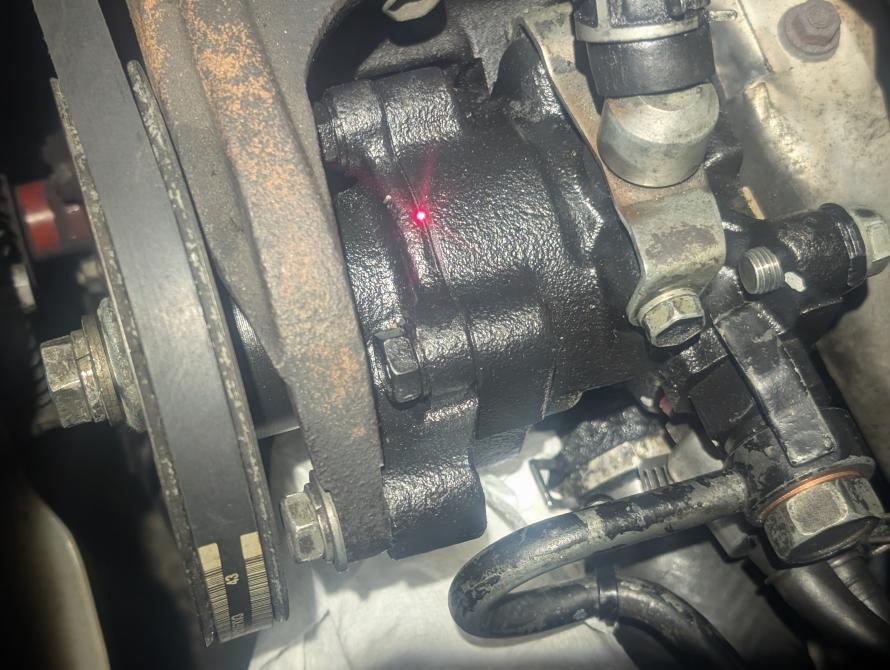

Hey guys my pump is leaking at the red line (picture taken from tim) im assuming thats the a gasket. Does anyone know the part number. I have a PS seal kit but it doesn't have a gasket. Good news is it only leaks when driving. Would you guys recommend a stopleak or cutting my own gasket? thanks! [ATTACH]11080
The large o-ring in the kit goes there. Tim posted a PDF of the pump rebuild from the service manual earlier in this thread that explains how to disassemble and rebuild if you need it.

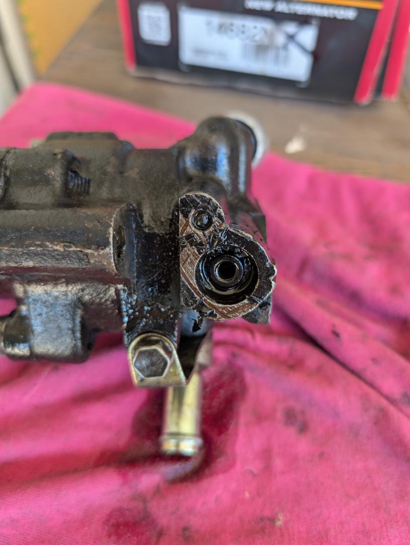

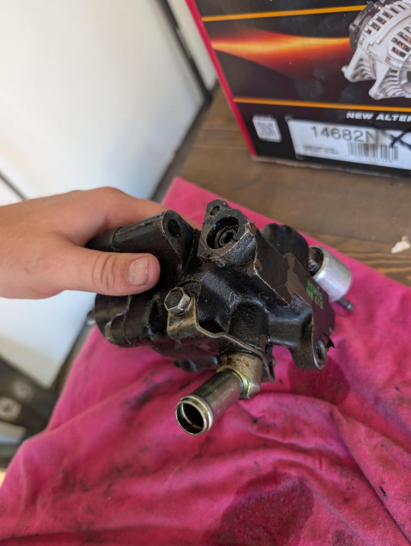

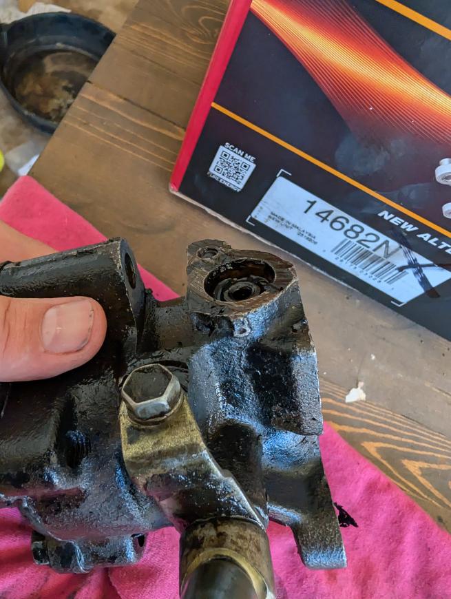

Looks like these pumps are no longer reman'd so I'm rebuilding mine. It leaks fairly bad out of the high pressure valve port. The port that has a B over it. I'm curious, the center of the valve is threaded, is that meant for a bolt or plug or something? Pics to help..
