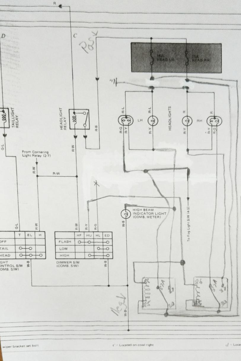

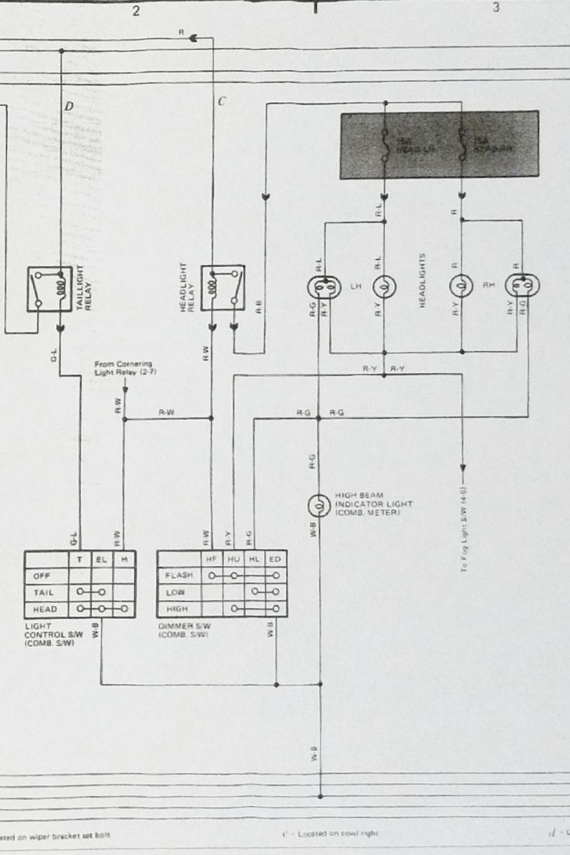

Sure thing. I just threw this together from memory.
Here is the factory schematic:
Attachment 8044
Here is what I did to modify the factory wiring to make the LEDs work correctly:
Attachment 8045
The access points I used to wire everything were at the grommets behind the headlight buckets (by driver and passenger feet), and the plug that comes out of the steering column.Once I got it all figured out the actual wiring portion was very simple.
This is obviously not plug an play. You will also need to re-pin the headlight plugs to match the LEDs as well.
