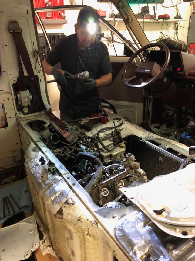

It's open!! Sent the injectors to doc injectors out of sacramento. Owner said his son has a toyota van so I think it's in good hands. Replacing all the gaskets besides the head gasket with Fel pro and the head gasket is toyota. Replacing hoses, coolant and vacuum. TPS getting replaced as well as bi valve. Valves are getting tested for leaks and the head is being refurbed. Will update when job is done to let you guys know if it fixed the overheating issue I was having.
By the way, that's my friendly toyota mechanic, also a toyota van owner and not me. I'm too wimp and don't have the space to pull this job off.
