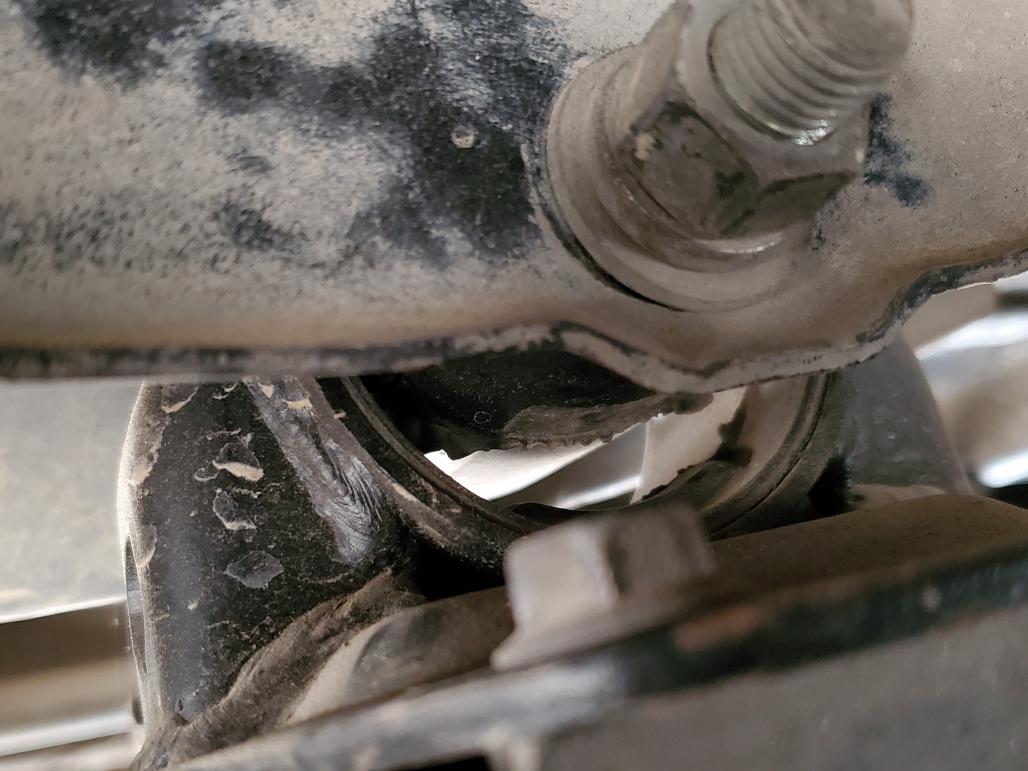

Ok I think you're right. Here's a better pic
Attachment 12235
