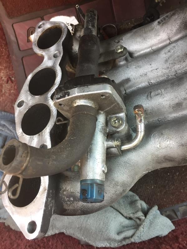

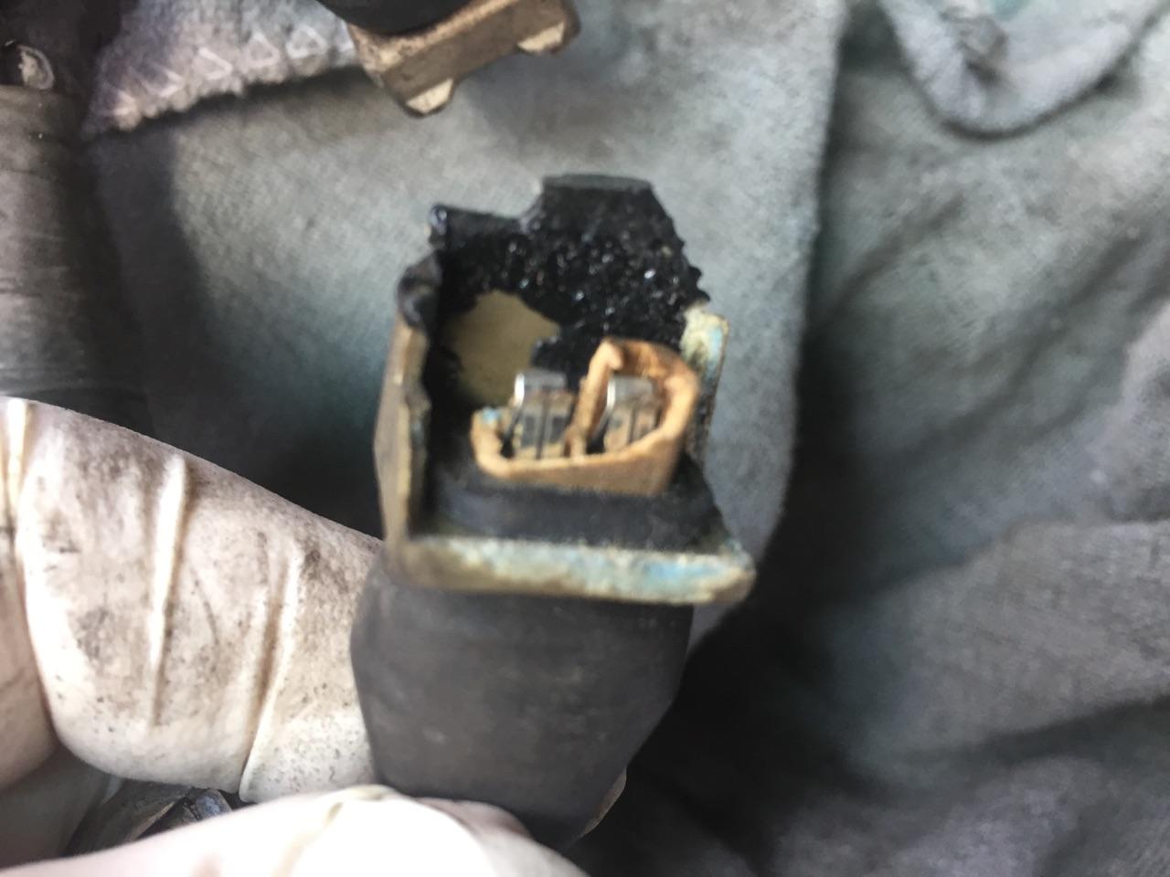

This is one of those stupid things you swear you can find, but then you get stuck on something. My mechanic has been doing quite a bit of work on my engine. Recently did a head gasket repair and when put back together realized engine was running rough. Since engine hasn't run in quite some time, he concluded that he thinks the problem is the fuel injectors, but upon working on them, all the injector connectors were deteriorating. Also he said the cold start injector connector and the IAC valve connector were deteriorated, and we have found pretty much every connector except for the IAC valve. Would any of you happen to know where I can find one? I've looked around Rockauto.com which has a pretty good selection of parts, but alas, no IAC valve connector. Or would anyone happen to know if these connectors were used on other Toyotas and/or different years and models? Even if someone has a picture of this thing, that would be very helpful. After this thing is done being worked on, I'm going to sell it, so stay on the lookout for a upcoming posting for an 1985 Toyota van that's had a ton of work done to it. Thanks for reading, all, and good luck.

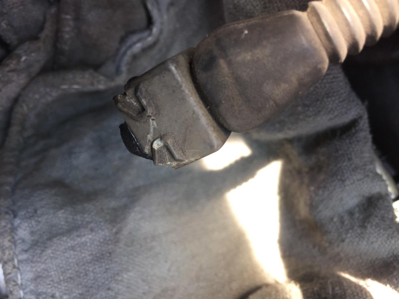

My mechanic also just sent me these pictures. This is what we're working with.
Attachment 5574
Attachment 5575
Attachment 5576

I had that same issue, and ended up replacing this and all the connectors under the hood.
For a lot of them — and I believe this one you are after is included — you can use this connector available from Parts Geek: http://www.partsgeek.com/catalog/198...connector.html
They also stock them at O'Reilly Auto Parts, but I'm not at the shop where I have the part number handy.
If you look closely at the enlarged view of the photo, you'll see there is a notch in the plastic connector. For the coolant sensor it is in the center. For some of the other things that use it, like the IAC, the notch may be in a different spot. Since this was the only connector available that I could find and that was the only difference, I just made my own notch where needed to make it work. Hope that helps.
And if you need it, here is the TPS connector, which is a little different. http://www.partsgeek.com/catalog/198...connector.html

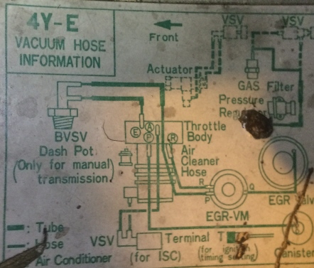

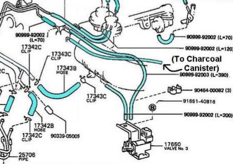

There are 2 ways that the ISC VSV is shown to be plumbed...
the diagram we're all familiar with is as follows ...Attachment 6557
here, the rear port goes to the throttle body
Now, for the other way...Attachment 6558
here, my vacuum sticker ('87 2wd/auto/) clearly shows that the FRONT port goes to the throttle body---
if I'm not mistaken, this is a "one-way" valve, so, hooking it up backwards could be an issue...
for what it's worth, this valve's solenoid clearly clicks when my van is warmed up and i rev the throttle ...and my vacuum gauge shows "closed initially" , and, "open after solenoid click" (this is with the vacuum gauge hooked up to the rear/inboard port which leads to the big intake hose) ...
so..., obviously since the valve is receiving a constant vacuum pull at the hose from the throttle-body, I plumbed it as my sticker shows (on the front/outboard port)---
(I don't think it can go either direction like a BVSV)
I just want to know what's the right setup
