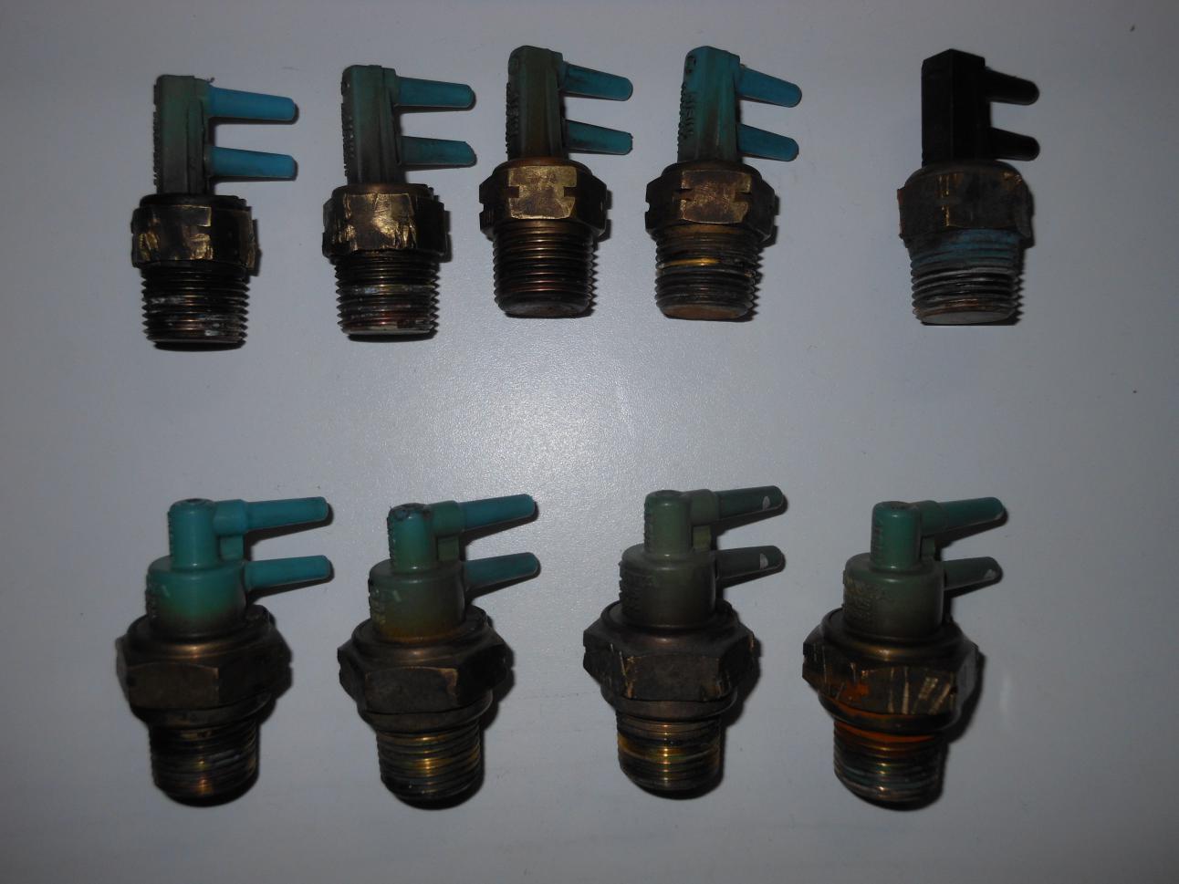

Well I couldn't get to the wreckers till today and I would have to say I'm rather satified with what I was able to find.
Attachment 673
If these are kinda dark, I can photo them in the day time and they should be better. Anyways, this is what I got in two large yards. BTW, they had very few TVs, saw more Mitsubishi vans than TV. Go figure!
The first row is of the proper part, 90925-05017. The last one is of some aftermarket part with no part number on it. The second row is of 90925-05068 part that I was going to use if I couldn't find the correct ones. The 90925-05017 ones were almost all found in a few '89 Toyota Camery. The very first two were a B***H to get off. I had to resort to using vise-grips to get them off. Number 3 and 4 is what I'll use. The others I'll just have as needed.
Little on part finding these. OK the ones on the bottom row you'll pretty much find them all day. The "correct ones" take a little more time finding them, but you can. They were all located in pretty much the same area. Driver's side of the engine compartment and in the top area. If you have a 19mm open end wrench, use that. A crescent wrench is doable but it can be done. Some just don't want to come out! They are pretty much solid but can break. Saw alot that were broken from others wrenching on the car. Some that the car was fairly striped and was easy to get to.
All in all beats the hell out of paying $40-60 on one of these!
The bottom row valve takes a 24mm.

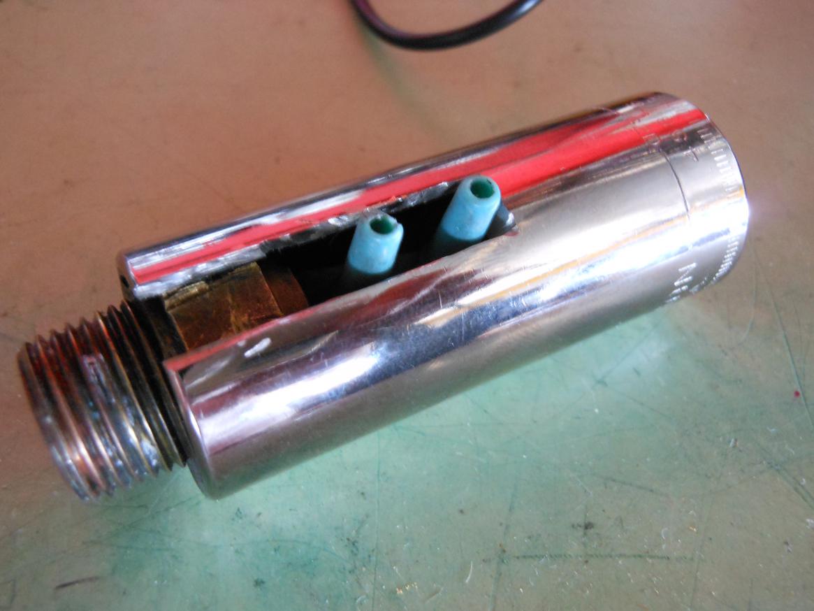

Lol, looks like you got a lifetime supply there. The van is pretty hard on plastic parts (at least in the engine compartment). I'm guessing the Camry ones still have lots of life left. 1st time I had to remove one of these I smashed it with a hammer then removed the base with a regular socket (what the hell, it was already broken :lol:). Putting the new one in was a slight PITA due to the fuel line right there so I cut a slot out of a thick-wall deep socket and used that. I replace these things every so often (in different vans) so the socket gets used semi-regularly. here's a picture:
http://i8.photobucket.com/albums/a23...r/IMG_9730.jpg
wwoooo doggie!!!! Cutting up a Craftman deep socket just for dealing with this part huh? Think I'm going to look at ebay or try some kind of cheapo tool store. I value my Craftmans.

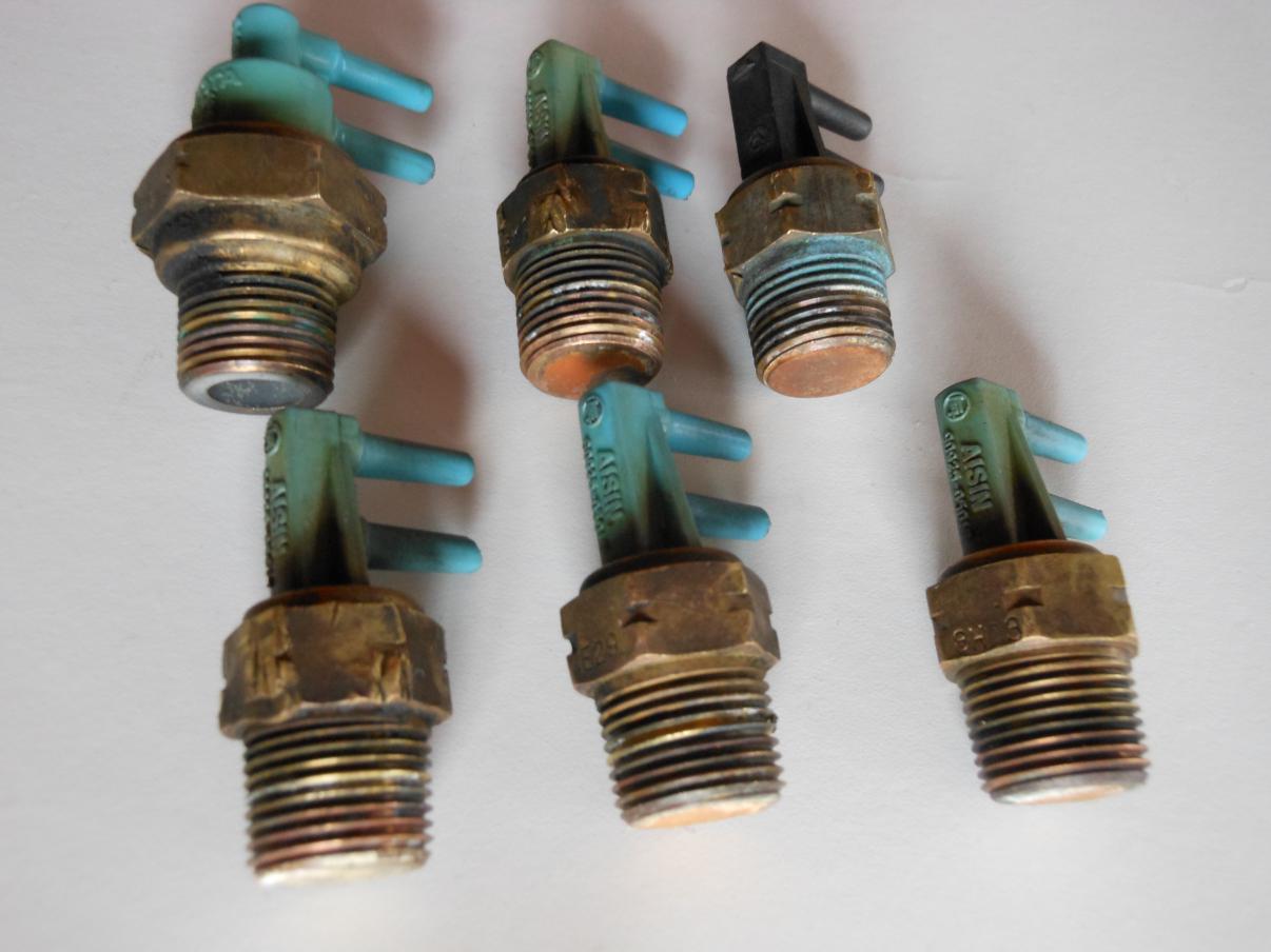

Getting back to these valves. Looks like these things are just passed over by everyone pulling parts. I saw very few that were pulled from the manifolds. They were pretty much always left. Some even had everything pulled from the engine. After finding one I was able to spots these easily too. Just had to spot the 80's Toyotas.
One more pic for good measures,
Attachment 679
I ended up getting a Craftsman socket. I didn't want to do stuff twice, so went with the Craftsman. It went against my restitution to destroy a perfect socket that I could have added to my collection, but what the heck.
Attachment 686
What kind of tool did you guys use to cut the slot in those sockets?
I used a dremel and one disposable cutting disc. I was under the impression that it was going to be a b***h to cut this, but I was abit underwhelmed with the hardest of the metal.
BTW, I'm gona use this dremel for cutting my assess to the hose of death. This thing just doesn't die! All the cooling fins are busted off and it runs like NO BIGGY!
I used a die grinder and a cut-off wheel for the long cuts. I switched to a dremel with a worn cut-off wheel for the short cut. I held it close to my chest while cutting, then noticed my shirt was smoldering when I finished :lol:. I ended up with an extra button hole in that shirt. :)
User1, that's a thin-wall socket.............not sure how well it will do if you run into a tight one to remove. Tim
It just needs to survive long enough to get the good one on my van. I guess it would be saved for if I ever have to deal with this valve again. As far as taking them off on the van, I'll do what you did and use a good 19mm socket. As far as taking them off at the wreckers, I'll use what I was doing.
