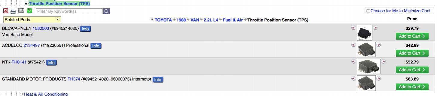

Here's whats listed for TPS units on Rock Auto. Anyone have any preferences??

The Beck-Arnley and then follow the instructions from Tim about how to use the volt meter on the resistance setting to fine tune.

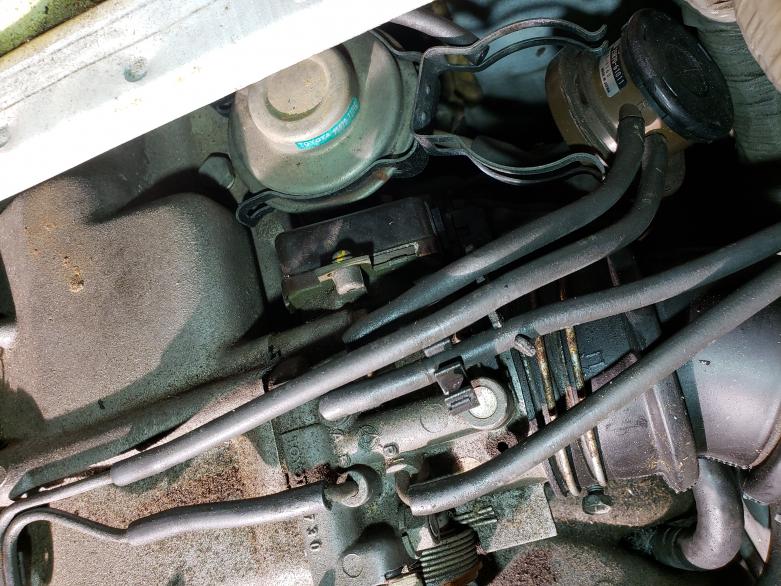

Welp even with the hood off this is impossible...I guess I should just order a gasket and then take the throttle body off. Also is there a tutorial on getting rid of all the unnecessary vacuum lines and canisters? I don't need to pass emmissons for this van where I live.

Re: Article: Cleaning the Throttle Body
OH crap, I thought you may have found a short cut for me. Looks mine will have to come off if adjustment is necessary.

Also I missed the "semi-attached" part of the post before :/
You are gonna just have to take it off I think... really not a biggy. AND, you can hose the thing down with some intake cleaner, clean all those vac line pesky passages that may be gummed up.
Also it's ten times easier to adjust the tps with it out of the engine compartment.
