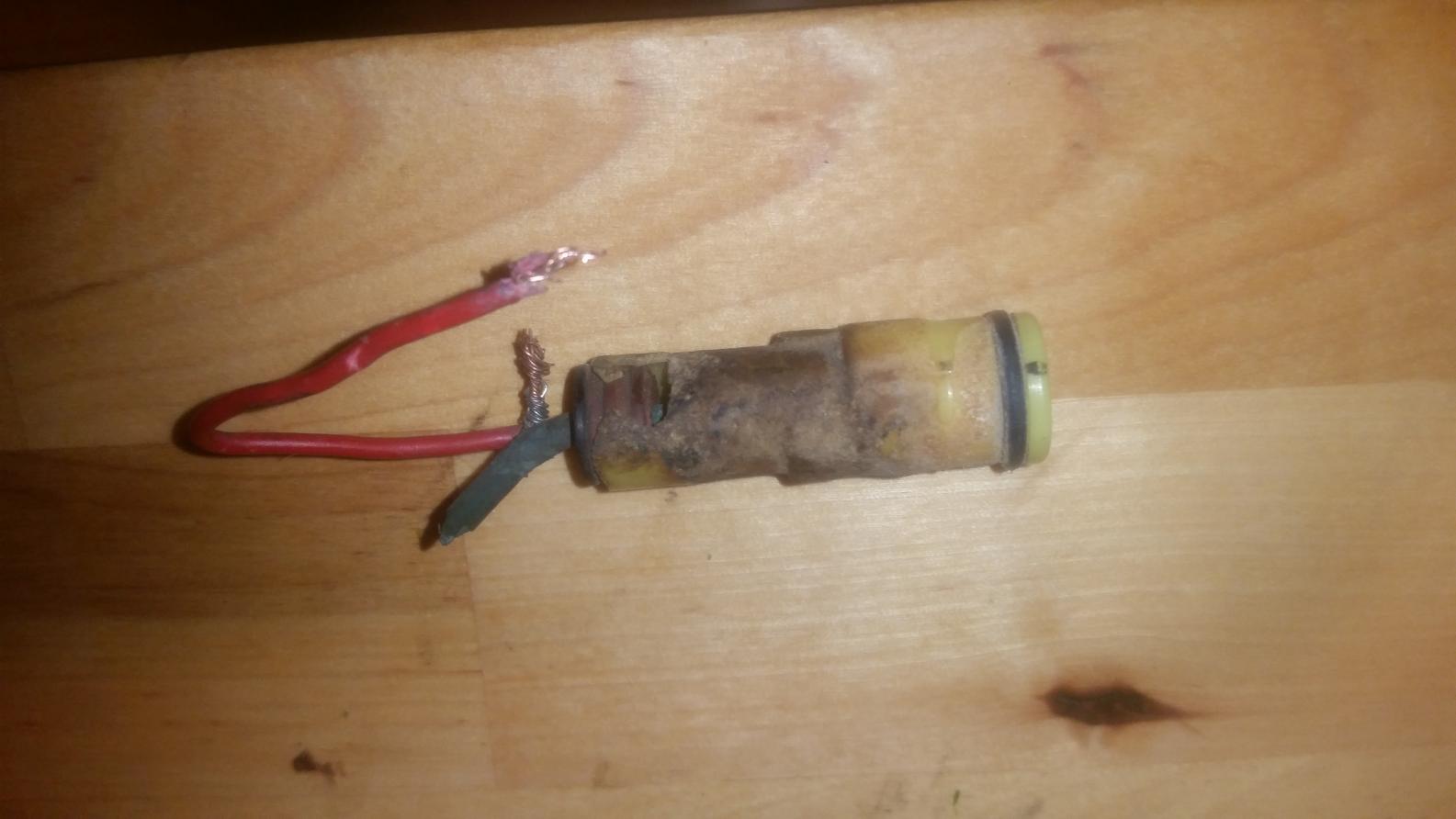

So my van is stranded with some wiring issue. Someone replaced the fusable link that’s in the alternator circuit with a inline fuse holder and a 40 amp fuse. The van keeps blowing that fuse after the van gets above 1500rpm. The van will idle for a long time with no issue just once you put load of rev the engine it will blow the fuse and I lose all power, but the engine is still able to run/drive. I haven’t found out how big of a fuse it melt but it melted 16ga wire that I tried to jumper the fuse to get the van home. This 40aml fuse has been working great for thousands and thousands of miles, and for months and months I’ve had no electrical issues. Totally unrelated but I just got done replacing rotors, calipers, wheel bearings and the car sat for 2 weeks but I have no idea how that caused any problem related to this.
I don’t have a volt meter on me to test anything. Could my alternator finally be dead?
Your alternator is capable of producing 70amps. If your van has sat a few weeks, the battery may be low and asking for more amperage to recharge. When you rev the engine the alternator is putting out more amperage than the fuse can handle. I believe the ampacity rating of 16 gauge is maybe 10amps. So, the big question before you try putting a 70amp fuse in that holder is, "What gauge is your charge wire?".
do you get a charge light with key on not running? maybe youve gone full field on the charging circuit from a bad regulator or fusible link...
This makes a lot of sense. The only part of the wiring that has been altered in the charging circuit is where the fuse holder has been added. So it is all factory wires until the fuse holder which looks to be around 10 gauge, the factory wires that were spliced are about the same gauge and definitely not “battery cable” thickness. I can get a picture of the wires in question. I need to replace that fuse holder anyways since the holder got fried.
Most quality auto parts stores will fusible link wire and ring terminals and you could rig up the equivalent of the factory piece.
Fuses and fusible link do not operate the same way, fuses blow, links slowly melt under excessive amperage.
I'd want to recreate the factory wiring then see if you really have a problem and if so, diagnose it accordingly.
From the Fusible Link Thread, as per Tim
"The "B" in the 1.25B relates to the diameter of the fuse wire. The bigger the wire, the more current it can handle before it blows. I don't have a conversion chart handy, but I'm estimating that 1.25B is equivalent to about 80A. You'd think by the mid 80's Toyota would have been labeling everything in amps &/or using conventional breakers / fuses."
Clearly, a 40Amp fuse isn't going to cut the mustard!
Would you believe that this FL 0.5G fusible link passes a continuity test?
It does!
Attachment 8726
Going to replace that, just on general principles, according to Tim's water-tight fuse-holder solution. I should probably not be testing continuity with the fusible link removed, right? I should instead be testing by putting one lead of the multimeter on a battery terminal.
Similarly, is there any way to test the FL 2.0L fusible link? I expect that the only thing to do is to cut it out and crimp in a replacement, no? I have not stripped off the "soft grey loose-fitting plastic cover" but I expect that the only thing to do is cut it out. I am reluctant to do so because Tim's description of the symptoms of a failed FL 2.0L fusible link don't match my van's behavior. (That is: no dash lights, dim door light, nasty electrical buzzing sound coming from somewhere near the fusebox and the RPM relay.)
As you are starting to find, many years of PO's and questionable repairs (see FL 0.5G pic)
you will start to value the time you "waste" going over things, you will find more scary stuff and eliminating the scary "repairs" is the first step to getting a reliable van.
A continuity test merely looks at "is the wire intact from one end to the other".
Where you choose to measure the one "end" from is your business.
IOW, The circuit doesn't care if you are measuring the continuity with the FL installed or not.
Doing a continuity test will not cause any harm. It also won't tell you the wires ability to handle a load. (again, see pic FL 0.5G)
Fusible links by nature, are designed to MELT under excessive amperage, if its been exposed to such an event, it will be visually obvious. cutting away the insulation would only tell you what state the copper wiring is in (corroded?) but won't really add anything to the diagnostic procedure.
