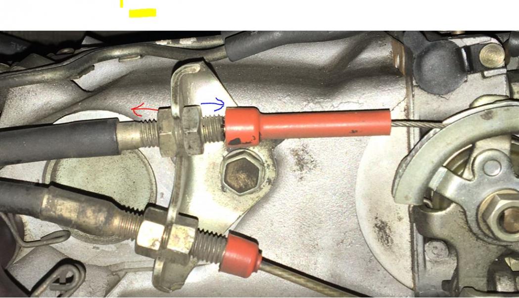

I've got an '89 4x4 van-wagon, auto trans that is not shifting into high/4th gear. It seems like it could be related to the accelerator kick-down. Is there a vaccum modulator/electrical component that could be at fault?
Any thoughts or suggestions would be greatly appreciated.
thanks, donne
'89 4x4 auto trans intermittent shifting from 3rd to overdrive
Still trying to diagnose this shifting issue, have had it looked at by the Toyota dealer in San Raphael CA to no avail. I have adjusted the kick-down linkage all the way thru it's range, and while it did affect the first two shift points, it did not affect the 3rd shift, 3rd gear to overdrive. At this point I am suspecting either a faulty overdrive solenoid or low fluid pressure, although the low fluid pressure seems like it would affect all of the shift points.
thanks, donne
