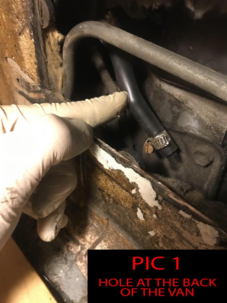

Pic of my old DOH hose (the one he got replaced with a heater hose)
Attachment 10411
The injectors and leaking coolant hoses should be totally unrelated to a suspected head gasket issue. I would question the mechanic's results. All you know is that there is a pressure leak, but it could be valves or pistons... unless they saw bubbles in the coolant during the test? 15% isn't a catastrophic result. I would suggest getting a chemical test to confirm a blown head gasket. As long as it is not overheating and there isn't a ton of coolant pouring into your cylinders (which would cause noticeable white smoke from your exhaust) you should be able to drive it briefly with a blown head gasket. Just keep an eye on your fluids.

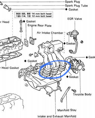

Also they replaced one of my manifold gasket bc the old one broke when they removed the manifold.
I'm wondering, is coolant passing through the manifold and from this gasket?

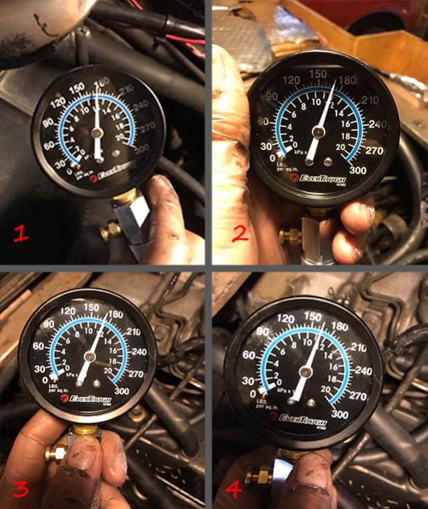

I also did the chemical test (Block Tester) and came out fine. Then I decided to do a compression test to see if my engine is fine and I got this numbers (pic below).
Are these number OK?
Attachment 10524
Those are good numbers, especially for an old van. If you passed the chemical test and have good compression like that, I'd say you can rule out head gasket issues for now.
