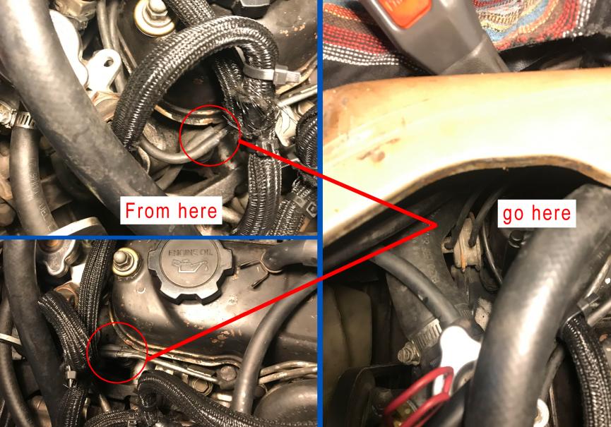

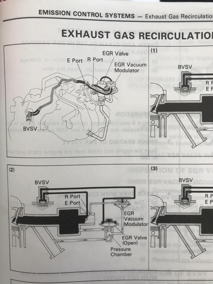

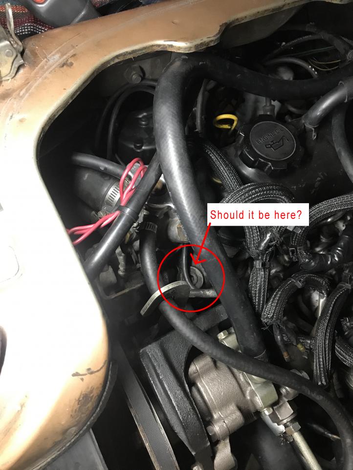

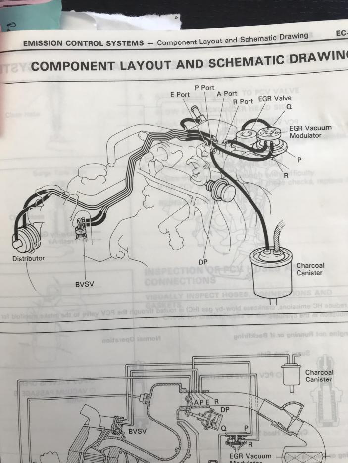

Hello everyone, I have a question about the BVSV.
I was trying to find it in my van and I think I don't have one, can be possible. Please see attached pics.
Attachment 10489
These two hoses on the left pics go direct to distributor.
Attachment 10490
Is it somewhere else and I can't see it? If it's missing can I add it in my '84 van? Do I need it because I can see the part in the manual book.
Attachment 10491
Attachment 10492
Here a youtube video with 3 different videos from my van.
https://www.youtube.com/watch?v=vjGsGE0yCns
As you see in the videos, my van has only 2 metal pipes going from my TB direct to my vacuum distributor, instead of having 4 metal pipes. Also I don't have a BVSV.
I passed the smoke test with no problem and van runs fine. My question is, why is it like that, any ideas?

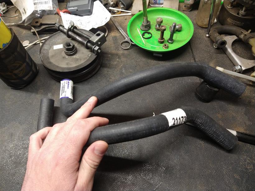

Has anyone actually purchased and/or successfully used the Gates 21173 or the ACDelco 24105L (listed on RockAuto as a similar part) on their vans? I ordered both from RockAuto and what I received was...... not radiator hoses. The good news is, both parts are the same, the ACDelco version being about $10 cheaper than the Gates. The bad news? These are very small, molded heater hoses, and are not even remotely what these 4x4 vans need.
It's odd, given that the photos and hose dimensions listed on RockAuto match up with what we need and are listed as compatible parts for a lower radiator hose. I'm obviously going to return these hoses as they are useless, I'm just wondering if anyone can confirm that either the Gates or the ACDelco have worked for them before I go down the rabbit hole of reordering the same parts from a different supplier. FWIW, both hoses have the correct part numbers affixed to them, so I'm at a loss here.
A brief google shows that the OEM Toyota part (16572-73040) as being discontinued and unavailable, so as it stands now, flexihose is the only viable option I know of for us 4x4 folks.
:doh: I was really hoping this was just a bad part # because this is what I received:
Attachment 11974
Attachment 11975
I tried to get the respective part numbers visible on both but, without getting into exact measurements, the ID on these hoses is smaller than my thumb, and I've been frequently ridiculed my whole life for having slender fingers and thumbs.
These came from two different RockAuto warehouses so I guess I'll write them and see if there's some explanation for what's going on here. Thanks for the prompt response btw, Gareth!

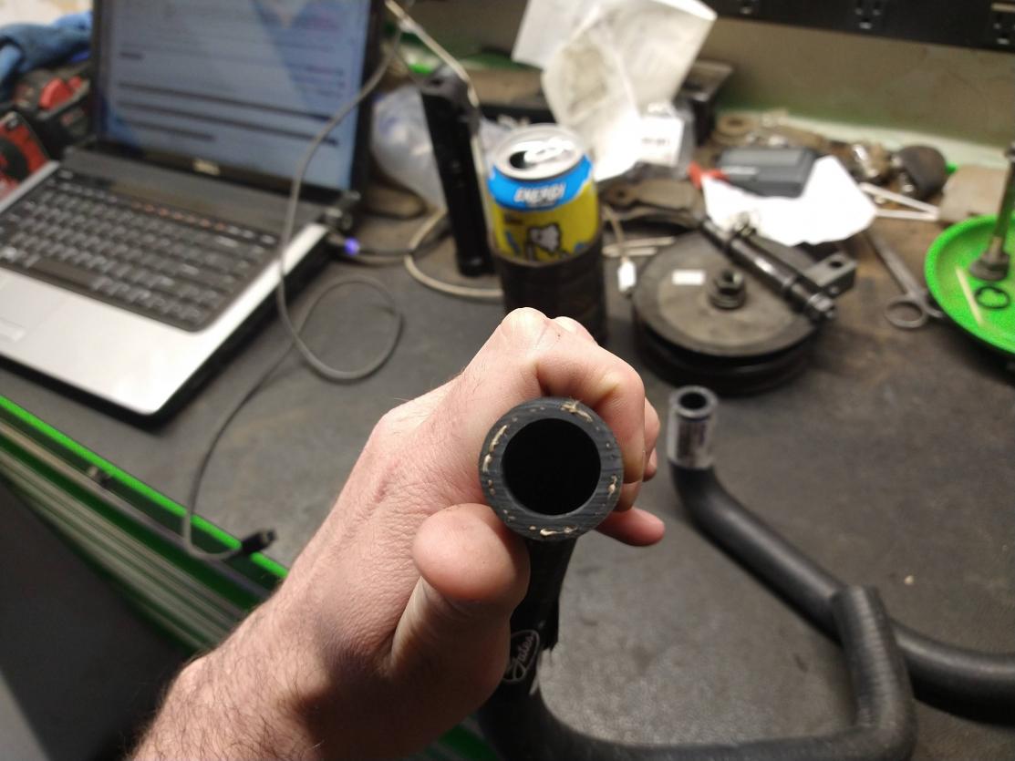

That's funny, must be some mis-labeling going on??? I just pulled one of these from my parts inventory and it's definitely a radiator hose. Here's a picture of it:
https://hosting.photobucket.com/imag...v/IMG_4599.JPG
