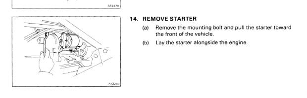

Jdelgado
you can easily access it from underneath. I believe only two bolts keep it in place. Should only take a few minutes to drop! :)
Attachment 9083
I’m looking for the second bolt to remove the starter. The first was a 14mm that attached through the transmission housing. I can’t for the life of me find that second bolt.

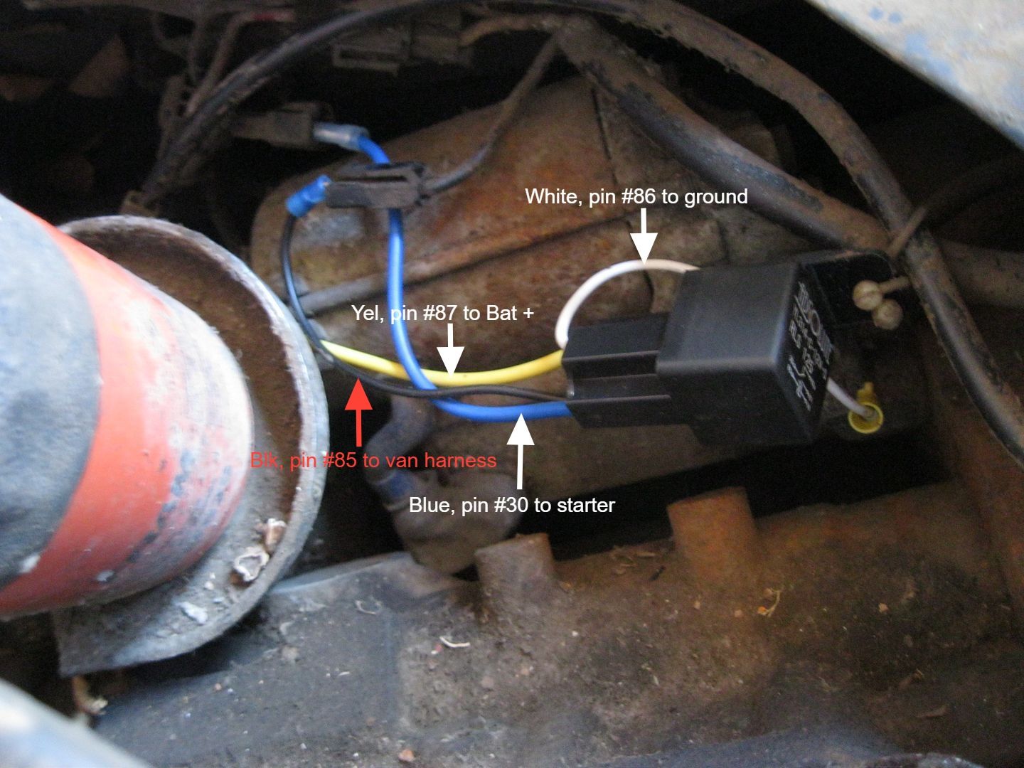

For those who have the "click" problem and you've already checked/replaced starter contacts, Here's a picture of my "relay hack" to remedy the issue.
https://hosting.photobucket.com/e65a...0e17e0398d.jpg
Here's a link to the needed parts: https://www.amazon.com/Bosch-Automot...4&sr=8-10&th=1. Tim

After a few days of reliable starting, the van sat for a week and now all the sudden I am getting 2 volts at the starter solenoid again. I may just try your work around so I don't have to fool with this thing anymore.
Re: Click-No-Start (Starter, Ignition Switch and other Culprits)
When it's acting up and you are only seeing 2 volts, unplug the starter wire and see if the voltage increases. If voltage jumps up to 10 or more, this will probably work.
Low voltage to the starter trigger wire is due to a faulty component in the starter trigger circuit. In some cases it's due to small voltage drops from multiple components. This hack works because it greatly reduces the load on the trigger circuit and boosts voltage/current available to the starter solenoid. You still need enough current/voltage to engage the coil on the Bosch relay, but that's significantly less than what the starter solenoid needs. In cases where voltage drops under load this hack can be the solution. The best part is it doesn't bypass safety protocols. Tim
I had a spare relay lying around and wired it in on my lunch break, fired right up. At this point I am so tired of playing with it I am just happy to be able to start my van so I can move it before street cleaning happens in a few days...
