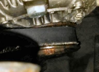

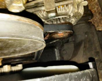

Sorry this took so long! The flash on the camera failed almost every time. Out of fifteen tries, these are the only decent ones I could get.
Attachment 9655
Attachment 9656

Now I suppose someone's going to tell me "That's not the alternator belt". LOL! That would mean I ordered the wrong part.
Without being there to see it for myself... I can't know.
Since you know how to tighten/ loosen it now, why not just err on the side of caution and change it?
I ended up going to a repair shop. Here's what happened:
There was nothing stripped; the pulley was turning along with my wrench, apparently, and that's why I couldn't tighten the item (nut or bolt, I am now PERMANENTLY confused on that score). The pulley itself had an inward bend in it. I hadn't seen it before because it was not showing when I looked, it must have been on the bottom. But it could clearly be seen with the engine running. The mechanic said it must have been hit by a rock.
So I now have a new belt, and a pulley with a spot that was banged out by the mechanic so that it will no longer eat up the belt. If he made a mistake, I'll know soon enough. He had no trouble removing the bolt for the power steering belt adjustment. Maybe I wouldn't have had trouble with it if I had tried it again since the last time I sprayed it and banged on the nut.
I learned what I did not know before this visit to the mechanic: that the alternator pulley is PART OF the alternator.
Bottom line: I am another $140 in debt. Even before this expense there was already going to be no Thanksgiving or Christmas, and now there will be very little heat this winter. It's either that, or don't pay my property tax bill. I think I'd rather keep the house and be cold for the winter. At least I will be able to stay dry.
