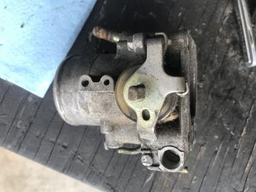

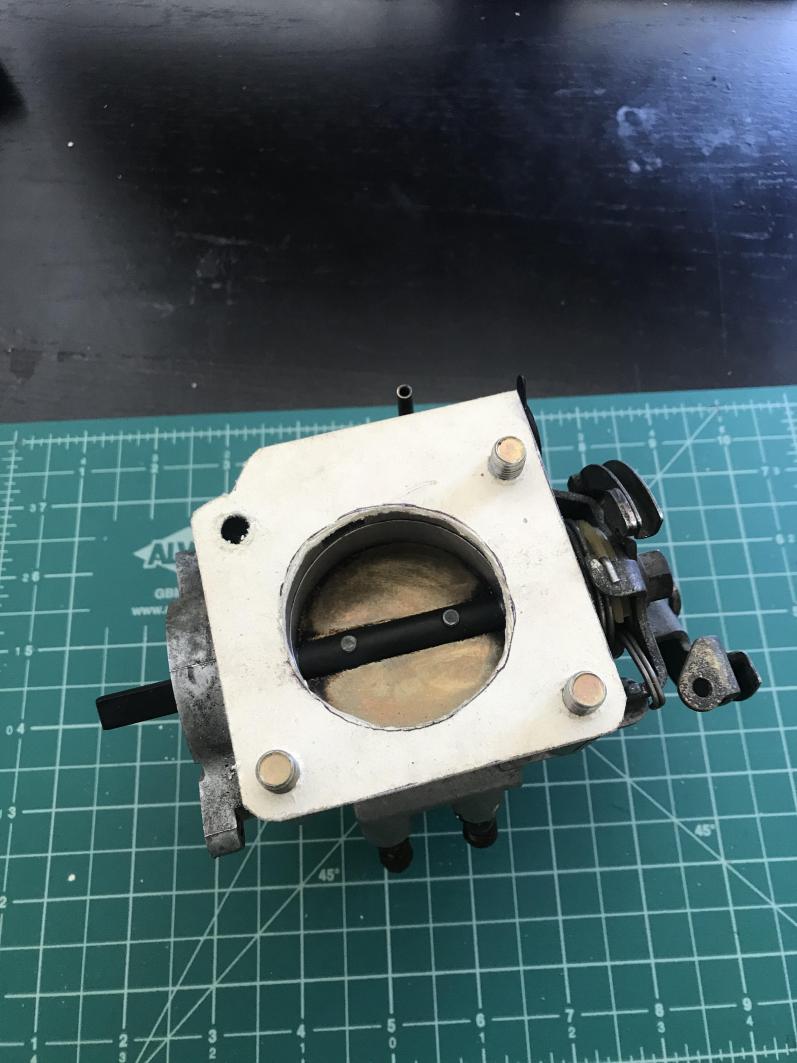

Attachment 10234Attachment 10235
i have a spare throttle body i was cleaning up as practice for cleaning the TB currently attached to my van.
While disassembling this TB, the plastic spacer for the springs (Circled in red) disintegrated.
when i get to the point in picture 2, will all that come off as one, or will the springs need to be unattached first? I attempted to disengage the springs from the piece that hits the throttle stop screw and thats when things fell apart.
is this piece replaceable (part number?)? Or, if this happens round 2 am i screwed? Anybody with a TB thats NFG got a spacer to donate/sell?
other than that, everything went swimmingly and metal parts are currently soaking in chem dip.

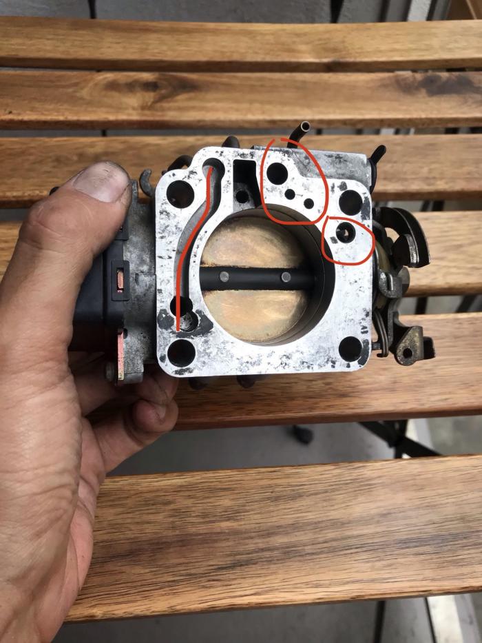

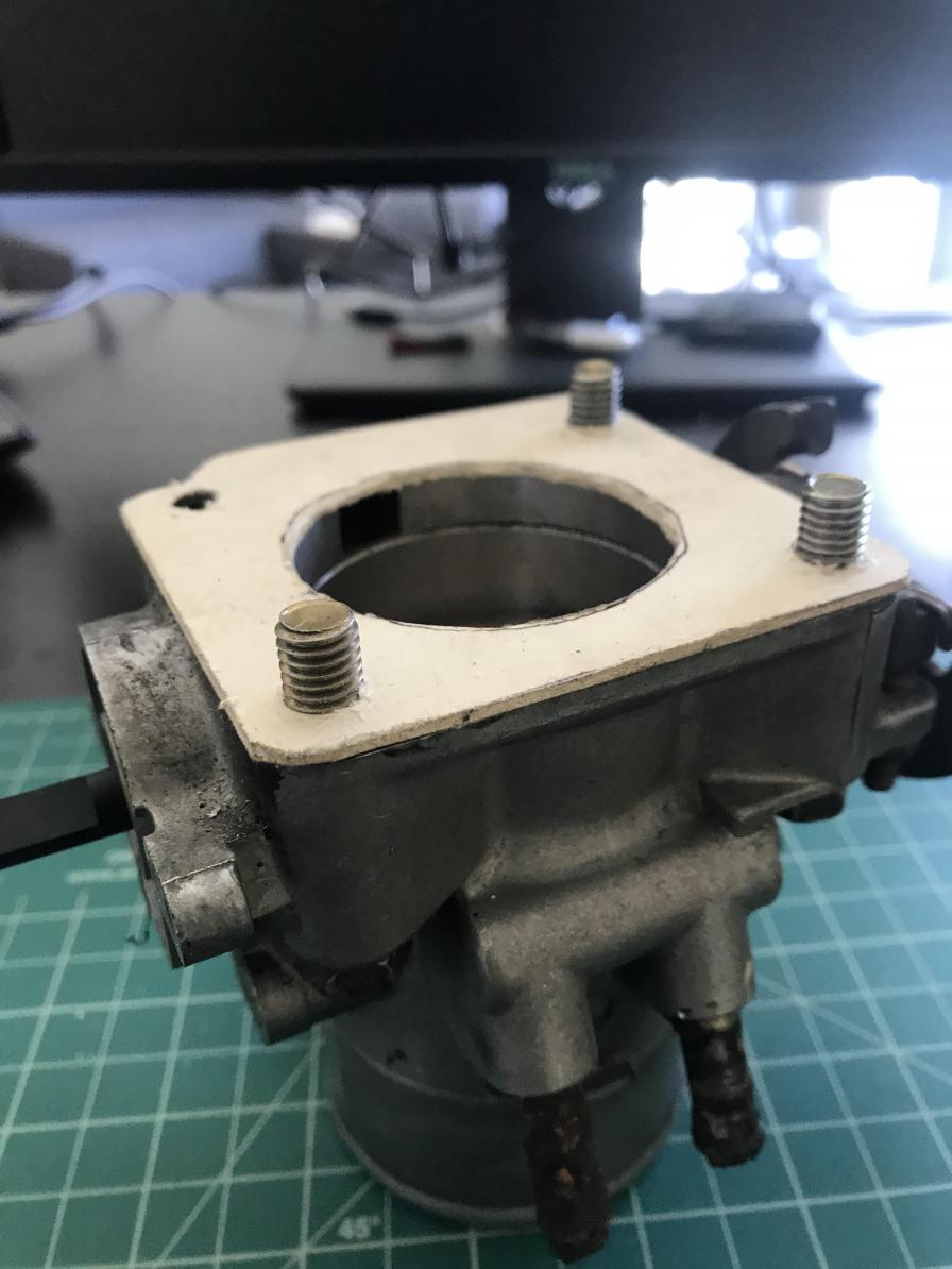

I got this TB from an automatic '86 van. I cleaned it and built a gasket. For the gasket is this what I need or do I need to make the other caps i have marked with red here?
My van is '84 manual, is it the same TB for auto and manual vans?
Thank you!

Take a look at the 1st and 3rd posting on page 1 of this thread-
1st posting- auto TB
3rd posting - manual TB with Dashpot
If I’m understating correctly the 5 speed vans have a dashpot on the TB, I’m not sure if that means they are not interchangeable.
Whats the part number on your TB?

I think I'm not going to risk it, I will stay with my TB I have in my van now. I just have to take it and clean it. I though it will be faster for me to have an extra TB and work on it while I can drive the van too.
The number of the TB I took from the junk yard is 730 32.
Do you think the gasket is right?
Re: Article: Cleaning the Throttle Body
I know the gasket is impossible to find (NLA) and some members have either made a gasket or used a gasket maker, sorry I don’t remember what it’s called. There’s a couple of different TB part numbers imprinted on various years TB’s, looks like the one Tim is rebuilding looks like 730-39. I’ve sold a couple of them but can find the posts, I think they were cleaned up during forum house keeping as old closed posts.
Although the TB gasket (Toyota part #22271-73011) is NLA through Toyota, these will occasionally come up on eBay and other sites as NOS "New Old Stock" (I just checked eBay but nothing is currently available). Compete Aftermarket gasket sets are still available and some will include this gasket: https://www.ebay.com/sch/i.html?_fro...asket&_sacat=0 https://www.ebay.com/sch/i.html?_fro...Desc=0&_sop=15. If you need to make one, Here's a picture of what it should look like and how the holes line up:
