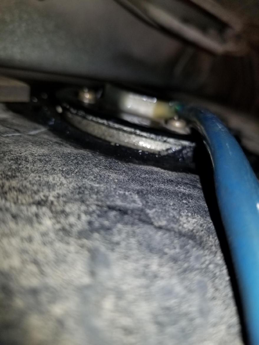

Sometime in the vans history, the back firewall was chopped into to gain access to the back of the engine. After removing the back heater vent, discovered a poor attempt at a fiberglass repair and finally discovered where my exhaust fumes have been seeping in :dizzy:
Before I weld it back, wondering if there's a good reason to keep a removable panel here instead of patching it up completely? I assume it must of made some PIA job easier in the past. Does this give access to "the hose of death" I've heard about or some transmission bolt that's otherwise impossible to reach?
Attachment 10856
Attachment 10857
Wondering which parts (part#s) I may want to inspect or stock up on/replace while I still have easy access?
Wow, that's a nasty looking hack job. There is a benefit to having some access here, but it's hard to imagine a cut like that helping much. If it were mine I'd weld/patch that, then maybe put a more reasonable access hole there if/when needed.

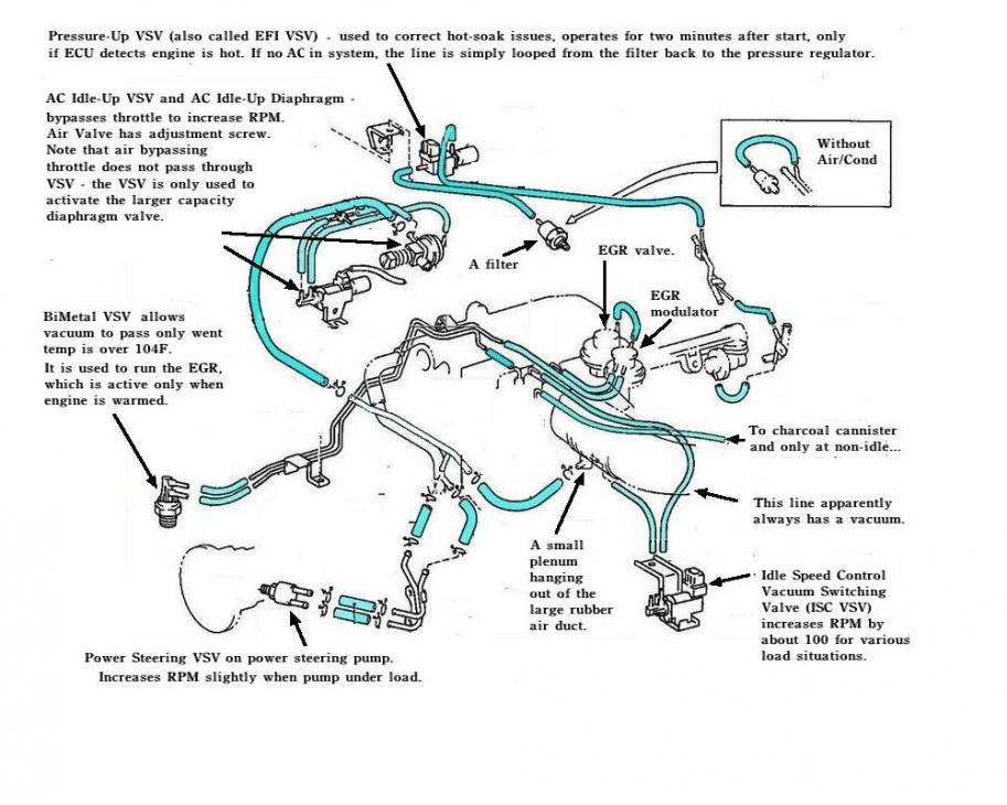

This valve/actuator was dangling to the back of my engine, does anyone know sure where it should be mounted?
The vacuum hoses are so long, I have no idea where to look.
I think it is valve nr 2 on the diagram
in my repair manual, i think it is mentioned as a vacuum switching valve, it is listed as part of the air conditioning system, but it does not mention where the part is supposed to be mounted.
Attachment 11700
Attachment 11701
There's a hole on the side of the engine block behind the oil filter. Here's a picture of one mounted:
https://hosting.photobucket.com/imag...MG_4477(1).JPG
It's your "pressure up" vsv. One hose should connect to the manifold via a little black filter device and the other hose should go to your fuel pressure regulator (other side rear of engine). Tim
Thanks a bunch!
