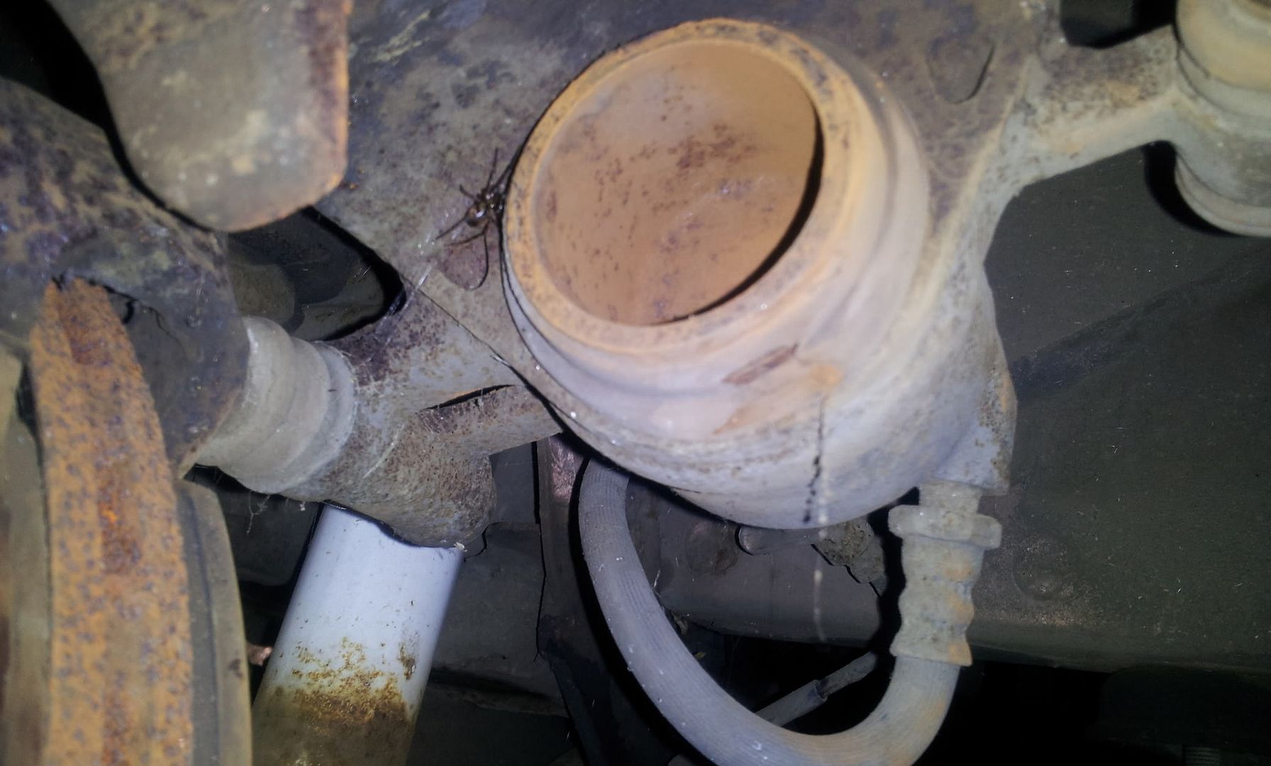

I'd agree with you diagnosis, as to seized. That "puck" should push in fairly easy. I usually use a C-clamp, but it's not a major force thing. I just did both sides, on the front of my '87 4x4, for about $250. That was calipers, rotors and pads.
Re: Time for new calipers.
Yeah, not even gonna bother with rotors. You have to remove the whole damn hub to remove the rotor. If the wheel bearings were going out, then I'd go ahead and replace them and the rotor. But the rotor spins freely without any play. Maybe after payday or when Uncle Sam pays me my refund, I'll go ahead and order both calipers and a set of brake pads.

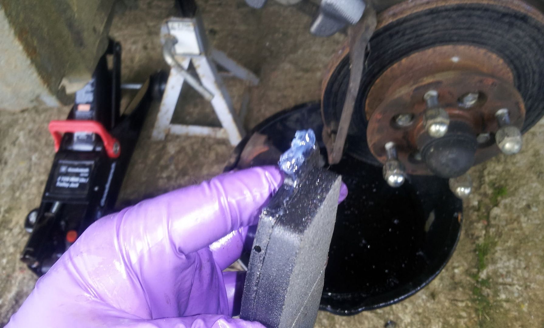

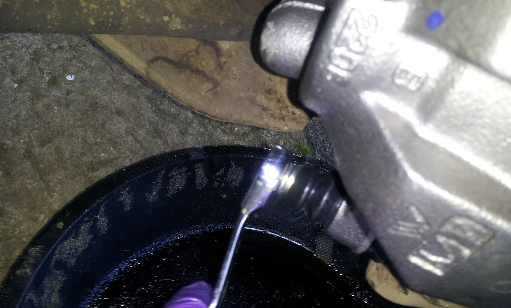

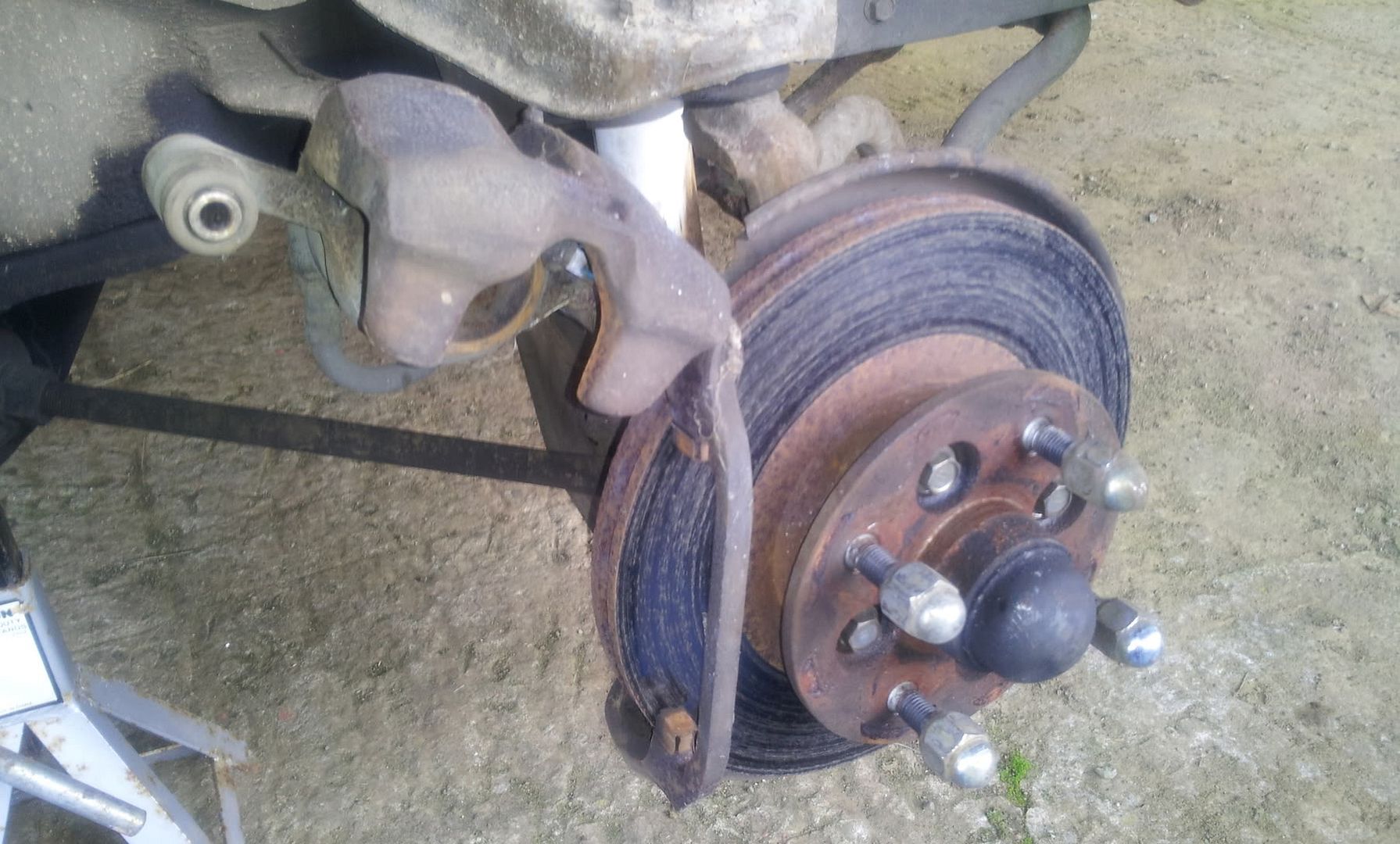

Made some more progress today.
http://i216.photobucket.com/albums/c...225_134902.jpg

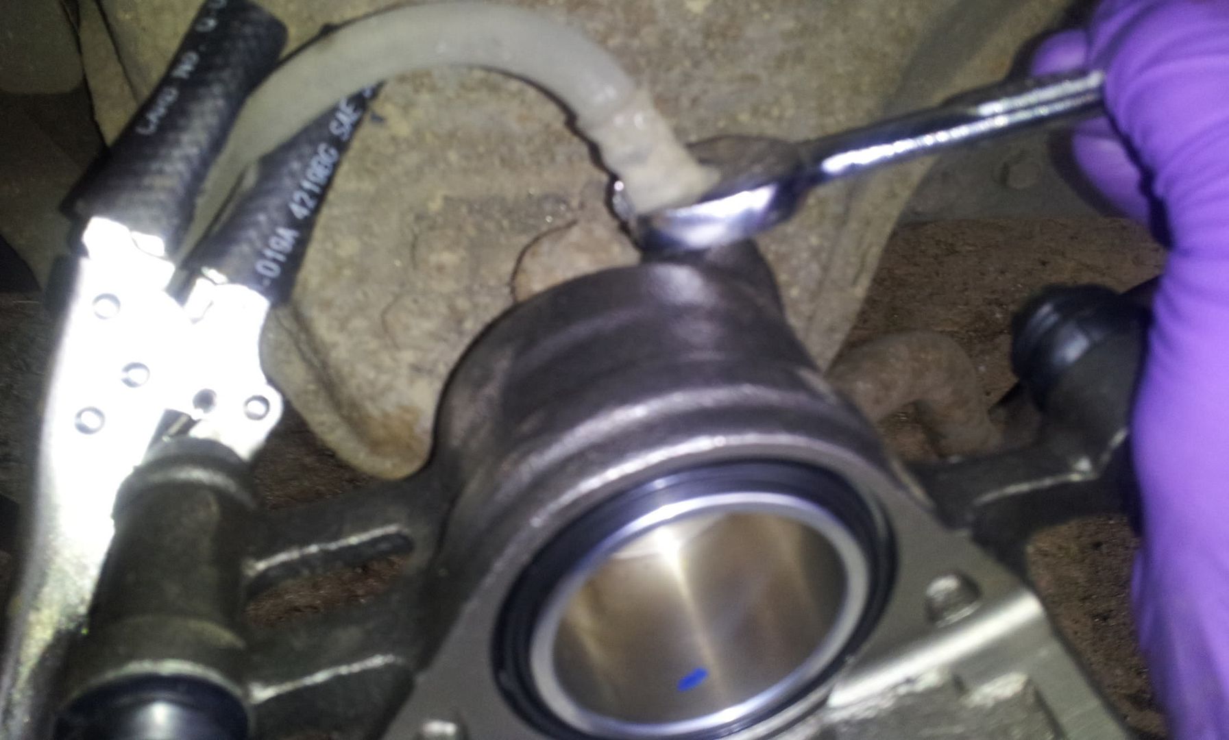

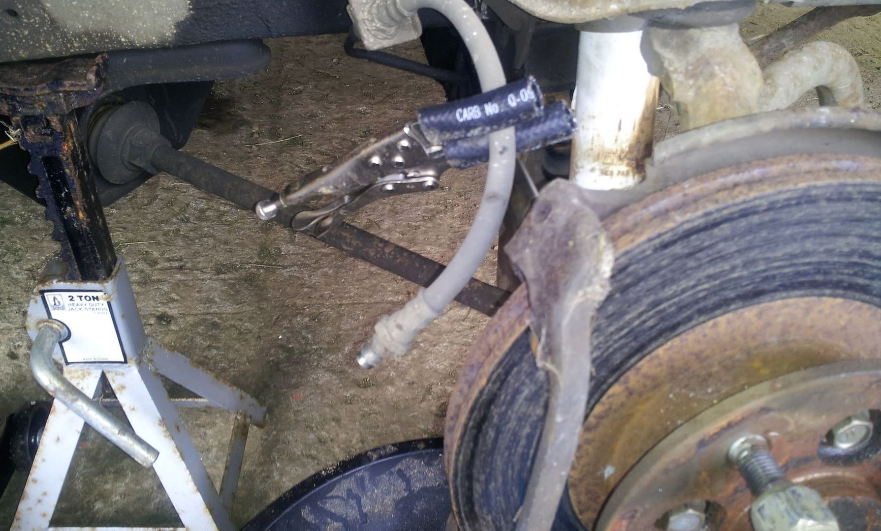

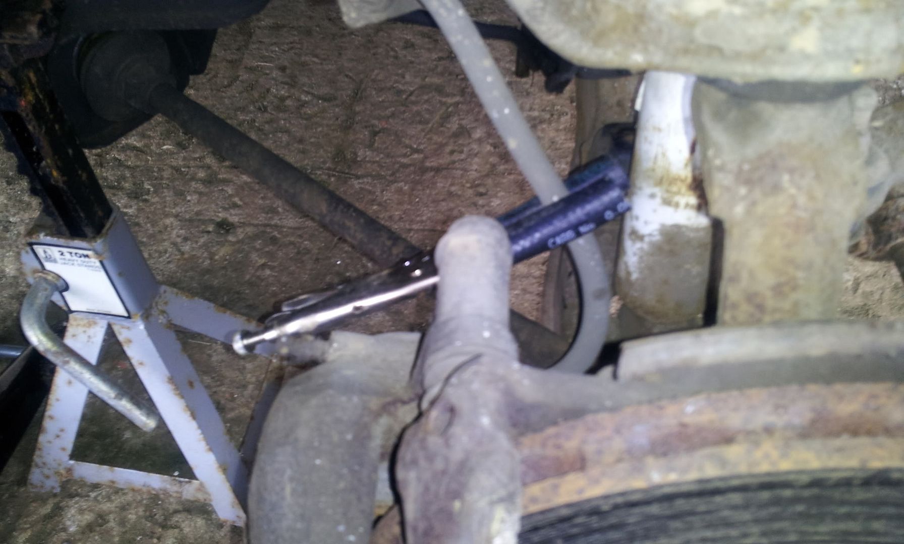

Pinched off the brake line so the fluid doesn't drain out of the system.
http://i216.photobucket.com/albums/c...225_135318.jpg

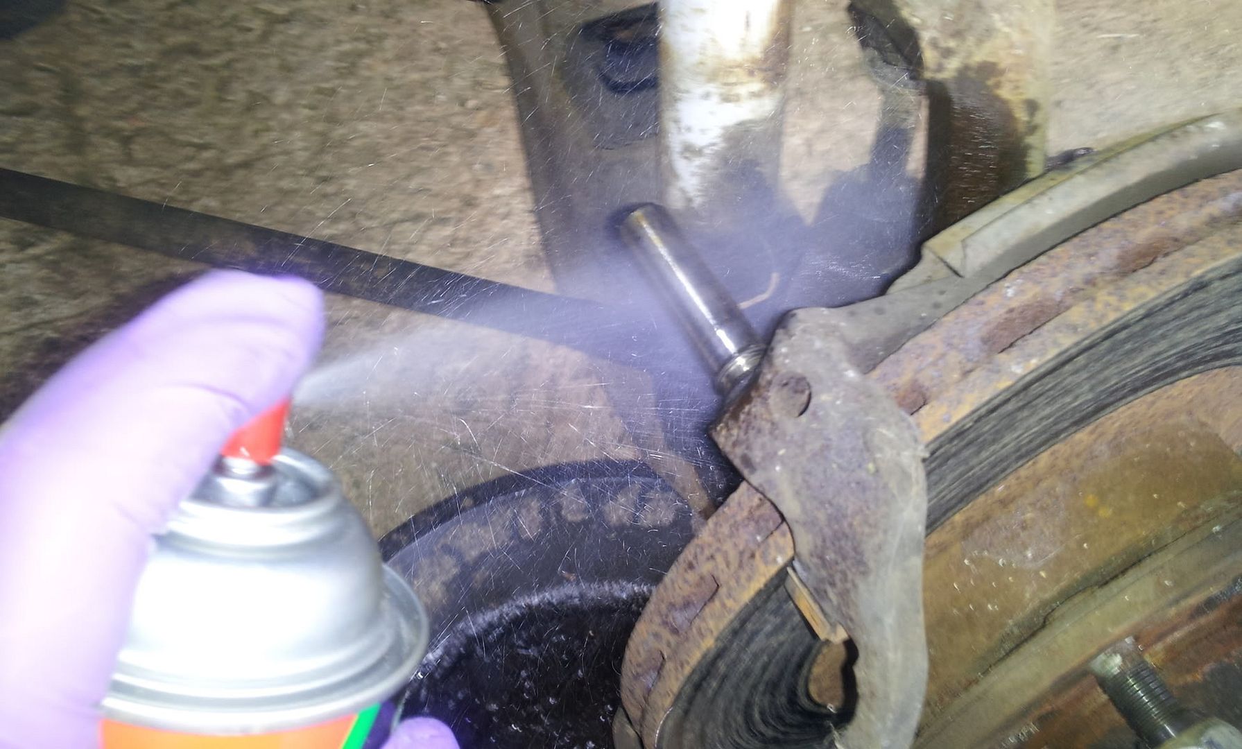

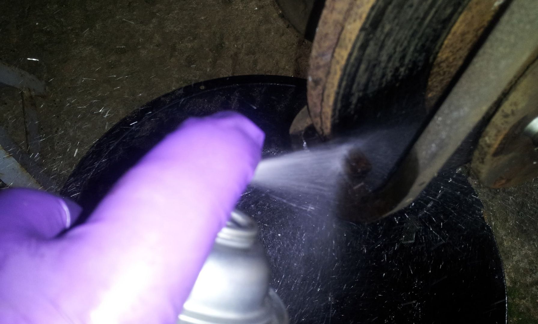

http://i216.photobucket.com/albums/c...225_135457.jpg

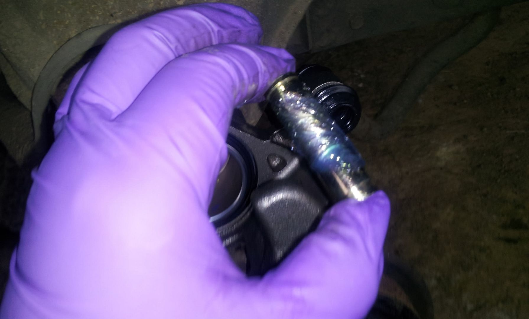

Cleaning old grease off the slide pin.
http://i216.photobucket.com/albums/c...225_135550.jpg
http://i216.photobucket.com/albums/c...225_135929.jpg

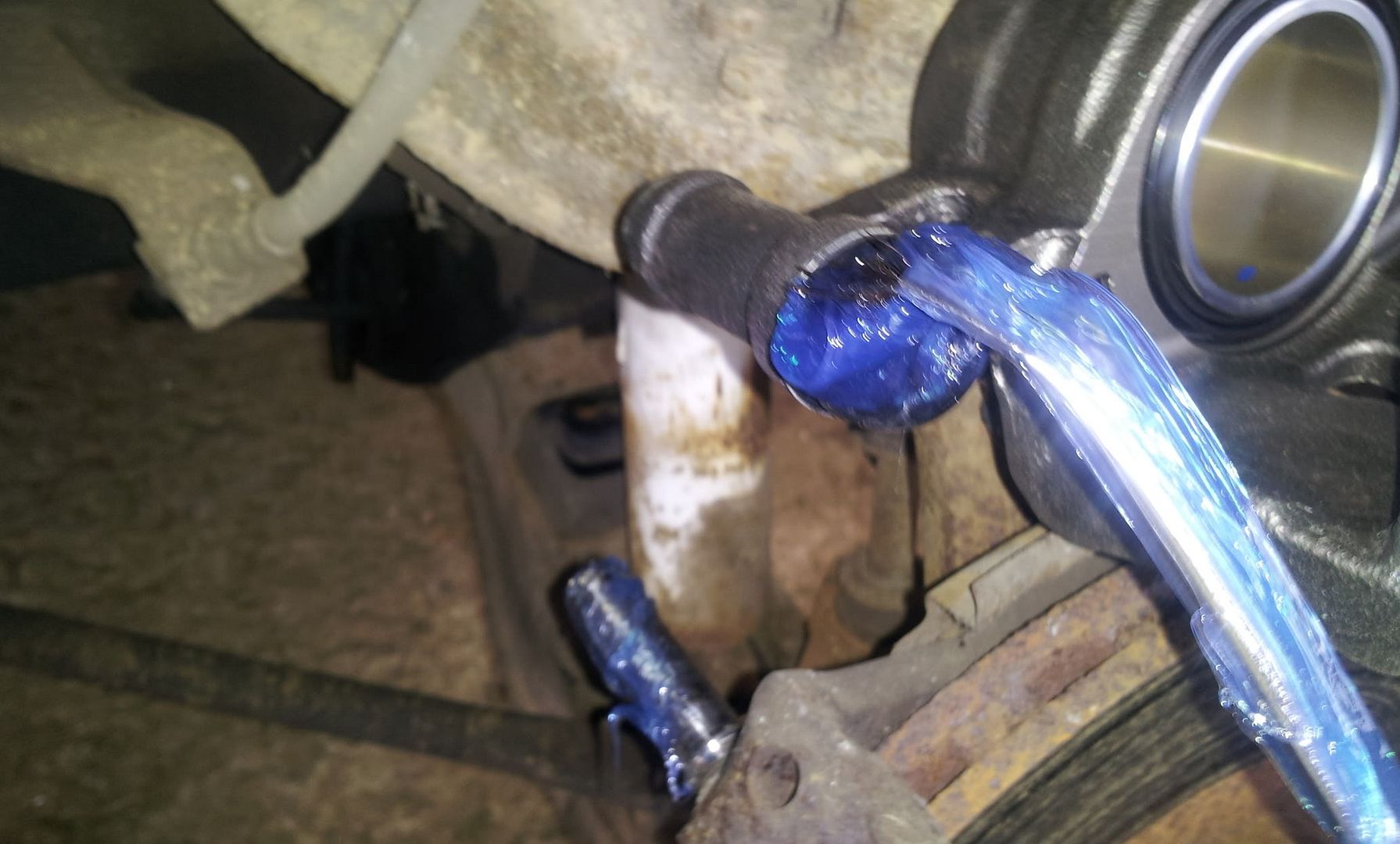

Relube slide pins and the insides.
http://i216.photobucket.com/albums/c...225_140045.jpg
http://i216.photobucket.com/albums/c...225_140245.jpg
http://i216.photobucket.com/albums/c...225_140136.jpg

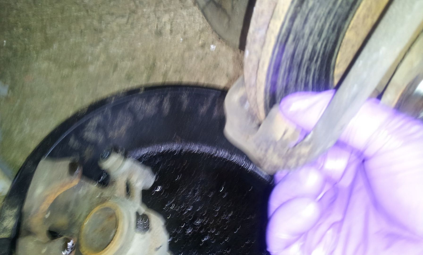

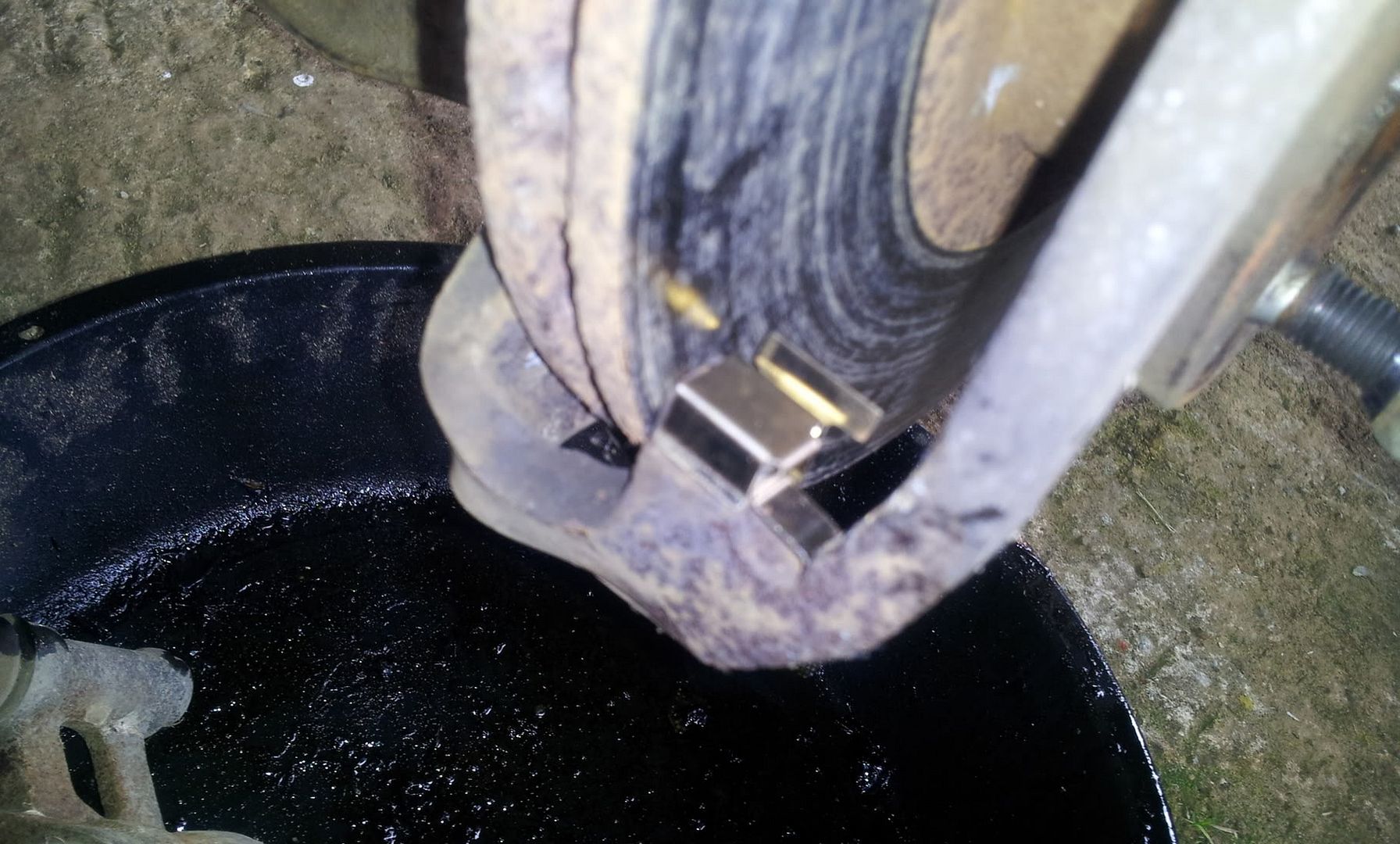

Remove old anti-rattle clips and install new. Do this for all of them.
http://i216.photobucket.com/albums/c...225_140734.jpg
http://i216.photobucket.com/albums/c...225_140753.jpg
http://i216.photobucket.com/albums/c...225_141008.jpg
Little bit of lube on the ears of the brake pads so they'll slide better and install them.
http://i216.photobucket.com/albums/c...225_141929.jpg
http://i216.photobucket.com/albums/c...225_142315.jpg
http://i216.photobucket.com/albums/c...225_142427.jpg

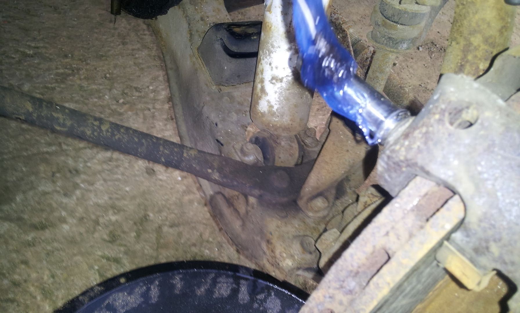

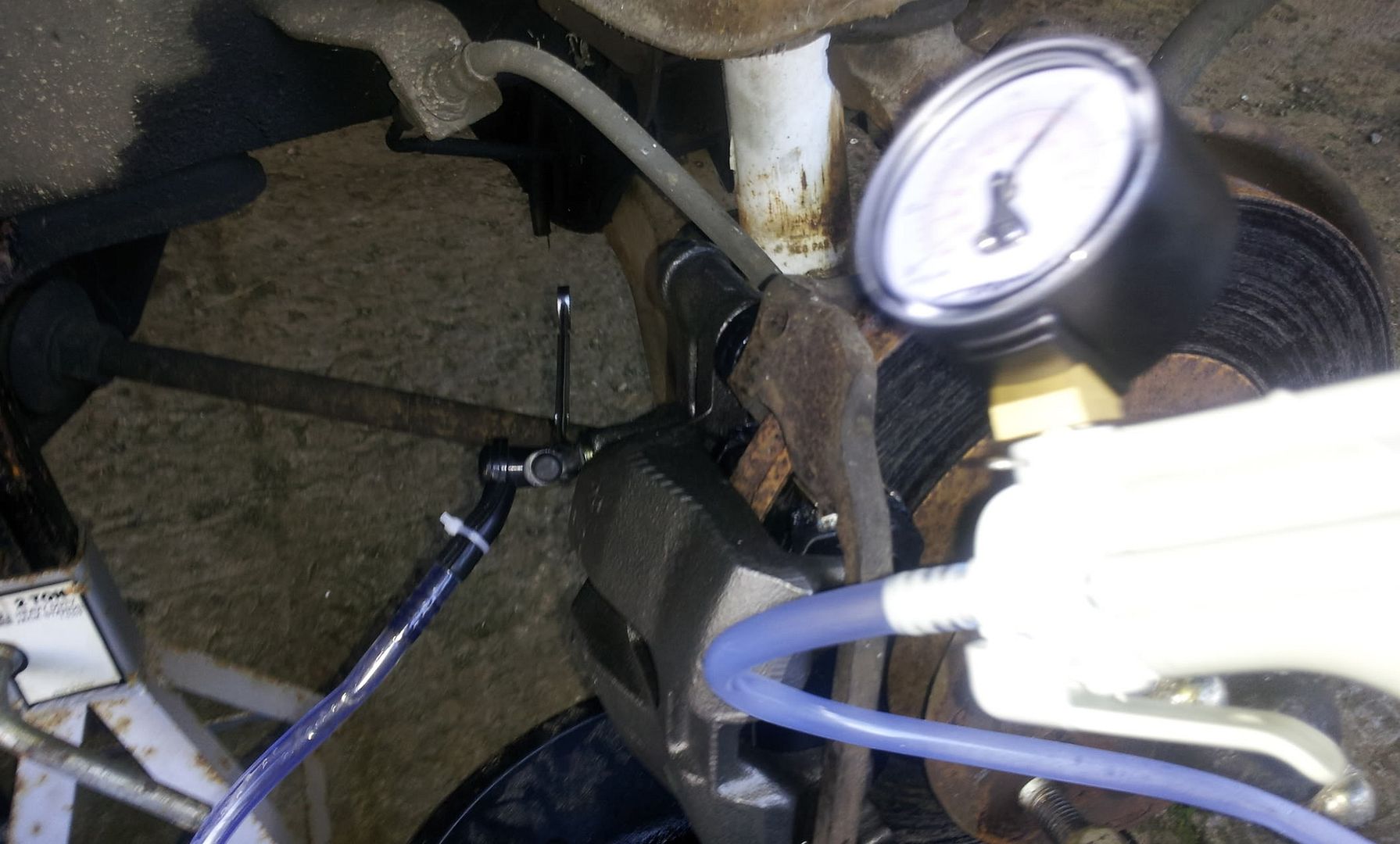

Rebleed the system, pump the brakes a few times, and keep bleeding 'til all the air is out of the system. Also, the MityVac you get at O'Reilly is JUNK. Don't waste your money on it. Some simple aquarium tubing and a coke bottle and someone to yell at to pump the brakes works MUCH better.
http://i216.photobucket.com/albums/c...225_142759.jpg

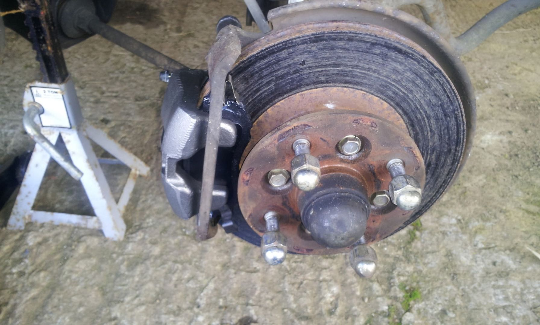

All done.
http://i216.photobucket.com/albums/c...225_144136.jpg
I also accidentally ran the master cylinder dry. So I had to run an entire bottle of brake fluid through to get the air I introduced into the system out. Upon doing that, I noticed the brake fluid I flushed through was all milky. So, definitely some moisture in the system. I will make an attempt to return the vacuum pump. I got it all cleaned up and back in it's package. It's just crap. I did the best I could to bleed the brakes and still ended up with spongy brakes on my first test drive. I bled the front brakes again with the coke bottle method and they seem a little better. I will bleed them all soon when I get more brake fluid and get my Dad to help me. The brake fluid I saw come out of there was just nasty. No telling how bad it might be for the rears.

Thanks for the nice write-up and pictorial KC! I know you worked hard on this and we much appreciate your work here :thmbup:. I realize critiquing your efforts may be offensive, and for that I apologize. But..............for the sake of safety I feel obligated to point out a couple things that worry me. Flexible brake lines should never be pinched, crimped, or clamped. It's brilliant how you protected from the jaws of your vice grips, but most types of flexible brake lines are lined with a semi-ridged material that can be fractured if pinched in this manner. If you're worried about losing brake fluid, a better alternative would be putting some plastic wrap over the reservoir opening and putting the cap back on (blocking the vent in the reservoir cap will prevent flow). Another way is to leave brake lines installed until the very end, then work fast to switch them over. If you're fast and careful you won't lose more than a few drops.
I usually use anti-seize compound on the slider pins (grease is okay too) but only a thin layer. No excess grease should be allowed outside the weather boot though. The weather boot keeps it inside (where it belongs) and should easily last for the life of the pads. Each time pads are replaced these should be cleaned/lubed again. This is the ONLY area that should be lubed on disc brakes. No other places require lube, besides, due to conditions it won't stay for long anyhow. Too much risk of contamination using lube any where else in this vacinity. Tim
Yeah, I expected some criticism for using vice grips on the brake lines. I did some research and read that people that do this don't have any problems. Eric The Car Guy even pinches the brake line closed, which is where I got the idea of using rubber hose on the grips. Some of the grease was exaggerated in the pictures. I did wipe off the excess. Eric recommends Silicone Paste for the slide pins. I think what I got is silicone based. Doesn't say, but it is synthetic.

I have never met "Eric" or any of the others that have done this and not had problems, but obviously they have better luck than I do.
Once, when I was young and just starting out, I was told to do just as you did in the pic's.
Afterwards I spent a great deal of time, money and aggro trying to solve my intermittent brake pull,
needless to say the only solution was replacing the rubber lines I had clamped shut.
It was an expensive lesson and one I have never forgotten.
For what it's worth, I have met many "professional wrenches" that do the same thing.
Those same people profess there is no such thing as a "comeback", just "return for more work".
When you do get around to bleeding the rear brakes, don't forget to finish off the job by bleeding the load sensing valve to the rear brakes.
Silicone paste is the best product for slide pins. It seems to last the longest, and GM/Ford both specify it in their service manuals. There are a number of internet rumors saying that the Permatex synthetic and ceramic lubes dry out quickly, but I've never seen this myself.
I use either Motorcraft XG-3-A or 3M #08946. Anti-seize compound should not be used since it is has a petroleum base, which has a tendency to swell rubber boots.
It is critical to wire wheel the portion of the caliper bracket that the clips sit. In areas with lots of snow and salt, rust tends to grow on the metal surface and causes the pads to lock into place. It may be a good idea to apply a light film of Molykote M77 (available from Honda) to the metal surface before reinstalling the clip. I also put a very light film of M77 on the pad "ears" so that the pads slide better.
