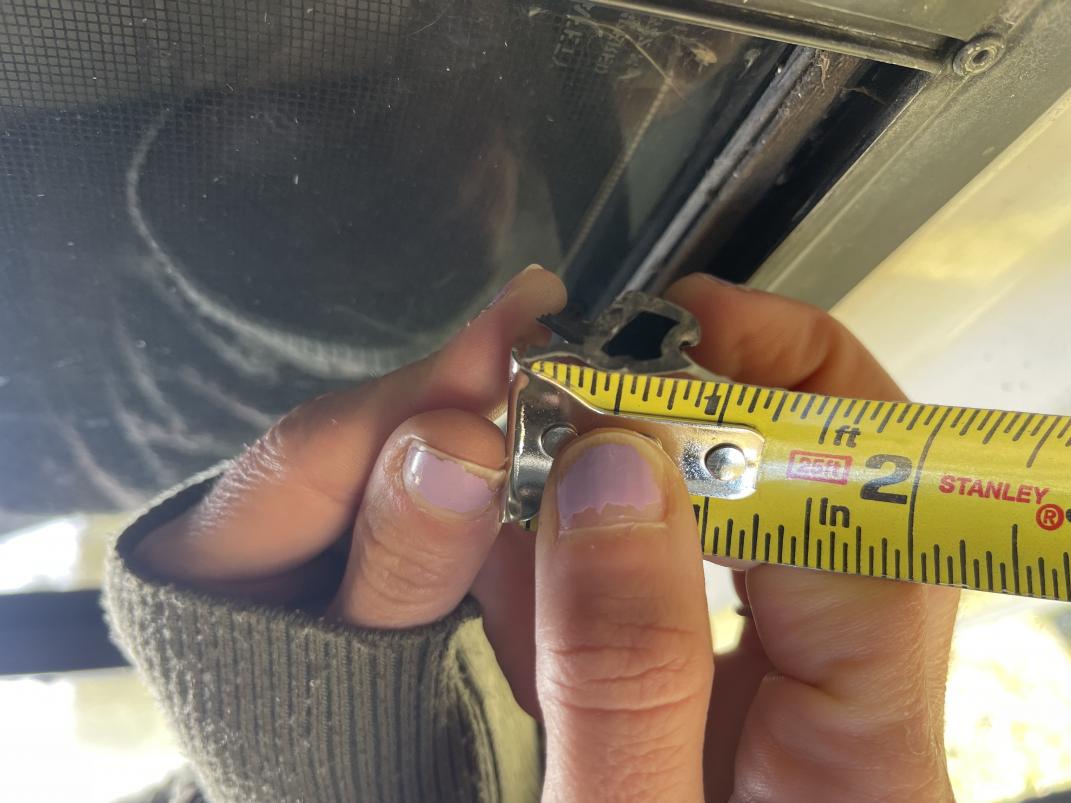

Hey ya'll - Im hoping someone has guidance on finding a replacement window seal for my 1991 Toyota Liteace. Photo attached. Thank you!Attachment 12616
Companies, such as steelerubber.com have hundreds of options for various rubber seals on a vehicle. I have used them for some other classic car projects.
Many of the seals are a universal type, so take the most accurate measurements of your seal, and compare the "profile shape" of your seal to the hundreds of options available. You should be able to find something that will work. Good luck
