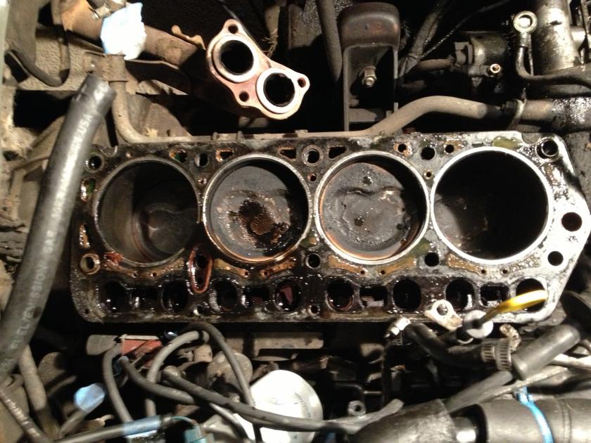

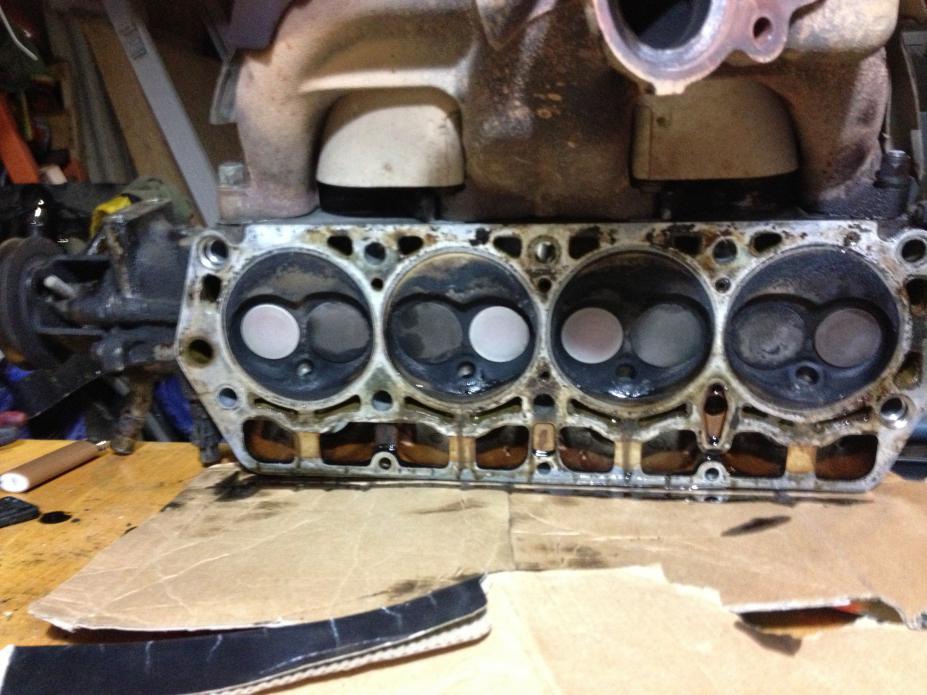

Got the head off, phew that took some work. How's my head look? The valves on the right look real dirty compared to the others. I was going through A Lot of oil, guessing this is a symptom of that. The gasket didn't really look too bad and my cylinder didn't have that "clean" look I've seen others have when the cylinder has been burning coolant. Oh well I'll be taking the head in to be checked. Anyone know a good head resurfacer in Portland?

It's a bit disappointing to not see any sure sign of a bad head gasket after removing the head. Based on the way things look in that photo & what you said before, I'm guessing you have a problem with the oil control rings in #4.......possibly #3. Still, as you said, the next thing to do is take the head to a machine shop and have it checked over. If the valve guides are worse in #3 & #4 it might explain the difference in build-up/oil consumption, but I'm guessing it's stuck or damaged oil rings. Can you see visible scoring on any of the cylinder walls?
When it comes to machine shops I'm sure there are lots of good ones out there, but unfortunately there are also ones that aren't so good. A general rule of thumb is you get what you pay for. Based on personal experience I lean towards the shops that specialize in racing and/or high performance engines. These shops tend to have more attentive machinists and usually do better quality work. They usually charge a bit more, but the difference isn't drastic. I use Nutter Racing Engines in Vancouver, WA but I'm sure there's others in Portland. Just Google "racing engines portland oregon". If you use a racing engine shop, just be prepared to take a little crap about it being a "lowly import rice burner" :wnk:. Compared to the stuff they normally work on these things are "wimpy" but the principals are the same and the machining practices don't change.
Regardless of who you take it to, be sure to tell them the valves are non-adjustable so they need to compensate for the machine work by grinding the valve stems. They will probably already know that, but it doesn't hurt to remind them. If you purchased your own gasket set, bring them the valve guide seals or they will likely use aftermarket (may or may not make a difference depending on what they use). For all I know, they may have something better, in which case I'd probably go with whatever they recommend. Tim

So, rings means a disassemble huh? Oh man, no time for that. I didn't see any scoring on the cylinder walls of #4, actually that #4 looked smooth as glass but I'll take a second look.
And no signs of a busted Hg, but it was doing all the tell-tale signs: Coolant out the overflow after driving on the highway for more than a half hour, and tiny bubbles(isn't that a song?) you could see under the radiator cap. Maybe I didn't burp it enough but I burped it a bunch...
Oh well, we'll see what the head shop says.
