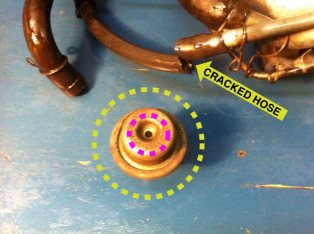

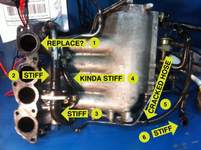

I finally got my manifold off today (!) and have been looking over the rubber. I am assuming that the hoses with factory clamps is probably original equipment. Both of the "Hoses of Death" look like they were replaced but if this is cheap I might as well put fresh rubber on. This looks like pretty standard get anywhere hose right?
Here is a look underside the manifold where things seem a little crunchier.
I should have asked this before. Is there an online microfiche type thing where I can identify parts and get part numbers? I have a lot more questions now. What is this stuff?
(1) Do I need to replace this gasket?
(2, 3, 4) These are pretty hard. Should I replace and if so can I get this hose anywhere?
(5) This hose cracked it was so brittle. I think I have seen this hose at the parts store. I have extra gas line hose but it says "Do not use for fuel injection" or something like that. I guess that is a pressure thing? This cracked hose will appear in the next two shots also.
(6) This hose is brittle. If it is not a high pressure or super critical maybe I can let it slide? It looks like it must be from Toyota with all the fancy manufactured bends. Right? Probably spendy.

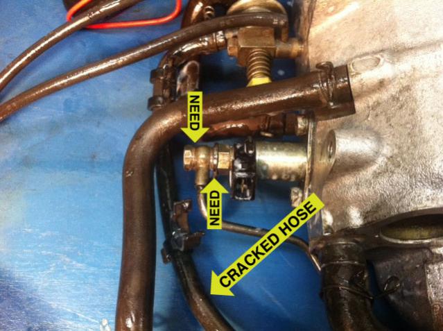

This next picture is just to remind me to get lots of these little brass washers.
(1) Do I need a special part number or can I just take them into the auto parts store and get the same size?
(2) How hard do I torque the little brass washers?
note: there's that cracked hose again
http://www.toyotavantech.com/forum/a...5&d=1338793831
And finally here is my pressure damper. Looks ancient. I guess originally it had a screw in that little hole from what I read in another thread. I am going to hold off ordering this and see if maybe the doctor knows where to get one tomorrow.
(and there is mr. cracked hose again
http://www.toyotavantech.com/forum/a...6&d=1338793843

Thanks Tim! So I gather you WOULD replace ALL of the rubber. Correct?
Re: Replacing Fuel Injector(s)
Yes..........unless you feel like splitting the manifold again in 2 or 3 years to replace just one or 2 of them :lol:. Assuming that's original rubber I'd say now is a good time. Tim

Where do I find the part # for the intake gasket?
Also the little brass washers that go with the banjo joints... I can get those anywhere right? I ordered the BIG ones for the pulsation damper because I had the #'s and I thought they might be slightly harder to find.

That gasket is not interchangeable from 3y to 4y, so in your case (3y) you'll want Toyota part #17176-73010. I'm sure it's also available aftermarket. If you go that route be sure to specify it's a 3y. It's called a "surge tank gasket". The little copper washers are Toyota part #90430-08005. If you like the ones with the little tab sticking out those are part #90430-08007. These are common parts so I suspect if you walked into any auto parts store and showed them one they could easily match them up. Tim
