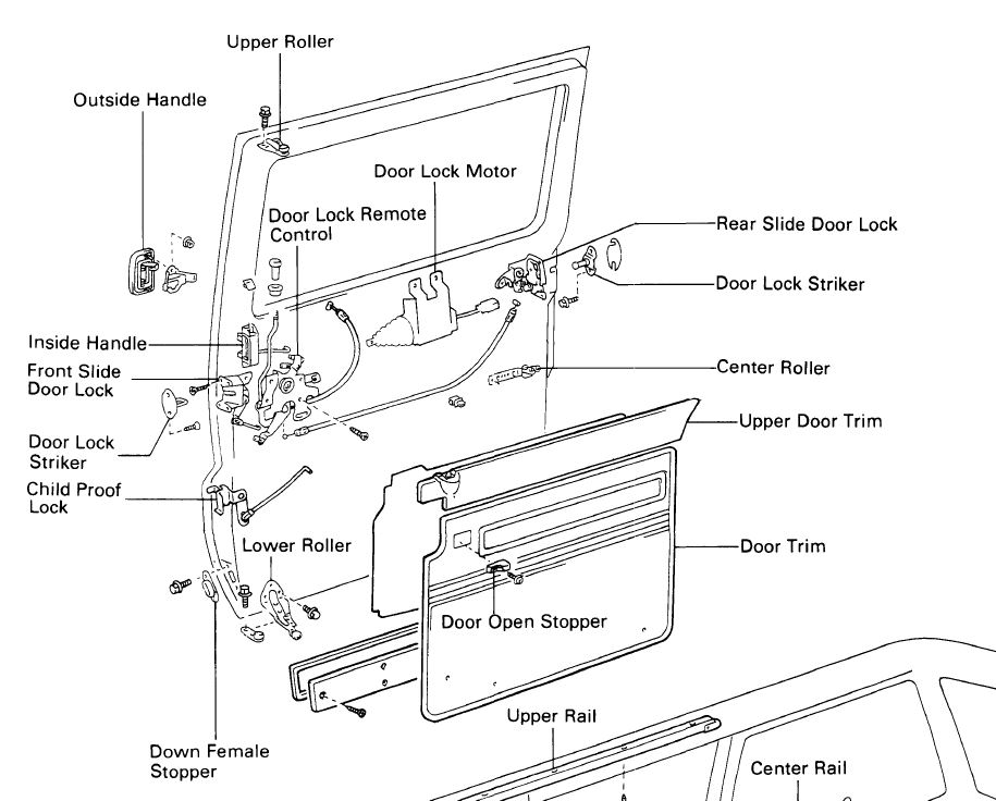

http://www.toyotavantech.com/forum/s...s-new-and-used
I guess this is the diagram even though it doesn't look like it:
https://www.oemgenuineparts.com/oem-...bC1sNC1nYXM%3D
Not sure whether to save all the linkages, etc from the inside or just the outside handle itself. What about the release handle on the inside??

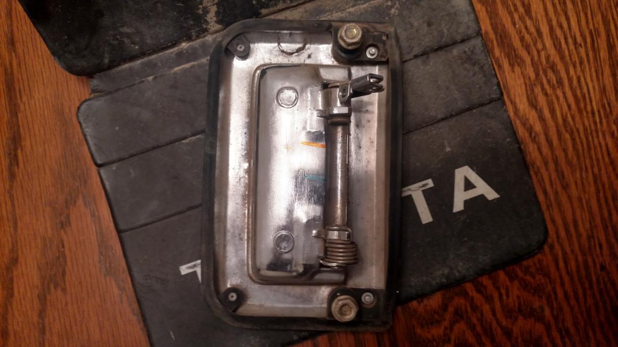

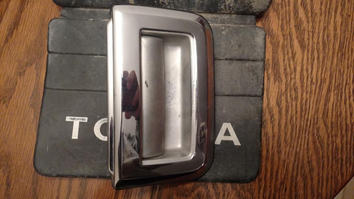

You literally just have to save the handle, it's all self-contained and is a real easy job.
All you have to do is just remove the sliding door panel from the inside of the van and then you'll see that the sliding door handle is held on to the door by two 12mm (10mm?) nuts. First, disconnect the cables leading to the handle and then remove the two nuts and it comes right out.
The whole job takes less than 5 minutes once you get the inner panel off. I don't know if the panel was something you were planning on saving but I imagine that part may be the most tedious part.

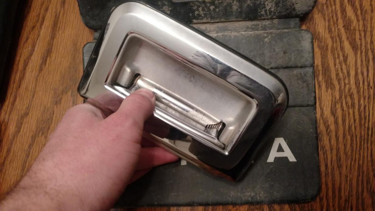

EDIT: Here are the pictures of the handle from my van part out. They'll give you an idea of what exactly you need to pull. The second picture shows you where they typically crack, and the third picture is a shot of the back of it, showing the two nuts (at the top and bottom of the handle) that need to be removed in order to free it from the van.
Attachment 5390
Attachment 5391
Attachment 5392

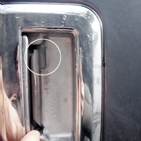

sliding door handle fix down & dirty
like many others i had a long crack forming on my sliding door handle. started with a few millimeters a year ago and spread to a couple centimeters. worse, the handle was flexing so the latch would barely open the door as of late. masked off a small area with tape and put a thin bead of regular 'ol JB weld.
works really well: stopped the crack from spreading and latch feels tight again and no more flex. been a couple months - hopefully a long term fix. can't see the small dark grey weld unless you're really looking while holding down the latch.
so don't wait for that crack to get bigger. handles are getting scarce and it's a 5.00 and 10 minute fix!

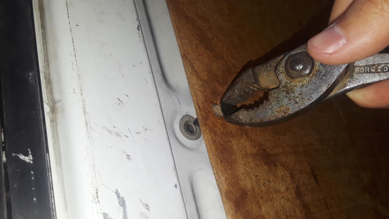

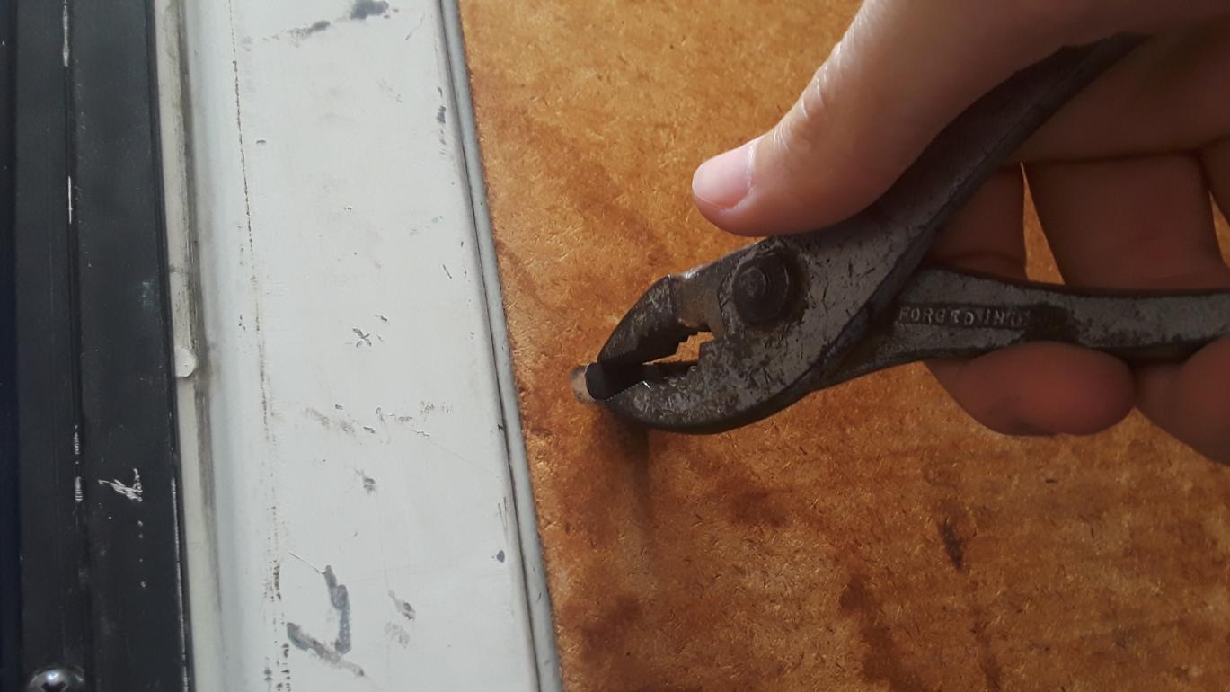

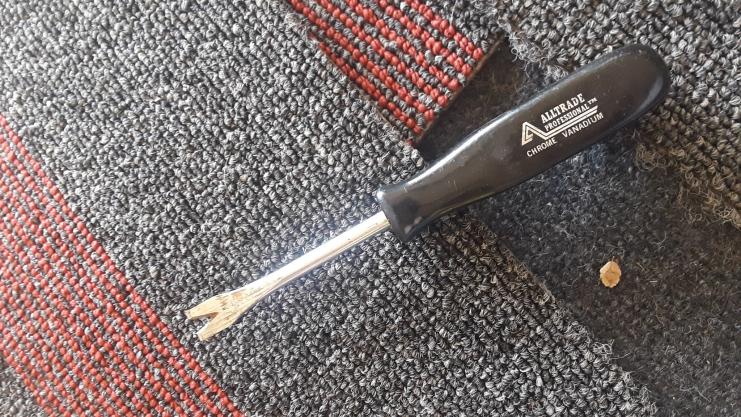

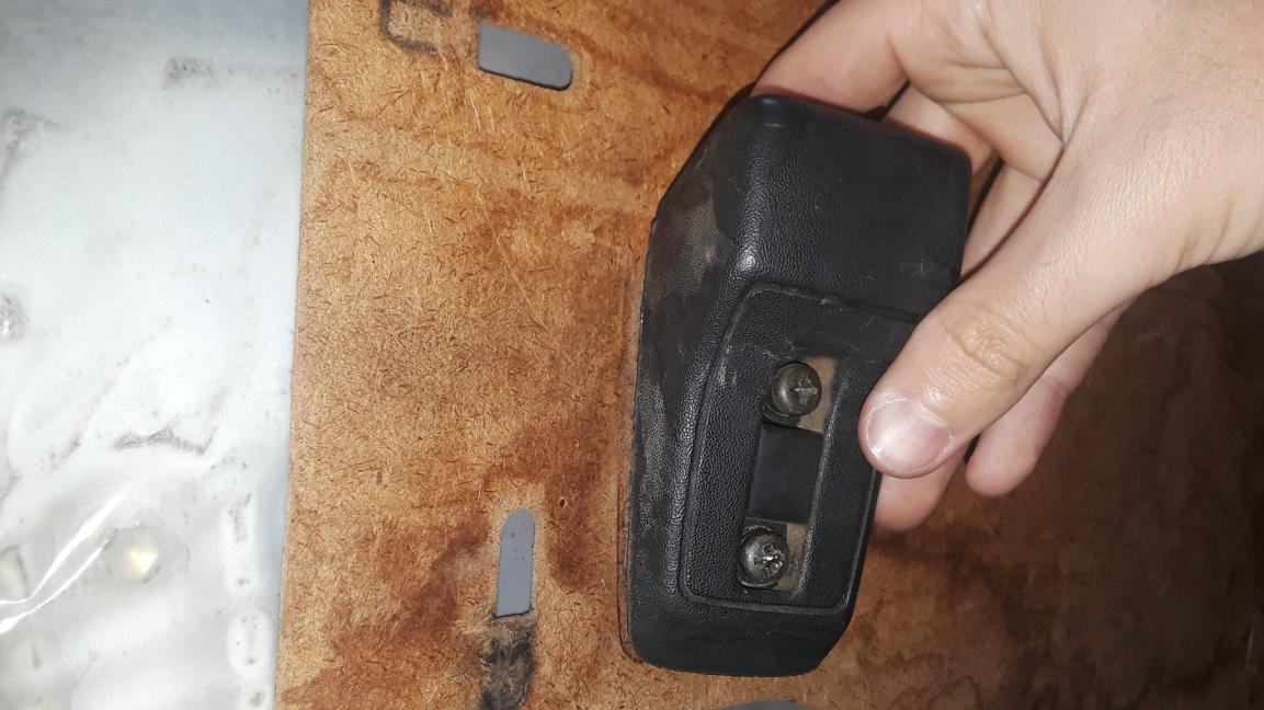

Got the panel off and my side door opening again! :dance1: For anyone else curious how to remove the door panel, it goes a little something like this:
Get some needlenose pliers, a philips head screwdriver, a trim removal tool (strongly reccomend, first picture for refference)or a flathead screwdriverAttachment 12144
First, remove this interior bit which will need to come off as it holds the panel to the door too. Use a proper philips for the job to avoid rounding it out.
Attachment 12150

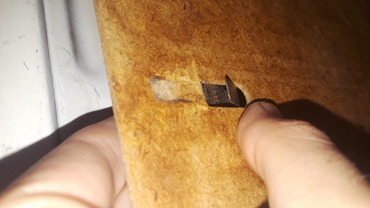

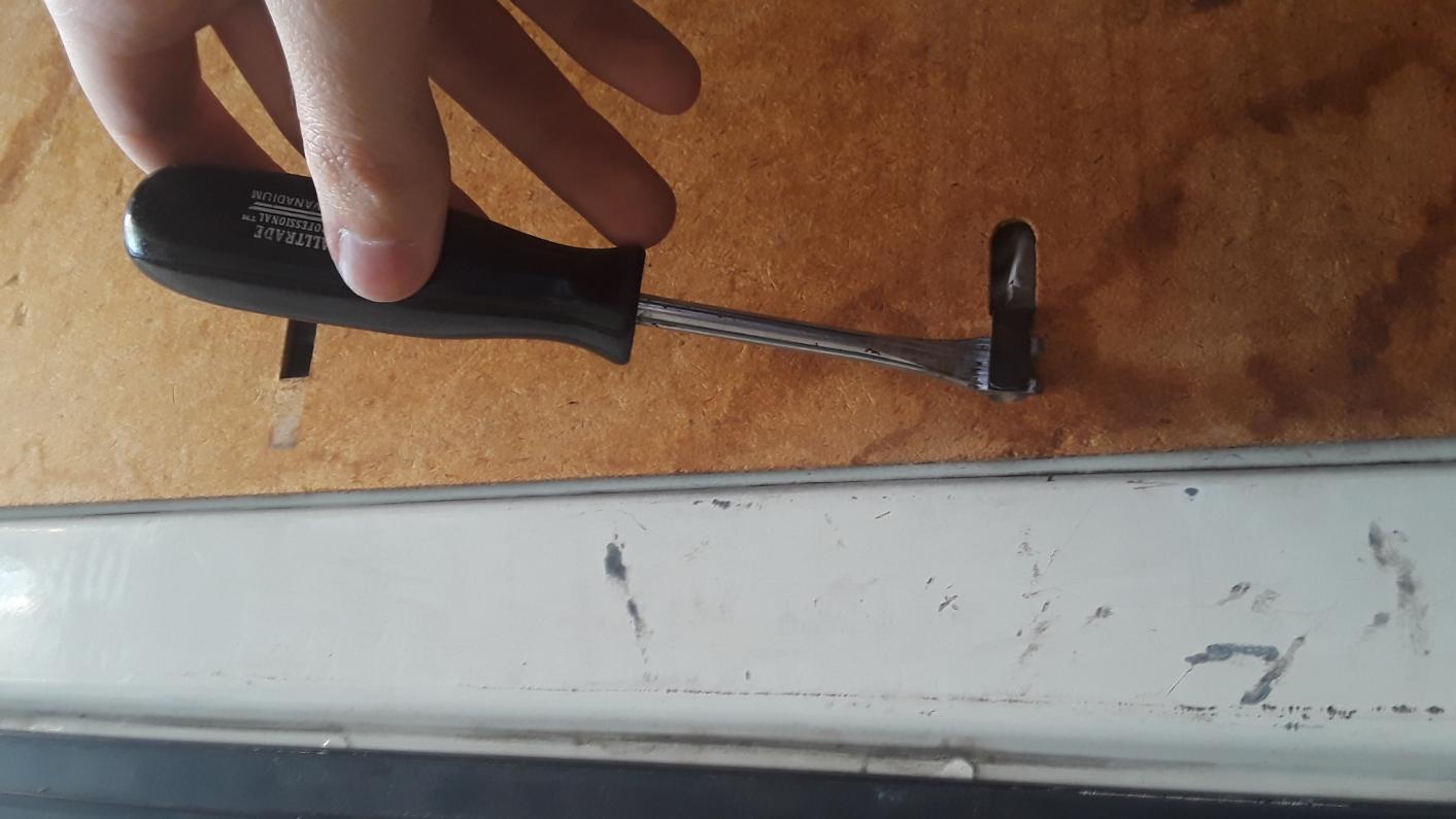

Next, removing the clips gently from the door. I broke two of my top clips figuring out how to in the process so learn from me. Attachment 12145
Using your trim tool remover or a flathead screwdriver, gently wedge it underneath a clip and SLIGHTLY bend it away from the door panel, emphasis on gently and slightly. Do NOT use pliers to bend it more than necessary, as you will probably snap it. To make removing a panel easier, only remove the top and side clips, as the panel will then fall down and out of its slot, no removal of the bottom clips neccessary. i reattached a top clip for demonstration, heres what it looks like removing it:
gently pry a top/side clip like shown
Attachment 12146
behind the panel, each clip sits in a rubber grommet holding it. using your pliers of choice, pull the clip straight out of the grommet
Attachment 12148
Attachment 12147
after this is done, simply slide the clip out of the hole on the panel, and voila! use some needle nose pliers if its tricky to grab with your fingers
Attachment 12149

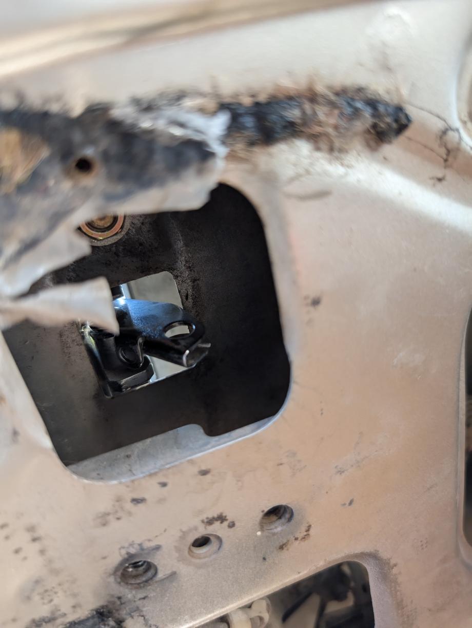

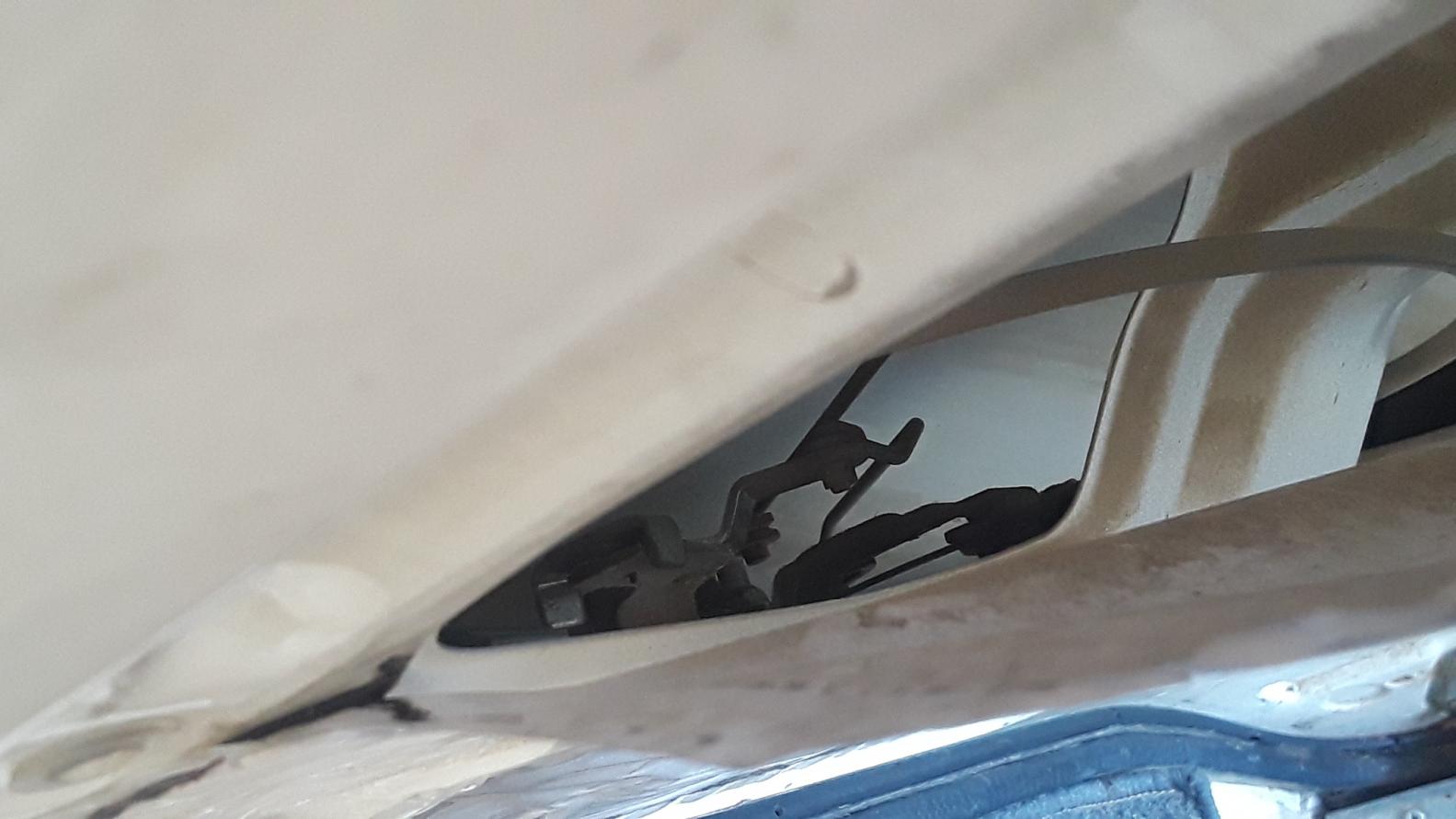

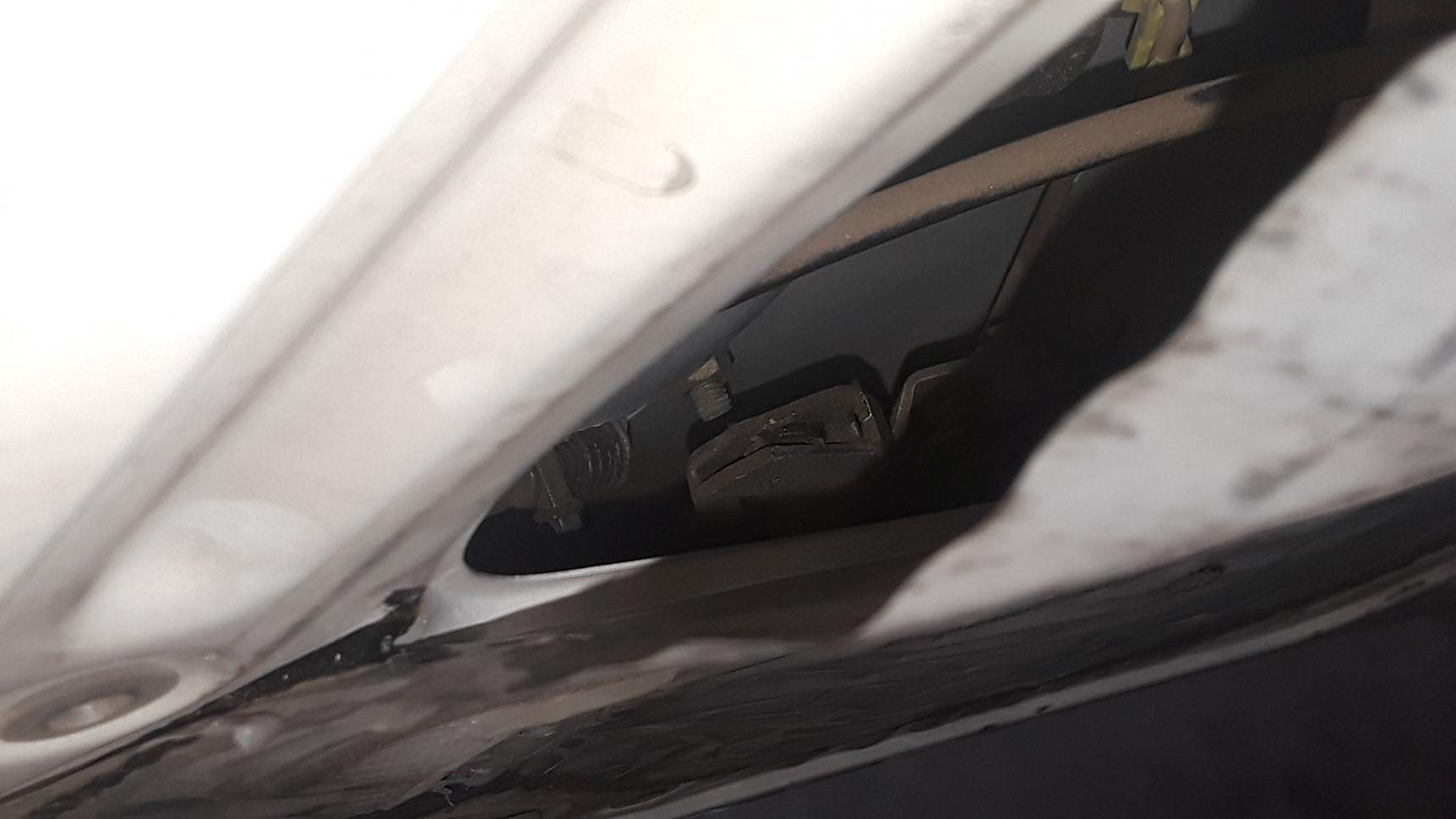

now that the panel is off, there is a piece of plastic sheet for keeping dust out underneath it, now i dont have any heatguns or any method of removal or reinstallation for this so i will look underneath this plastic flap for the handle and lock bits which are here
Attachment 12151
and this linkage is what you will want to pull on! in the second photo; after pulling it, open it and now you should not forget again to leave the child lock on!!!! this linkage here is for the child lock actuation so just pull it towards you to disable it and free your interior handle Attachment 12152

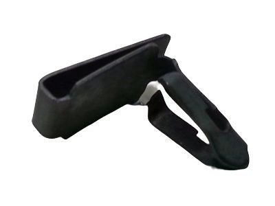

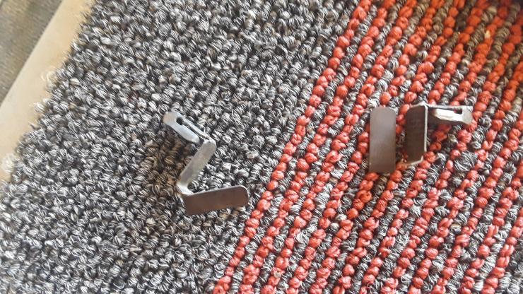

So, here's the clips and grommet part numbers and pictures for those curious:
For the darker, square metal clips (such as the ones I broke) they are "RETAINER" Part # 67771-20022
Attachment 12160
For the lighter colored ones with a division down the middle, they are "RETAINER" Part # 67771-14010
Attachment 12161

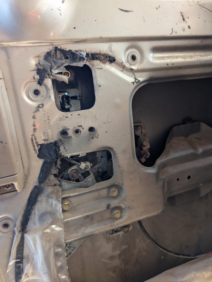

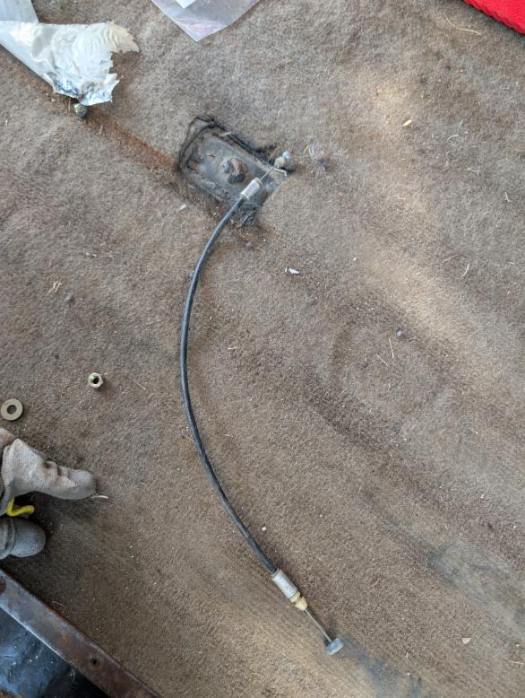

Hey all, I know this is an old thread but I like to keep things of a specific topic together for ease of search on others in the future.
So anyways, I bought a van without a exterior handle on the slider. I bought a handle (Lucky in 2025, I know) but I think I am missing more parts to make it work. Looks like this cable drives it but there has to be clips that retain the cable to the door body or this would not work. I can not find any schematics that show what clips are used or where. Any help would be great appreciated.
Attachment 13340
Attachment 13341
Attachment 13342
Re: Sliding door handle / exterior mechanism
Sort of. Looks like I'm missing multiple pieces.
