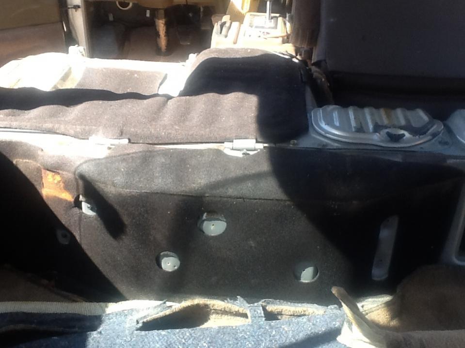

1st step is getting the carpet and heater duct out of the way.

Next I laid out hole location and marked it with a sharpie. Ideally, I would have liked the hole to be another couple inches higher and to the left, but there's a steel vacuum line for the brake booster that is mounted there. Rather than mess with that, I compromised and decided here was the best.

Ah the love hate issue on cutting the walls ...
I think I'll try to convince my woman to use her tiny hands to help me out, har har har. :LOL2:
Re: The hose of death thread
It can be done without cutting. When the valve cover is off it opens it up enough, but it's hard to see and easier to make a mistake. With the access hole it can be done easily and the metal pipe/nipple can be inspected. I consider the cut wall a non-issue as it's covered with a heat duct and carpet (no one will ever see it except maybe a mechanic). Tim
Yeah I would probably probably fab out a nice latch and hinge so no screws necessary.
Is the valve cover just a rubber gasket, if so sometimes I wouldn't mind taking the cover off to get at a hoke easier. (As long as you over it from debris :lol:)

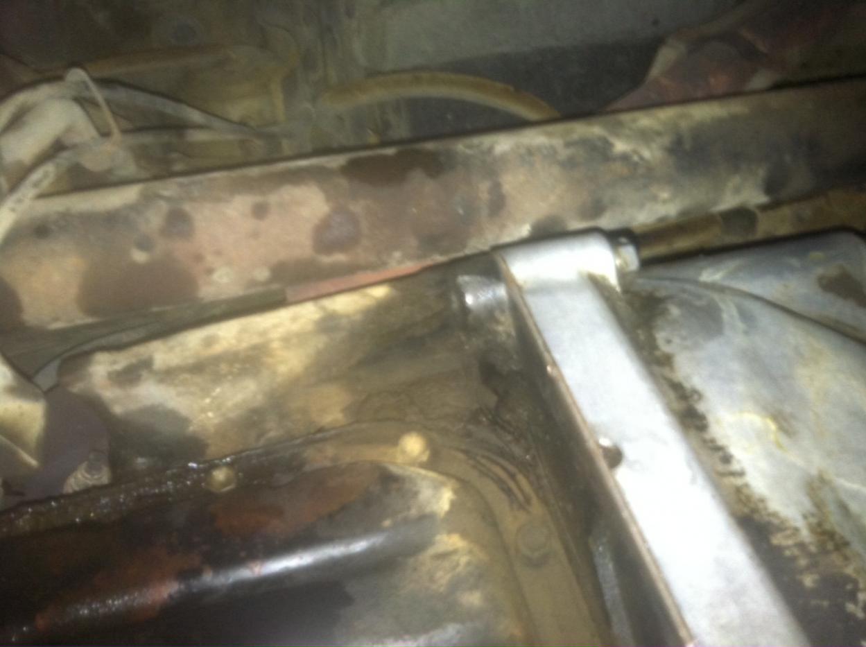

Hose of Death change (leak from ... transmission?)
I got a big surprise yesterday when I pulled away from my house and noticed a big oil stain on the ground (bigger than usual I guess). So I parked in the garage this morning so I could see if it was me. Another 2-5 oz's of oil leaked out on my cardboard oil catcher. As best as I can tell right now it is coming from a weep hole at the front of the housing. I went through my chiltons manual but its worthless. Any thoughts? Also, I have a slow leak at the back of the transmission pan. I changed the pan gasket but it continues.... Is there a seal just above the rear of the tranny pan? Thanks for any input. Cirrus
In the photo its the small hole on the only clean area.
Attachment 847
Re: Hose of Death change
It could be coming from your rear main engine seal or from the transmission input shaft seal. If it's red and thin, then it's the transmission. If it's thicker and brown/dark brown, then it's probably the rear main engine seal. If you can't tell, take out your dipsticks and put a drop of oil on the cardboard next to the drip that's there. The one that matches the best will be the culprit. Either way, the transmission or engine has to come out in order to repair. The other option is to carry around extra oil/transmission fluid and top off regularly :dizzy:. Tim
Thanks for the reply Tim. Spent some time looking when I got to work. It's engine oil, coming from up high, runs down the left side of the bell housing where the tranny meets the back of the engine. Kinda through me for a loop cause all my fluid levels are good and this is new leak. oil spot on the ground is 1 foot by 4. Crankcase has gas smell but oil may need a change. I am trying to get it into the shop to have them look at it. Hoping I didn't buy a basket case!
one last thing, it seems to leak right after I shut the engine down for maybe 5 minutes
I have another update...... I think it's coolant. Because it was golden in color I automatically thought it was oil. Radiator light came on so I smelled the drip and it smells like coolant. I thought it was supposed to be red. Anyway, it's coming from the top rear, maybe head gasket? Are there any coolant hoses back there? I can't see any. Thanks!
Ok I think I have it located..... Small pipe (1/4- 3/8) coming from above left side and crossing the back. Where it goes through a bushing looks like its worn through and leaking. Hard to see in the pic ( in between the 2 bolts). I imagine its a bear to get to?
Edit: Brake Line?

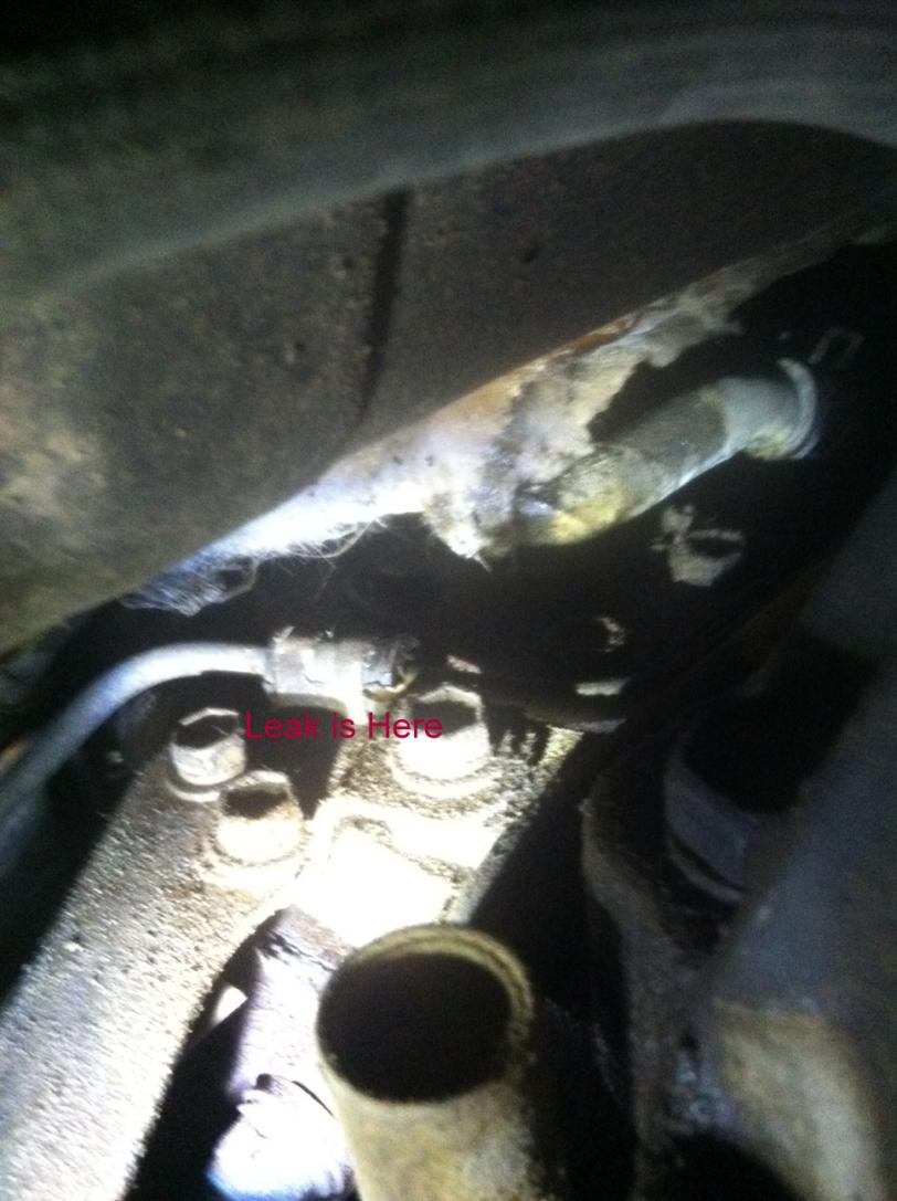

Hello All,
This morning as I was parking my van at work I could smell evaporating coolant. I looked under the van and it was spraying coolant all over the parking lot.:(:.
A first I thought the head gasket blew, but on closer inspection it looked like it was spraying out of the side of a hose. (Please see the number marked 1 on image. Hope you don't mind me using that image). I think the metal pipe next to it melted through the coolant hose.
Attachment 2619
What size hose should I use to replace it? Also I notice that clamps are used, should I do this as well?
Also, while under there I notice the bolt that attaches to the intake manifold missing (2).
Well this is not specifically the hose of death, but related i guess.
It was as I suspected. The hose was melted by the EGR metal tube. Melted right through it. I was able to pick up some 5/8 heater hose rated for +350' F / 60 PSI and two new clamps at NAPA. Removed and installed all during lunch hour.:dance2:
Hopefully that solves the problem.
That should solve it. These hoses get fragile when they get old. If the EGR is getting hotter than it should, that's a sign of a failing cat converter or the timing being off. It could also be a problem with your electronic advance............or could simply be a poorly routed hose. Just thought I'd throw some other possibilities out there as food for thought. Tim
