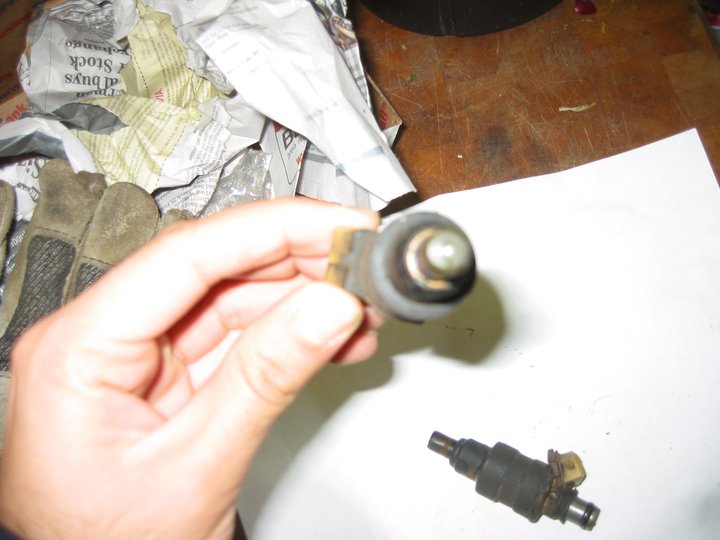

So I returned my injector that belonged to an 89 and they sent me 1 that looks like this and smells awful lol.
Attachment 273
and it is Part # 23250-45011
It does not match up with the one that is on my van. So what do I do? Would this one work well?
Re: Video of Van Running After Engine Rebuilt HG Replaced.
Who knows. The Toyota part number for the injector you need is 23209-45011. I have no idea what differences there might be with the one you got. Sounds like these guys are just wasting your time. If these were easy to change I'd probably try it, but considering what a PITA they are to change on a van I'd insist on the correct one.
Regardless, you will want to have all the injectors cleaned and tested prior to putting them back in. Since you'll be doing that anyhow it might be worth having the injector shop look at it to see what they think. As long as it's interchangeable, has the same resistance, and flows the same rate, then you could use it. I'd trust whatever they tell you as they are the experts. You sure are going through the ringer on this one. I hope you get it figured out. Tim

UPDATES: PROBLEM SOLVED
Got another mechanic to take out the Fuel Injector on Cyl 1.
Turns out the part # was actually 23250-45011
I still had the spare 23250-45011 part from the junkyard so I had them put that in. Once they put it in and connected everything back together the van was still running on 3. They played around with it more and found out that the connector on #1 was messed up. The two wires were not connected like they should have been. It sucks because the other mechanic tested this with an injector connector kit and completely ruled it out. This other mechanic had no kits but just moved the wires around and found out that while moving them the RPM was jumping up and down. I wish I had known this before because it turned out that my injector was fine after all!
My injector came out looking nice and clean but the one I put in there looks like crap. Probably has been sitting for a while. The van now runs on 4 cylinders but backfires a little bit. Im suspicious about this new "used injector" I put in. I hope when I add a bottle of BG44K stuff it smooths it out.
