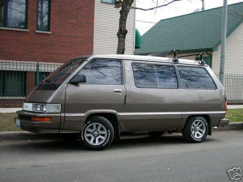

Re: Urgent need for advice on space van wheels
Benjie,
what size tires are you running of those rims? I have the supra rims but haven't splurged on the tires cause I still haven't figured out which tire to use.
In in the mean time check out these pics- Cressida snowflakes, Cressida 9 spoke, Celica GTS 4 hole, and baby Supra-
Attachment 2010Attachment 2011Attachment 2012Attachment 2013

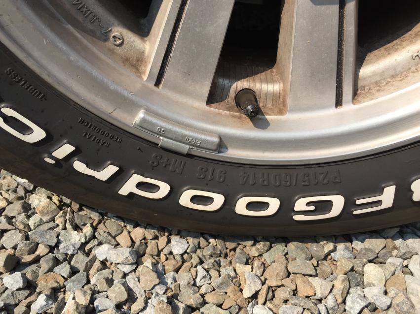

My rims are the last picture it's dark so I can't see but I'm pretty sure the tires are 225 60 14 just keep in mind not to many tires in a 14". I've been looking for 225 or 205 50 14 can't find them when your looking tell me if you run across some. I think that would be the perfect tire for those rims
I had a 85' Celica GTS 2dr Cpe that I had found some used BF's I put on the rear which were 245 60 14 and the front I had used Mastercraft 225 60 14. I know it's hard to find those tires or they are really expensive.
The 225's don't rub on the sliding door when you open it? I had read on some previous posts that 205's were the widest tire to use?
If I see anything on sale or close out I'll keep you posted.
I have Kumo 205-70-14 on MA61 (baby Supra). Sliding door clears the tire by 1 millimeter.
