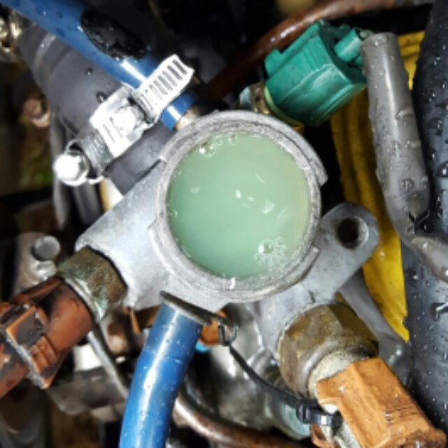

The coolant does look foggy...there are also little white deposits. What would that be though? I do have a new cap and flushed with vinegar awhile ago.tried to upload a picture but couldnt. If its the head gasket, doesnt it overheat because of lack of coolant (from an internal leak)? My coolant was nearly full. Topped it off and gonna test drive.Attachment 3848

If there was any oil in that frothy green coolant, it would be an obvious head gasket. The color is indicative of an issue.
I use the Toyota red coolant in all my Toyotas.
