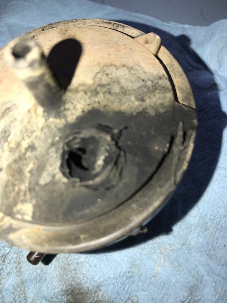

Thanks for the part number. i pulled my throttle body today and found this:
looks like somehow this got disconnected (assume by PO when he did some work on it) and it melted a hole

I still have one of these lying around if you wanted it, otherwise JPERL is on to something here and you could probably use a bunch of different modulators and get away with it.
Re: EGR vacuum control solenoid modulator
Appreciate the offer, i actually think ill try one of those new replacements JPERL mentioned and see how it works. looking at the photo it looks identical so ill give it a try!

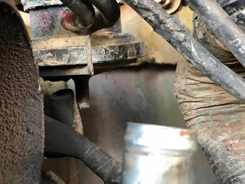

Ok, maybe I didn't use the right term exactly, but there was most certainly distinctions made between CA and non-CA vehicles, even back in the 80's. Here is a picture of the emissions label sticker on my '86 2wd:
Attachment 10118
This van has the EGR PN 25620-73010 on it (as denoted by a rectangular blue sticker on the side of the EGR valve). This is the emissions label sticker on my '88 4x4:
Attachment 10119
Which specifically emphasizes that it conforms to California regulations. It's also labeled as a "4Y-E CAL 4WD." The EGR PN on this one is 25620-73070 (as denoted by a round yellow/green sticker on top of the EGR valve).
What that means for compatibility, :?:. I still can't determine if the difference in part numbers is due to 4wd vs 2wd, California vs non-California, or some other reason. If some other members here were willing to pop open their hoods and take a quick peek at the emissions label as well as the PN on their EGR valves (easy to find without removing any parts), we could probably solve this mystery in short order.
