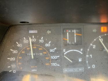

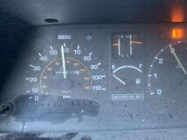

Hello Tvt. I own two vans but one is giving me fits. I’ve replaced head gasket. Water pump. Hoses. Fan clutch radiator flushed and cleaned and oem thermostat. I bought this OTC flush tool to blow out sediment in block and heater core. Flushed out at least a cup full of sediment. I highly recommend this tool. To flush system I cut a cheap thermostat so there was no restriction and I’d get a good seal.
I tried to insert photos but not sure if they loaded sorry. So I ran van with gutted thermostat and she ran nice and cool but when I installed new oem stat van temp gauge runs a little north of half. I’ve taken temp readings and van coolant stays nice and cool without stat 130 with stat 190- 200.
I’m at my wits end with this van
Attachment 9047Attachment 9048
this is temp with thermostat and without

My other van runs just south of half way on the temp gauge. This is my daughters van and I would hate to have to do head gasket again. Previous owner gave me old work orders and it was running hot after the last head gasket job. I thought I figured it out when I was able to flush all the sediment out of block but it’s reading the same temps.
Thanks for helping. I’m at a loss to what to do next.
The important thing to consider here is that you are putting a lot of faith in a 30 year old gauge and possibly a 30 year old temperature sending unit. If you really want an accurate temperature reading you'll want to install a good quality aftermarket gauge. And 195-215 is considered normal for most engines.
