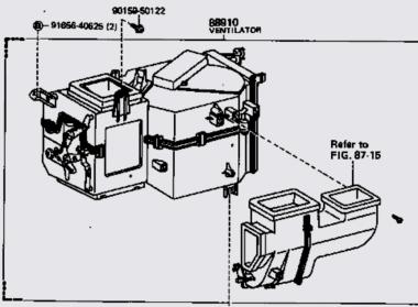

Chilton's manual refers you to the section on removal and disassembly of the cooling unit b/c they are integral, not separate assemblies (But there's no diagram, just the text I posted above). That procedure starts on page AC-39 of the 87 van manual and includes a diagram. There may be extra parts not in the diagram. Strange they don't mention heater core specifically.

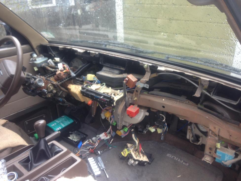

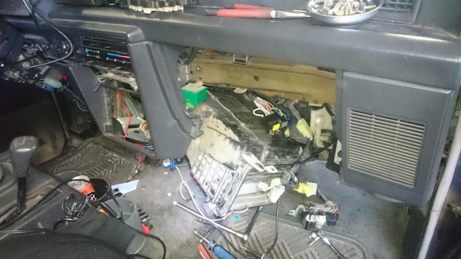

I removed a heater core earlier this year and let's just say it's a good thing I didn't have to put everything back together again. I was after the fuse box that was in immaculate condition out if a 87' cargo conversion van that only had 187k miles, once I was in there and I decided to go all the way and take everything apart-
I removed the-
1) dash pad
2) stereo bezel
3) fuse box
4) heater controls
5) all the vent tubing
6) some big black box thingy?? And behind that buried deeeeeep was the heater core.
I took pictures but my hands were a mess and the pics didn't come out that clear.
Check it out-

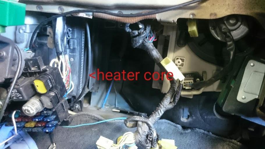

Unlike the rumors in the manuals, the heater core is not integrated into the a.c. Evaporator.
So i was able to remove my heater core and leave the dash pad in.
The heater core is not integrated into the AC evaperator housing. It is behind the Radio.

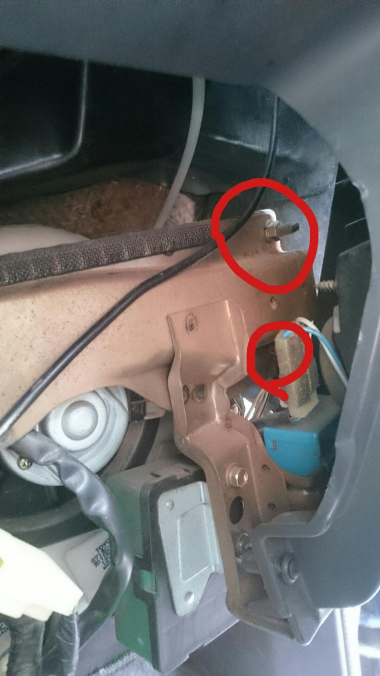

In order to get the AC cooling unit out, I removed 2 bolts holding the metal bar. Those 2 bolts are above the passenger side speaker.

The AC unit is only held by 2 about 2 bolts, 1 on the bottom, on on the top front.
Roll the top of the unit down toward you to get it out.

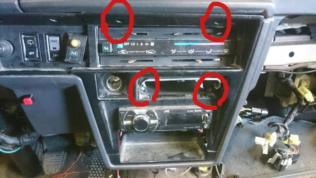

remove the center console, and radio. There is a black triangle shape piece of metal held by to screws on the passenger side i removed as well. This gave a lot of wiggle room and visibility for the following steps.
Attachment 3203
I forgot to get pictures of removing the fuse box. There are about 8 plugs, I'm pretty sure they are all proprietary.

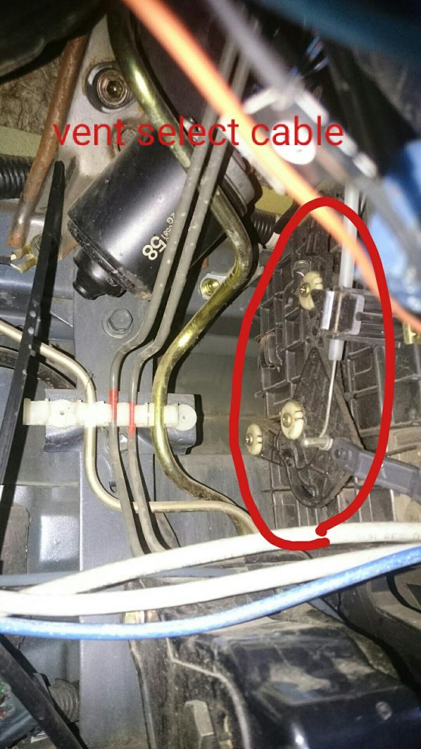

2 cables are attached to the heater unit.
1 on the drivers side for the vent select.

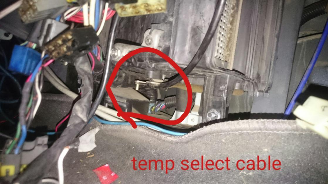

1 on the passenger side, on the bottom for the temp control.
Attachment 3205

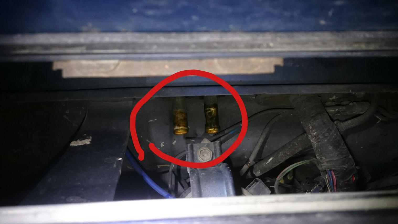

Here are the heater core hose connections. I like to pry them down with a pry bar from in front of the bumper.
Attachment 3206

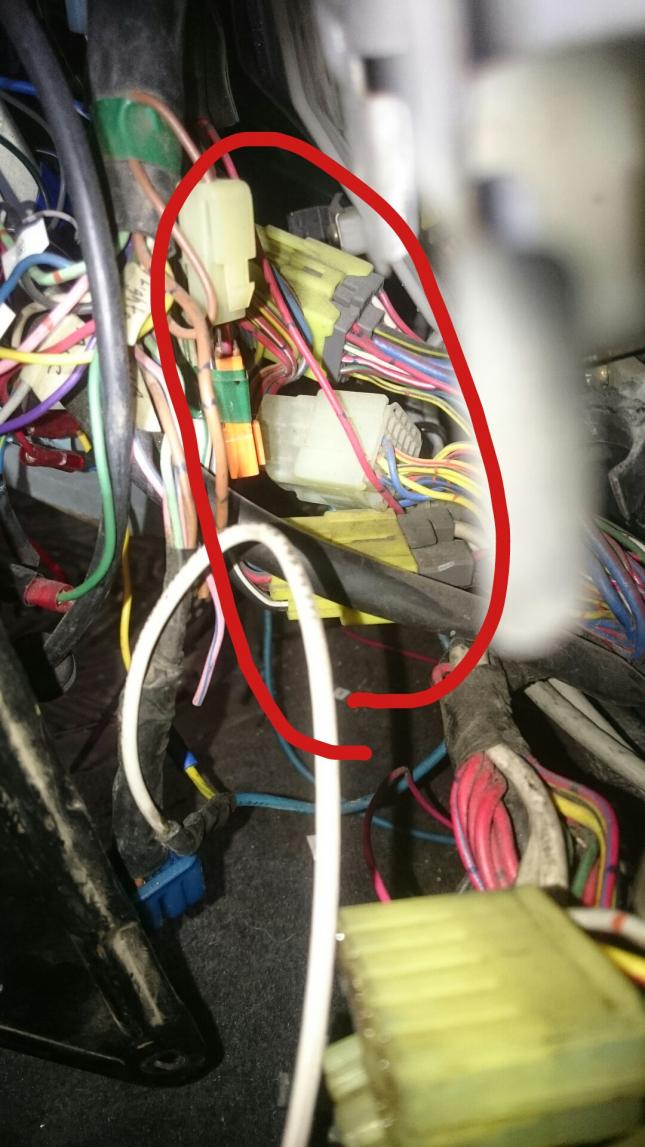

The Dash harness need to be separated from the chassis harness, behind the radio.
Attachment 3207

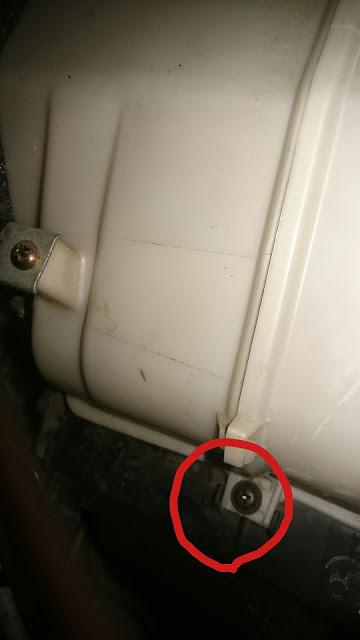

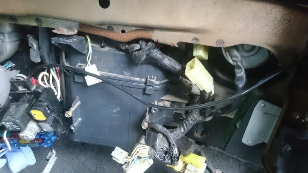

Here is what is left. The heater core housing is only held by 1 nut on the bottom right. and 1 screw on the left above the gas pedal.
Attachment 3216
I rolled it down and out like the AC evaporator housing.
Attachment 3217

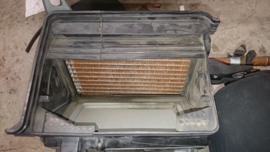

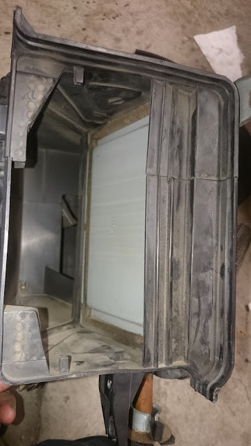

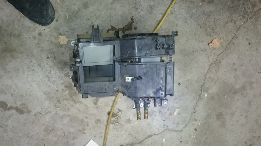

Here is the heater core housing removed. To split the case there are a few screws and several metal clips. Make sure the metal clips don't go flying across the room.
Attachment 3218

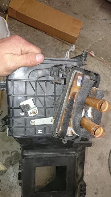

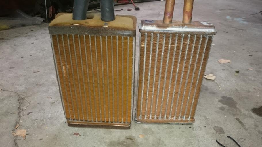

I ordered a STANT 90609 from rock auto. It fits but its not as thick. And does not come with foam.
Attachment 3219
It looks like APDI/PRO 9010177 would be a better choice as according to the dimensions listed.
https://www.rockauto.com/catalog/moreinfo.php?pk=3607236&cc=1279784&jnid=448&jpid=0
I happened to have 3/8 thick weather stripping that worked perfect.

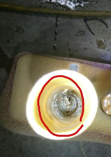

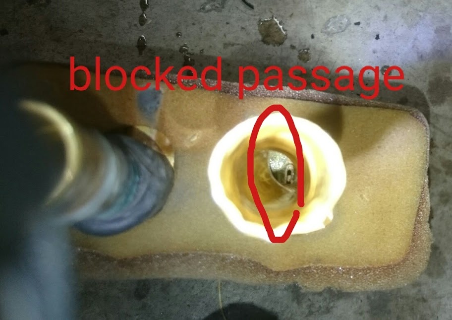

Here is the cancer in my old heater core. I have back flushed and vinegar washed my cooling system about 3 times since i have owned my van (7 ish years). And I always use distilled water when filling the system.
Attachment 3220
Attachment 3221

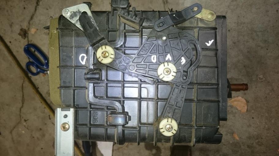

On the other end of the box is the vent select controls.
F = Floor
V = Upper vents
D = Defrost
There is a lever in the white ducting as well that connects to the vent select linkage. I cant remember what is does.
Attachment 3225

I just got a van that has no heat (and it's still really cold in the am here)... it was running on the cool end (about 20% up the gauge at idle after warmed up) so I thought maybe it was the thermostat stuck open... replaced the 'stat - no change in hot air temp (the van is now running a little warmer, closer to 35-40%, the old 'stat gasket was shot). I pulled the hoses and back-flushed the core and there was some really really dirty, rusty sludge that came out and the flow-rate was terrible. The water cleared up eventually but the flow-rate remained minimal. Pulsing helped dislodge more dirt but after 1/2 hour the flow-rate was still meager in reverse flow and non-existent in forward flow. So I ordered a new core which should be here this week. My question is, can I just install it and roll or should I flush the entire system (or part of the system) to protect the new core :cnfsd:. The coolant looks good in the reservoir and the stuff that came out when I changed the thermostat looked good. The PO changed the coolant two or three months ago.
Thanks for any advice.
I would drain the coolant and pull the thermostat. Put in 1 gal distilled white vinegar + distilled water. And drive it that way for a day or 2. (so long as you don't have a freeze risk)
That will loosen up scale in the engine and radiator.
Then flush it forward and backwards.
Don't forget to use the block drain behind the alternator.
If the thermostat is closed the chunks wont come out while flushing with cold water.
Unless you flush with HOT water directly from the water heater. Be careful.

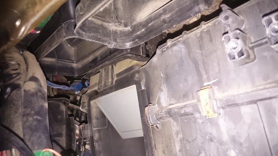

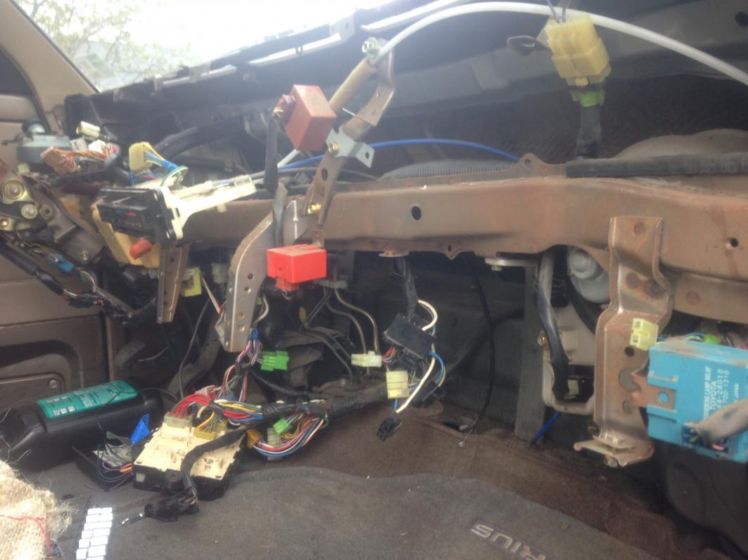

So I ended up taking everything out.
Attachment 3439 Here it is in progress.
My hands were not nimble enough to be as surgical as coronan.
I ended up pulling all of the duct work while I was in there. It all seems straightforward enough to reassemble (after it all gets cleaned up) and the new heater core fits nicely.
Attachment 3440

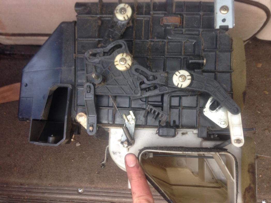

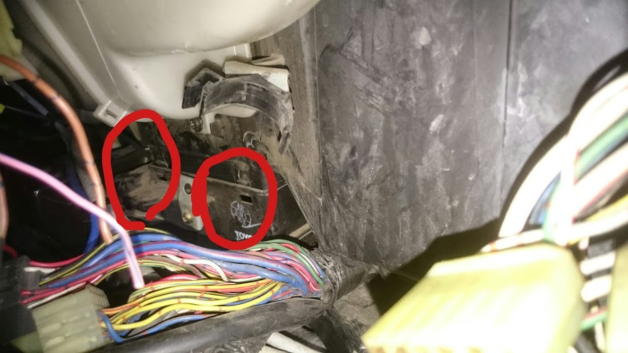

I do have one hurdle to clear before reassembly... the linkage on the left (driver's) side of the heater core housing (see last photo in coronon's write-up) has one spring that seems to somehow connect to what he refers to as the "vent select linkage". This spring is broken and I'm not sure where one end of it attaches. The exploded diagram I viewed was not detailed enough to show the linkage assembly or spring.
Attachment 3441
Attachment 3442
Any body have an idea where this spring goes or how to get a replacement?
Cheers,
Daniel
I don't believe the "spring" is broken. I should mate with the white damper arm.
I Marked it in red.
Attachment 3443
So just pop it in there?!?
That would be the greatest fix ever!
Thanks, I'll check it out when I get home.
