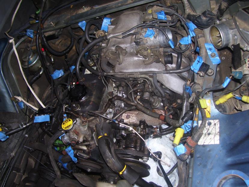

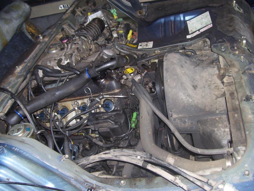

I think I'm about ready to remove the old engine, only thing holding it in place is the tranny and motor mounts, I think.
Last week I disconnected the downpipe from the muffler pipe. Yesterday I disconnected about 23 electrical connections and labeled every one of them with blue tape and sharpie(I don't have a photographic memory), here's a picAttachment 303. Today I disconnected the clutch "slave" cylinder, fuel hose into the filter and fuel return line- all three lost fluid and I plugged them with some caps from the auto store just about the time they stopped pouring out fluid. Also unplugged the o2 sensor today.
Now I need to get to work on the new motor, replacing hoses(of death!) and water pump and a few more to be determined.
I still have a question about the '89 engine and it's having two o2 sensors(i'm feeling a bit dense, sorry) So if it's an '89 it should have a second o2 sensor on the exhaust manifold hereAttachment 302? So if it doesn't(and it doesn't) then maybe not an '89? Does anyone know how to find the year of the engine based on the engine stamp? I'm definately doing a leak down test on this engine before installing.

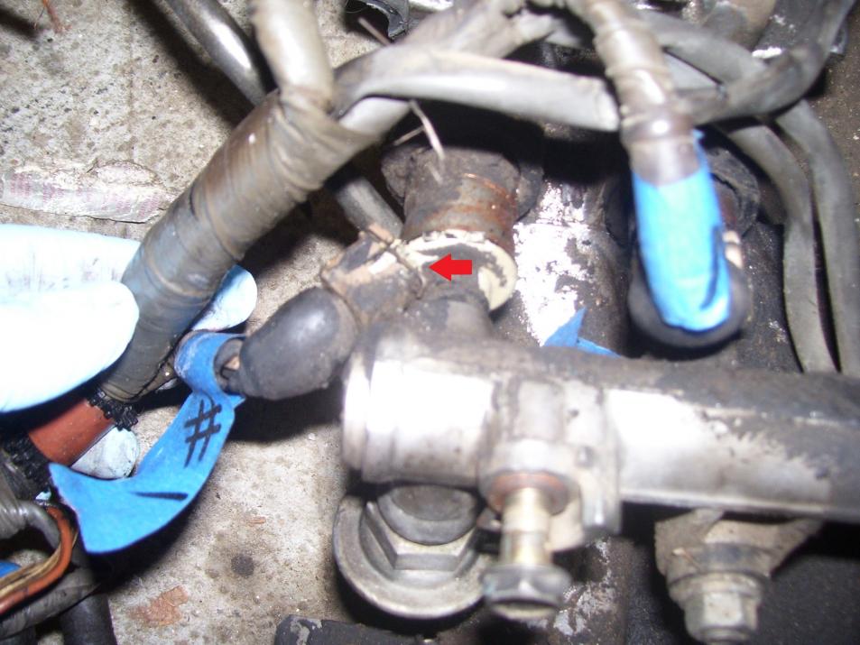

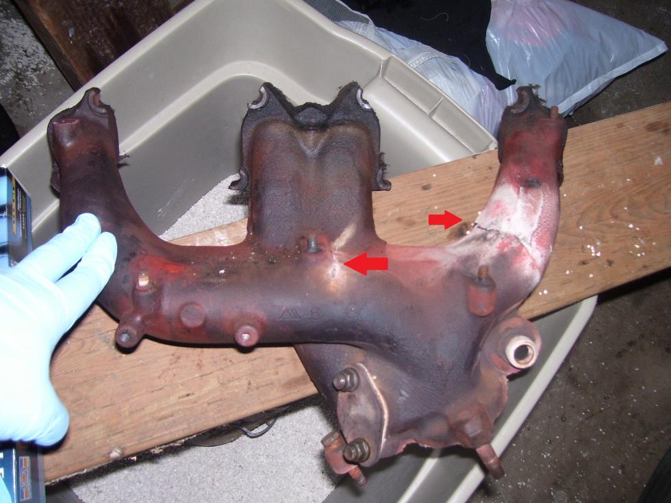

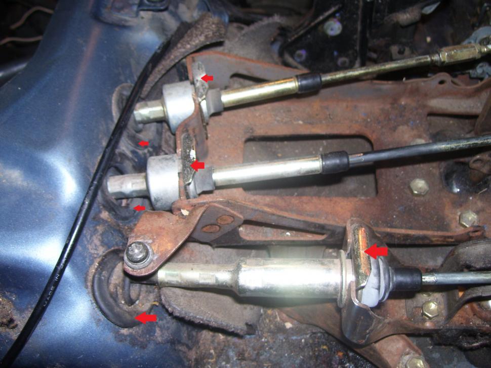

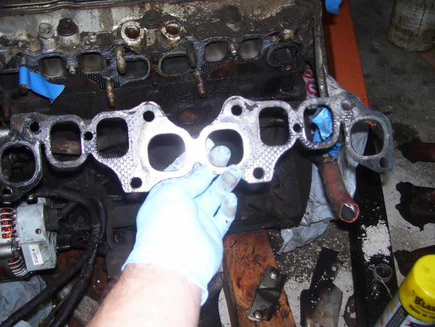

So I took the motor out a few weeks ago:) and that wasn't the worst thing i've ever done(Pic 1). I may have busted a couple sensors and hoses in the process but that is normal, isn't it?
Now I am taking off the manifolds on the older motor and although TimsRV said just swap the injectors as a whole, I started removing the electrical connectors(oops-i meant to listen) and three of them broke on one tiny corner in the process. They still connect but are a bit loose and the metal clasp/holder touches the injector-so do I replace them or just let 'em move around a little bit(Pic 2)?
None of the exhaust manifold bolts were broken, wow, even with at least 2 cracks in the exhaust manifold. The crack on the right exhaust port with the red arrow goes all the way around the pipe and is about to fall off(Pic 3)-that thing is toast! From reading the other manifold replacement threads I think I will replace the old manifold bolts while it's so accessible.

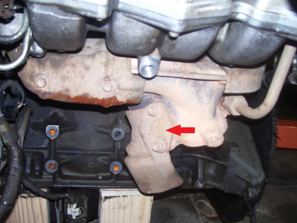

Now here's a tribute to the Toyota gaskets and why you must always buy Toyota(Pic 4)-The original Intake/Exhaust gasket was in good condition when I pulled it off. Look how dirty that motor is!
Next thing I need to do is order all the gaskets, and some hoses, and remove and replace clutch parts. I'm starting to wish i'd just gone with the straight engine swap(from an '86/'87), or even rebuilt the engine. This is a big job and i'm not even sure of the actual miles or health of the newer engine- it could be trouble once I get it back together. It does look much cleaner and the exhaust manifold looks solid, so maybe it is better?

Get the new gasket while you can, crush gaskets are usually one time use only. :clap:

Too bad your connectors got messed up. I wouldn't recommend running with messed up injector connectors.................especially the rear ones (it would suck having to split your intake manifold later just to push a loose connector back on). If you end up using Bosch injectors those connectors are easy to find at salvage yards. Many makes and models of vehicles used those connectors in the 80s, so finding should be easy. If you use the inverted Denso injectors then they will be harder to find. To my knowledge, those were only used on the vans and on some Suburu models in the 80s and 90s. Due to high engine compartment temps, I would avoid taking these type parts off a van. They hold up well on other models though so used should be fine. When you splice these onto your existing wire harness you should solder and shrink tube. Butt connectors might work but IMO they are not suitable for long term use in this location. Tim

Thank you Qasual, I will not be re-using any gaskets-I just wanted to show how well the toyota ones are made, although I don't know too much about gaskets to begin with.
Thanks Timsrv for the info and I'm not too bummed because I have the bosch style(square ones) injectors and it seems they really are everywhere. Pretty sure they're called the EV1 style and I've found the connectors new on ebay, 6 for about 20bucks. The question is, do I get used in good condition from the junk yard(5$)- or new, possibly aftermarket ones from ebay? I'll also be sending my injectors to washington to have them cleaned and tested-why not when I'll be doing all this other stuff anyway.

I have replaced injector connectors on two vans with Bosch part number:
1 287 013 003-000
you can search by that part number at the autohausaz.com site. What is cool about the OEM Bosch part is that you get the boot and terminals so that you can build the new connector at the end of the wire and not have to splice.
Rob
1287013003
http://www.autohausaz.com/secure/Par...1287013003.jpg
Bosch OEM
Fuel Injector Repair Kit; Terminal Repair Kit For 2 Prong Bosch Injector Type Plug
Miscellaneous usage as required, please verify plug on existing parts. For repair of female harness plug, for attachment to 2 pin male prong fuel injectors and similar 2 pin Bosch connectors. Kit includes 1 terminal with wire spring clip, 1 boot and 2 wire ends (female).
Re: replacing engine, need help
Thanks Rob for providing that information. I agree genuine Bosch new connectors would be the best. Depending on condition you may be able to pop the old terminals out of the broken connectors and slide them into the new plastic parts (easy). If you cut the old terminal ends off you will need to crimp the new ones using the correct crimping tool. It's a ratcheting type with a die specific to this type terminal (will cost between $50 & $75). Tim
thank you Rob! that is very promising. I am now leaning towards this new direction. i've soldered electrical components but would rather not trust my abilities within the intake/exhaust manifold heat zone. the aftermarket Bosch(style-made in Taiwan)only have about a 6-inch lead and that won't really get me out of the woods.

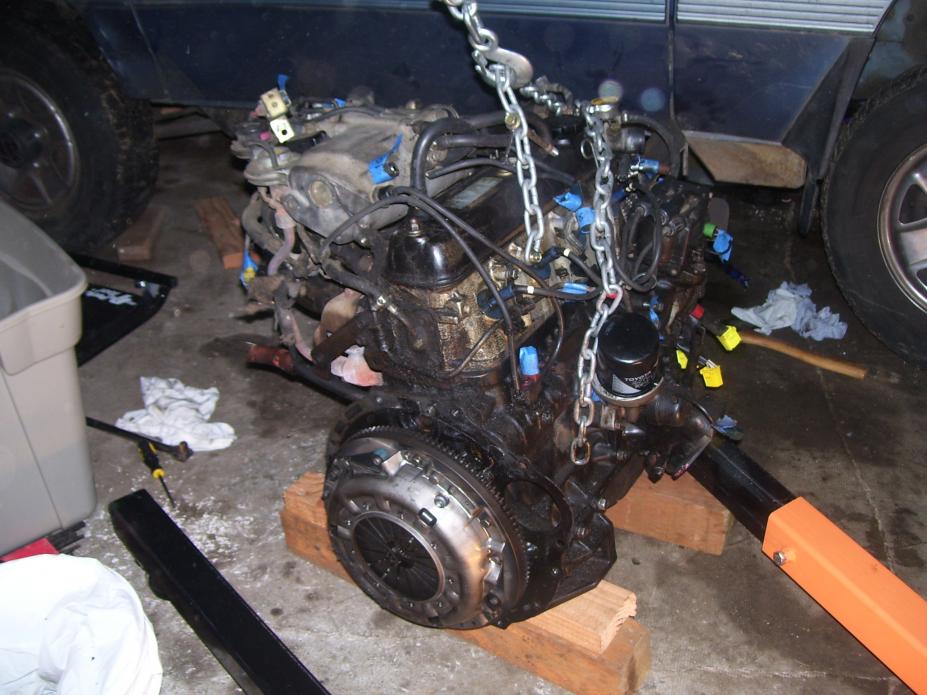

Making a bit of progress while I await my delivery of electrical injector connectors and other parts: I removed the clutch and flywheel from my old motor and swapped the flywheel onto the newer motor- My first clutch job! The flywheels use different bolts(bigger on the manual) and the auto has a couple extra spacers but it's pretty easy to figure out.
And I hammered the pilot bearing into the hole-using a 1-1/4" wood dowel that just happened to be sitting on my garage floor and fit the job perfectly-with a tiny bit of drilling out the inside so the force was focused to the outside of the bearing.
One question: Is there a torque spec for the flywheel? I didn't see one in the manual, so do I just use the impact to torque the 6, 17mm bolts down? There is a spec for torque-ing down the clutch disc and cover but that was it.
Here's a pic of my new pilot bearing half-way installed with my DOWEL, THE INSTALLER, and the auto-flywheel is laying on the ground with it's spacers.Attachment 360
And this next pic is with the manual flywheel installed:lol: and the auto flywheel on the ground, feeling neglected:cry:.Attachment 361
Looking good! The flywheel to crankshaft bolts torque spec is 61 ft lbs. The pressure plate bolts are 14 ft lbs. Tim
