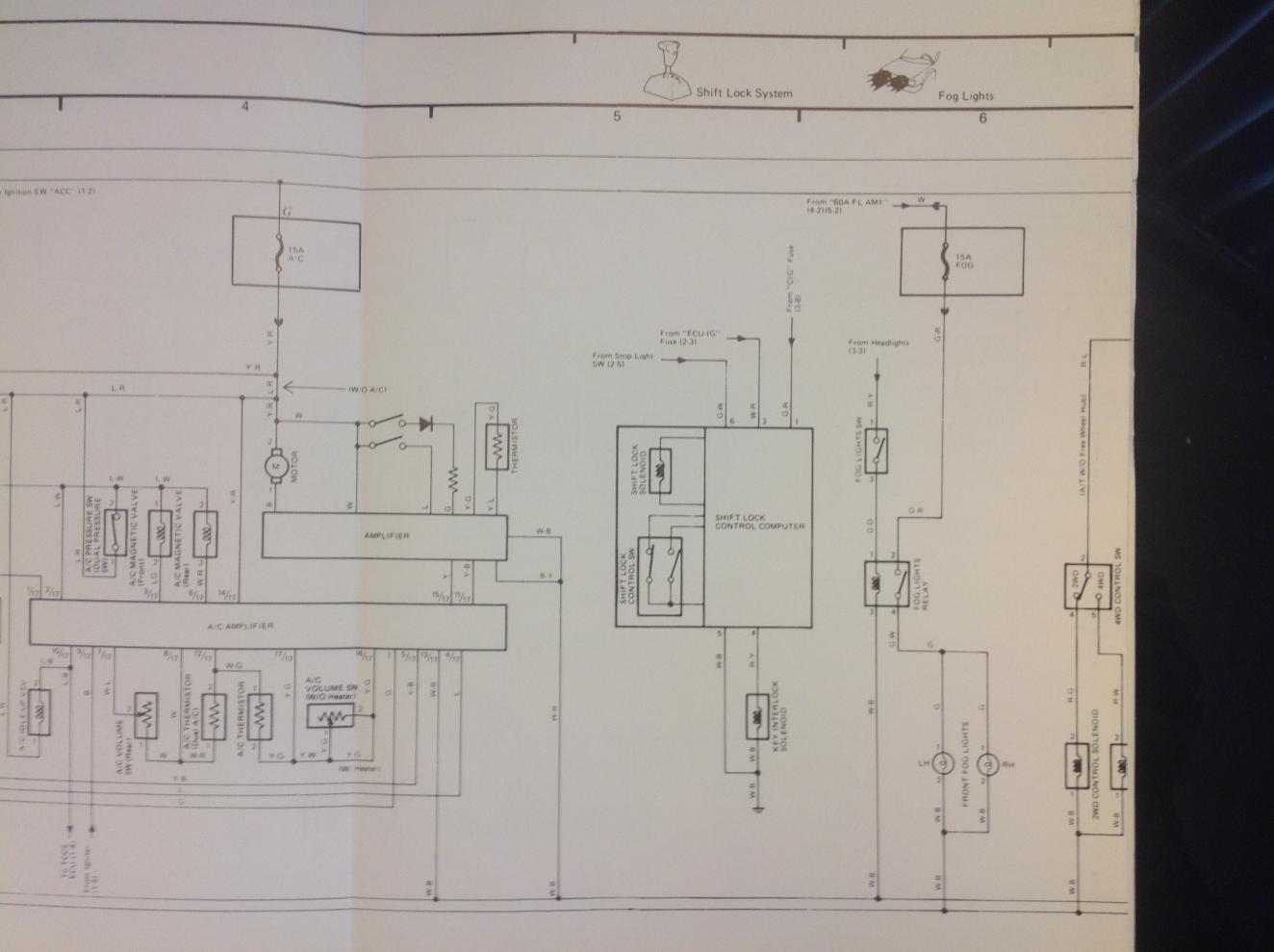

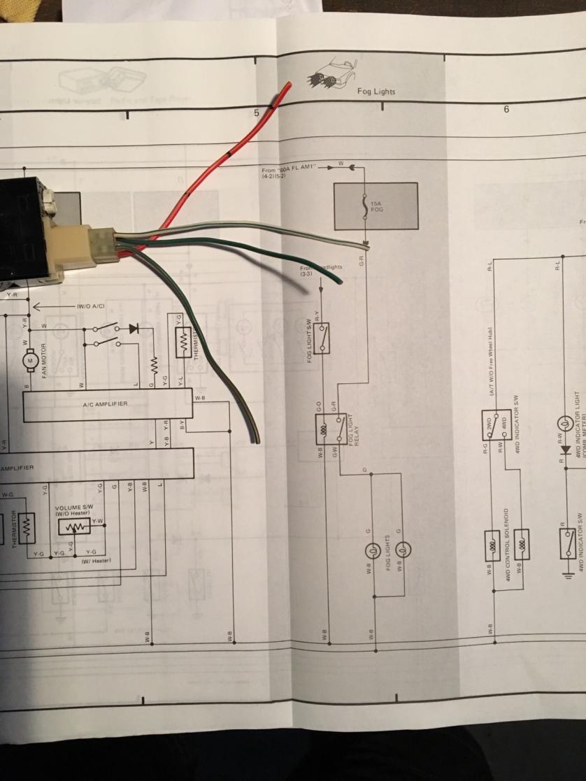

So trying to figure out wiring on adding fog lights and a switch. While I have wired a lot of the three wire accessory switches, the Toyota switch has four leads coming off it. Anyone know where the different wires go? My FSM (from an 87') seems to show only two wires coming from switch? Switch is from an 89'.
Also assuming I can use a traditional 30 amp electrical relay for this, please correct if I am wrong?

My fog light switch is from an 89' versus an 87'. I don't have access to a 88-89 FSM, but I would be willing to bet in that edition it would show four leads coming off the fog light switch, versus only two shown in my electrical diagram?
So looking at the link you directed me to looks like there was a relay for the 88-89 vans fog light circuit, but no such relay in the 87.
Any chance you can post the electrical schematic for the fog light circuit from the 88-89 FSM?
thanks Josh

That looks like the same picture I posted at the start of this thread. Manual I have is an 87', but in the diagram it appears( could be reading it wrong) that the switch only has two wires coming from versus 4 wires on the switch I have. Still confused. -Josh

ok, so am I reading the electrical schematic wrong? Shouldn't the schematic show 4 wires coming off the switch? I see 4 off the relay as I would expect, but not switch. Probably a good time to mention I am self taught in automotive electrical, and consider myself ok since nothing I have wired has ever caught fire. :rol:

I' am far from an electrician myself. I consider myself more of a fireworks expert, but could this be just a simple on/off "single throw" switch? Meaning it only cut the hot side (+). I can't see why you would need more unless each bulb had it's own circuit, or some thing like a blinking function or two different intensity etc.
Re: Wiring OEM fog lights and oem switch into van
The other two wires should be for the switches illumination circuit. If you look at the back of the switch in the photo you can see the round, white bulb socket. Fog light circuit in, fog light circuit out, light bulb power, and light bulb ground. 4 wires. :thmbup:

If you look in your schematic under "tail lights and illumination" it shows a bulb circuit for the fog light switch.

So what about the relay that's showing up in the 89' but not in the 87', are you gonna have to wire one in separately?
I see a relay on both....:cnfsd: The confusing thing to me, is the switch. Shouldn't it be showed as a "double throw" with one side for it own lighting?
A SPST switch may still be lighted (jumpers on the pic for powering the light)
The switch should operate the relay which powers both lamps, GW in the schematic.
