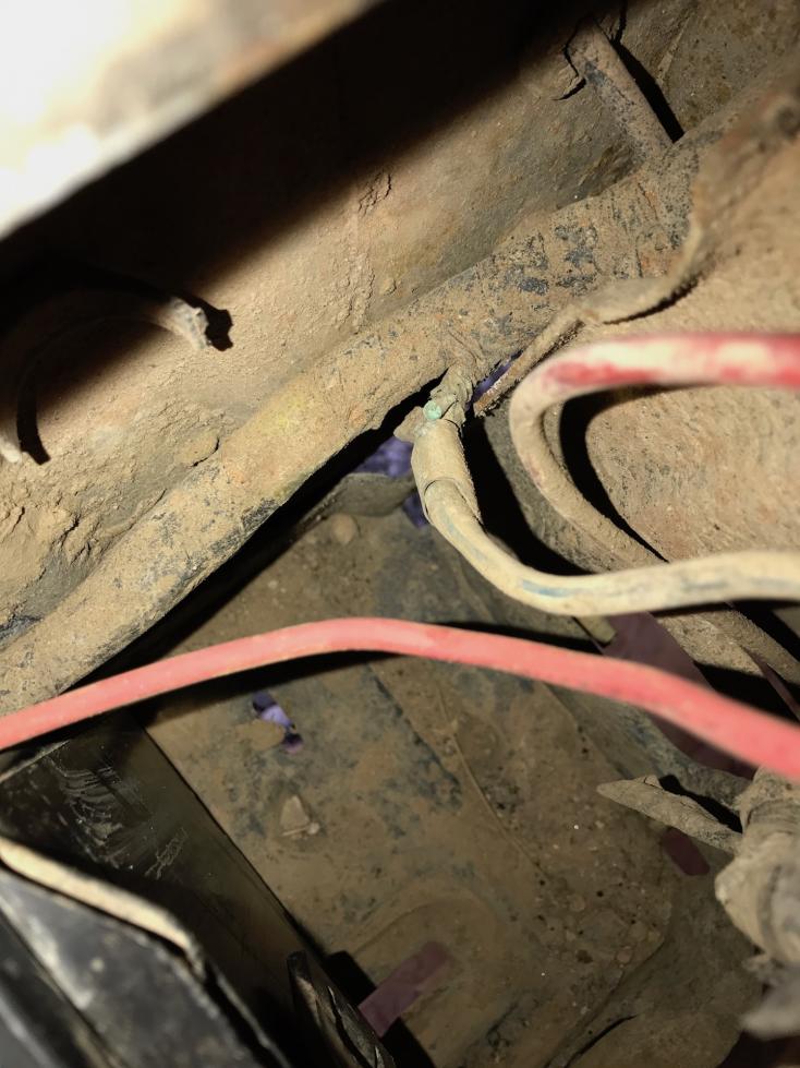

I finally had some spare time to go back to this today. Inspected the fusible links next to the PS reservoir - looked fine. Crawled under and checked the link next to the battery compartment and i think i found my problem. No idea how that happened but my guess is I must have broke it when i pulled the battery to top it off with a charge when installing my alternator. ill have to buy a new one and see if that fixes the christmas dash:
Attachment 5233
after looking through the fusible link thread, i ended up buying an 80 amp circuit breaker on amazon (part # Bussmann CB185-80) so ill try that out and see how it works. hopefully the amperage is right for my application. if I'm buying the wrong amperage let me know!

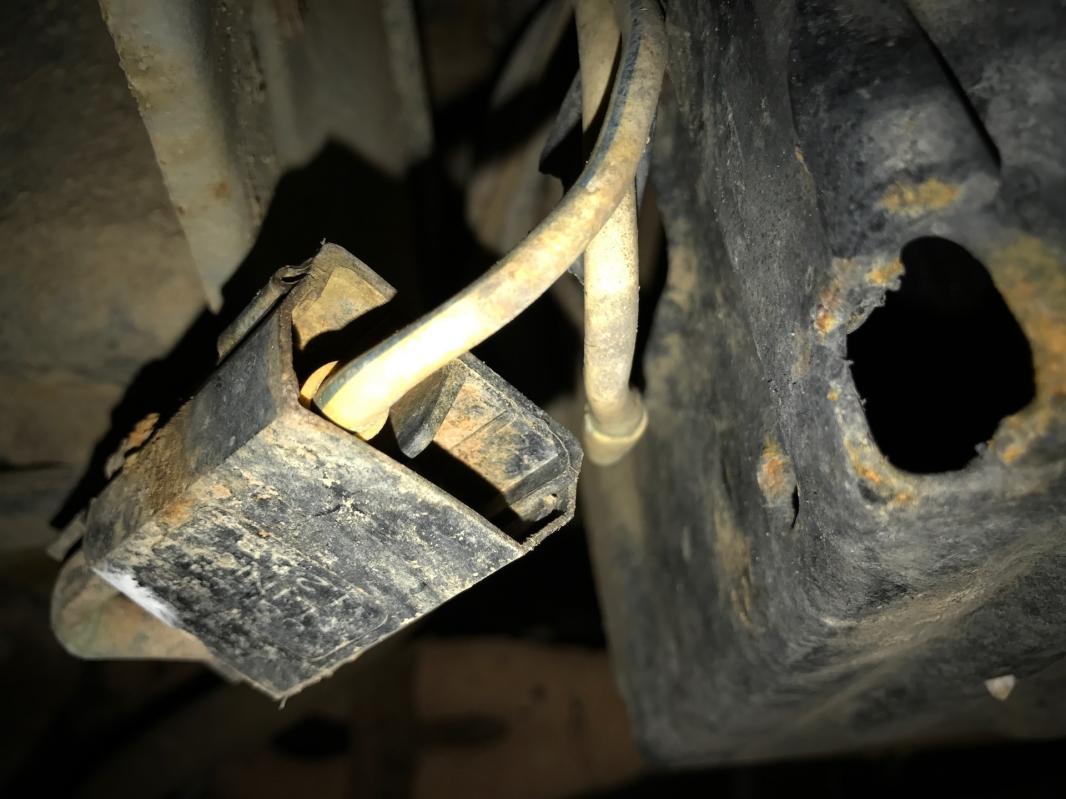

Ok, finally putting my money where my mouth is and trying to fab up a new harness. One issue, the wires on the two plugs are different gauges. Does any electric-savvy person know if this is going to be a problem? On the alternator side plug, two of the wires are 14 AWG and the ground wire is 18 gauge. On the other side plug, the wires are 18 AWG all the way around. I've read conflicting things online and nothing that particularly addresses my application, so I was hoping here someone had some insight. My idea was to split the difference and connect the two plugs with lengths of 16 AWG that brought it up to harness-length.
EDIT #3: Since I am incapable of posting anything here without having to make multiple edits, I'd figured I'd post the gauges of the wires in the harness I pulled out of the van. Two of the wires are 14 AWG and the ground is 18 AWG, the same as the new alternator side plug above. I guess a second option is just to splice in the new alternator plug into the existing harness (especially because my current alternator plug is where visible damage is and is *I believe* where my problem lies), but I figured since I was going through all of this, I might as well start fresh with all new components. Thoughts?

A reply to my last post in case anyone else comes across the same issue or question. What I ultimately decided to do was to splice the new alternator plug into the existing harness as opposed to making a completely new one. Once I really dug into the harness (the AWG numbers I came up with was from another, damaged harness I had), I saw that the whole thing had been hacked to hell and used significantly different gauge wire throughout the length of the harness. I drove it like that for years with no issues so I'm fairly confident enough that the different size in wires spliced together won't be an issue. I'm still on the lookout for another alternator-end plug so I can still make a new one for when this one is beyond repair.
