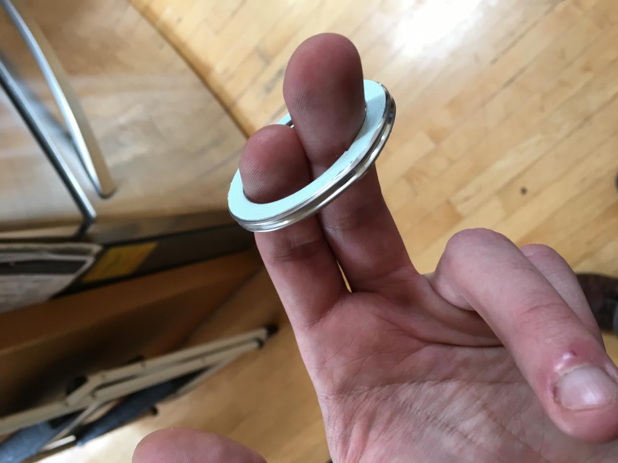

Can anyone shed some light on what these rings are (pic attached)? Six of them came with my Toyota head gasket kit (04112-73035), and I have no idea what they are for :cnfsd:
Attachment 8604
Re: Other parts to replace while replacing Head Gasket
They are a crush style exhaust flange gasket for between the manifold and header pipe marked as 17410B in the below diagram. I believe different years had different sizes and I think there may be some for the pipe to converter flanges.
https://partsouq.com/catalog/images/..._b2/MAB339.png
Ah excellent, I didn't notice those when I took the exhaust off. Thanks!

I'm currently running a turbo with head bolts (not studs). Since I'm running a turbo the likelihood of head gasket failure is high. That being said, I have not had good luck with composite gaskets, aftermarket or Toyota, they don't hold up. I'm currently running a 4y forklift stainless multi layer steel (MLS) gasket off eBay. I currently experience head lift at around 12psi, but the MLS gasket seals right back up. Composite gaskets distort into water passages, and permanently leak from then on. Same if overheated.
Using this gasket is a bit more advanced on the diy scale. You'll notice missing water ports on the gasket that are needed for the van head. I punched these out myself. Also MLS gaskets need a mirror flat surface on the head and block. A machine shop can help with that.
https://rover.ebay.com/rover/0/0/0?m...2F112980402458
For sure Tim, I just checked it myself also. Never saw this one but yea, same thing months out. So not for me I have to get this puppy back on the road.
Did you have any thoughts about the covered up passage ways I showed in the head? You must have used an original Toyota head with your history, ever notice this? I am tending to think I should cut them clear.
Any thoughts on that?
Interesting, I will have to follow this one also. So you punched yours out? Hmmmm.
Thanks for the input
mt
The smaller and missing holes in the composite gaskets made for the 4yec are supposed to be like that. You don't need to modify them.
The MLS gasket was missing the holes that even the composite gasket had. Not sure why but its missing pretty much every large cooling hole. Must be because it's for a forklift 4y. You can see it in the pic on eBay.
I used a die and press to add the holes. Interestingly enough, the holes I made were still smaller than any composite gasket coolant holes. Even so, the cooling is better and more consistent than I have ever experienced while running a turbo.
If it works for a turbo engine, it should be bomb proof for a naturally aspirated engine.

I wonder if it would seal against the factory mill marks on the deck surface of the block??? I'm guessing that would be a bit iffy. Thoughts? I'd probably go this route if I had the engine torn down and at the machine shop (I'd have them make the head and the deck surfaces smooth & shiny). I'm thinking this mod is probably not for the guy doing a head gasket in his garage with the block still installed in the van. Tim
