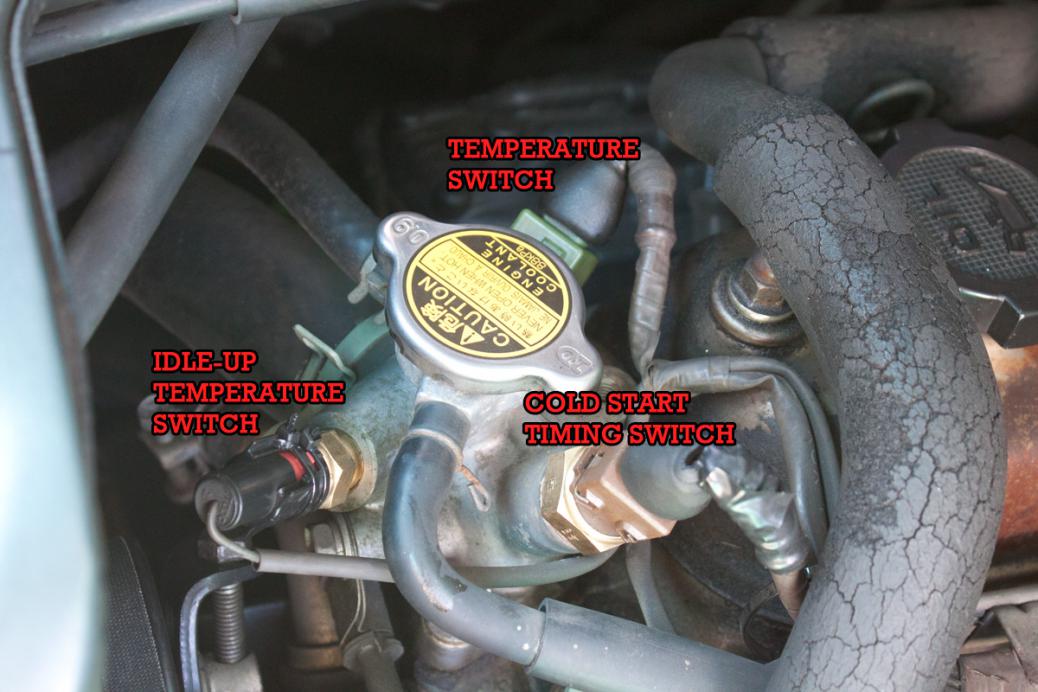

RE: code 4. Which sensor did you replace? The gauge and the computer use different sensors. The gauge uses a single wire sensor threaded into the cylinder head just above the distributor. The computer uses one threaded into the upper water outlet. Here's an image from another thread to help with the location. It's the one marked "temperature switch".
Attachment 6414
Re: Check engine light will not reset
Replaced the temperature switch, I'm assuming there's something up with the wiring I'm not finding...
On another note, the idle up switch in this picture is not wired up at all in my van. Just a nub...guess I'll be looking into this too. I don't even see a loose connection just the sensor with an open end staring up at me.

Found the idle temp switch here i think...based on a part number i got in another post
https://www.toyotapartsdeal.com/oem/...428-20050.html
What does this switch do? Should I be concerned about replacing it and running a new wire to it? Could this be the cause of my code 4?

Don't waste your money on that one as it won't change anything (especially this time of year). Here's a post I made on that previously:
That switch (Pressure-up Temperature Switch) is worthless anyhow. There was a service campaign back in the day that replaced that switch with a lower temperature one. Very few vans had that service campaign completed, and now the new switch is NLA. You're better off to just cut the old connector off, then put an eye terminal on that wire and ground it out. I usually extend the wire and put in on the front stud of the intake plenum along with all the other grounds. Doing so will activate your "pressure-up" system for 2 minutes after every start. This will help combat the
Heat Soak issue. Tim
