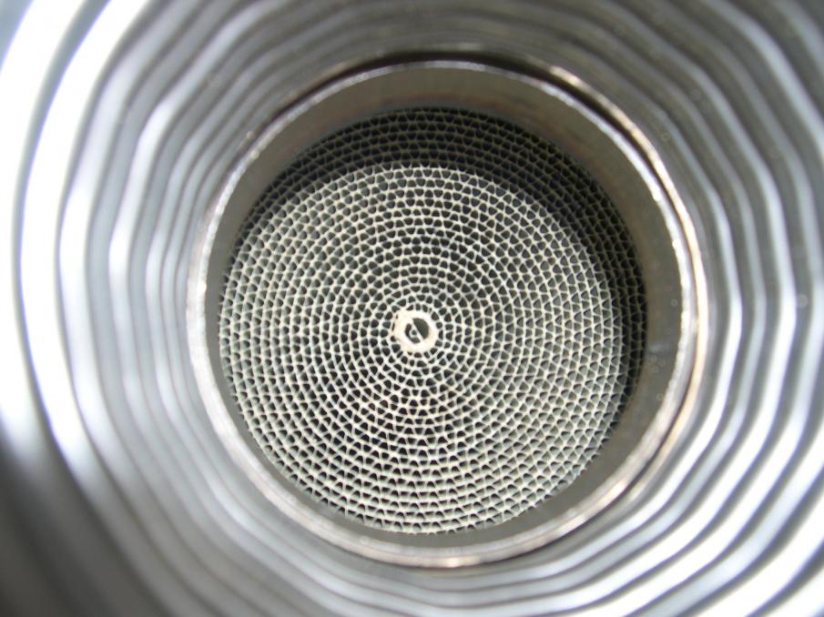

BB, the catalytic converter does not have baffles but is has a honeycomb core that can burn itself loose in the can.(Ask me how I Know) If it melt itself enough it can turn sideways in the "can" and do all kind of weird things. But you would definitely throw a code with the the post-cat OX sensor.

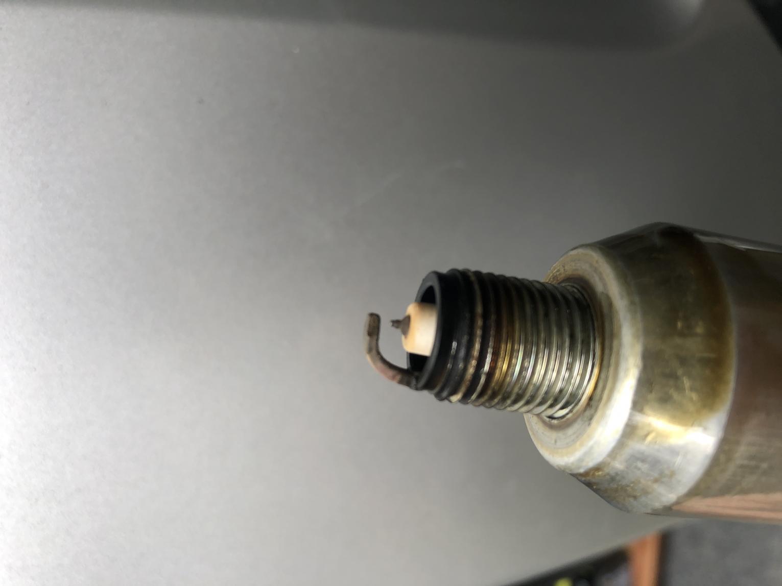

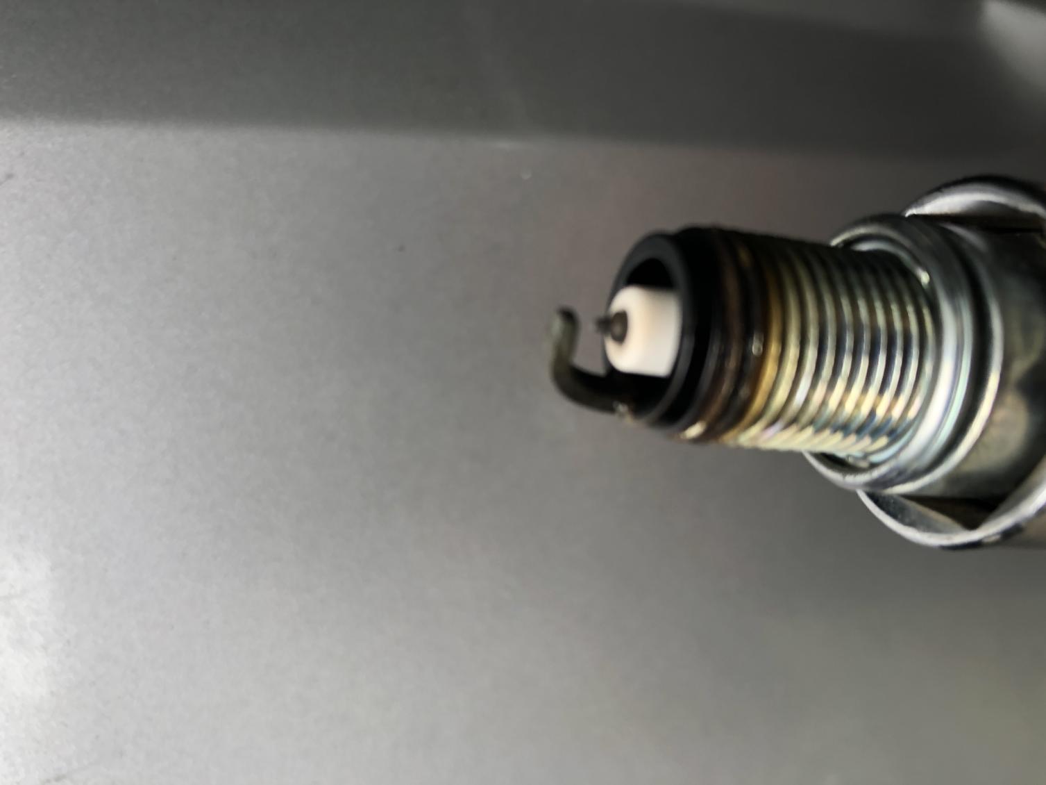

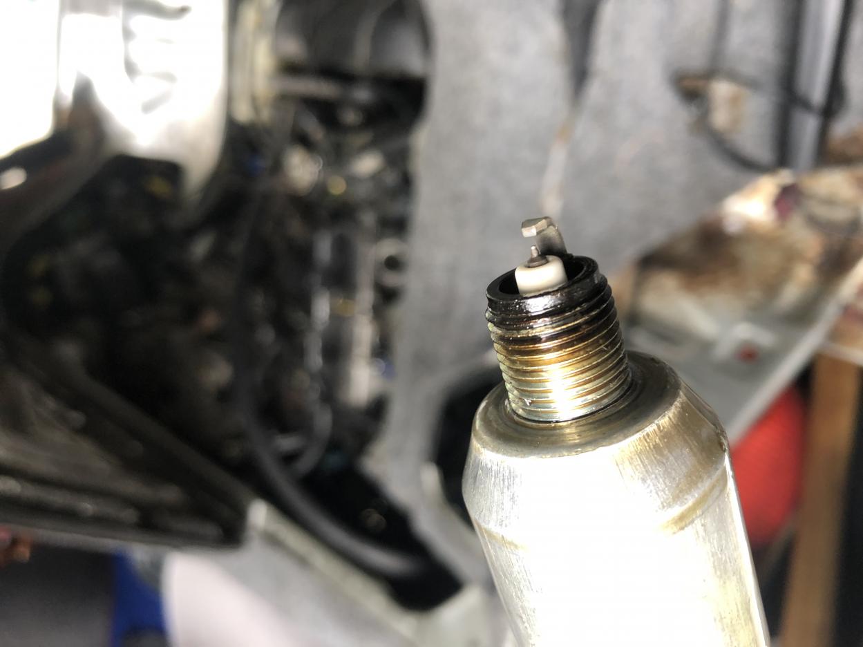

Plug photos - Slight brain fart while taking the pics and didn't get the right angles. Van had been idling for about 15 minutes... that being said here they are:
Attachment 9224
Attachment 9225Attachment 9226Attachment 9227
Re: Strange Exhaust Noise - Help with diagnosis please
Looking again it appears I maybe have oil on the threads of all of the spark plugs? I didn't think too much about this since they all had it... seems weird that they all would have it? Maybe a valve cover gasket?

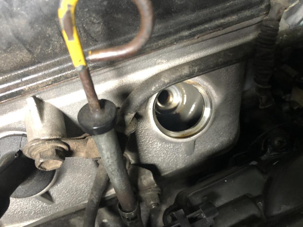

OK - there is definitely oil in the spark plug wells - this is almost certainly a valve cover gasket that needs repair?
To be clear - oil is not getting past the spark plug threads and into the spark plug "tube" but is present underneath it.
There re o-rinngs that fit under the "spark plug tubes", that are more than likely leaking. This lets oil creep down into the tubes.
It won't cause the exhaust studder. I second the Catalytic malfunctioning, casing that putter.
That first spark plug doesn't look like it is firing. It looks very clean.
Second plug looks like a slight lean condition. A touch of white ash forming on the tip.
Third plug looks like it may not be firing all the time, gas is washing carbon off the plug.
Fourth plug is what a spark plug should look like, slight brown color with a slight bit of carbon.
Now we know what they look like at idle, when you have an opportunity, take it for a short drive. Get it up to temperature and when you park it, immediately shut the engine. Don't let it idle, that will allow the gas to wash the first and third plug and skew the results.
