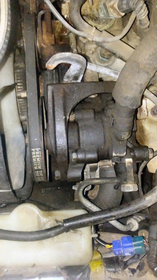

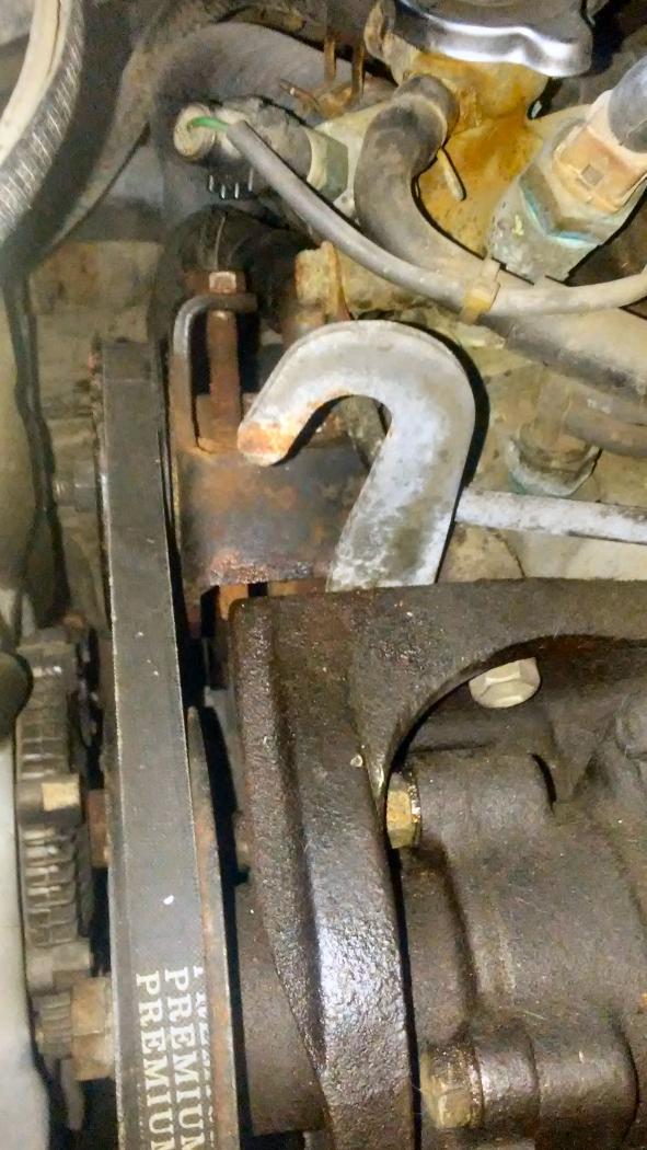

Take a pic of the bolt... or just point to it...
https://i.imgur.com/cS697bH.jpg
ok, thats your power steering belt tensioner. First hose it down with some thread lube, like PB blaster... Next, loosen the pulley bolt enough to ease the tension on the block. Should loosen up after the pb penetrates the threads some.
Beyond that advice, I don't know what else to say... :slap:
I don't know what to say either.... If that's the power steering belt tensioner, where the heck is the thing that needs to be adjusted to tighten the alternator belt? Because that's the only thing I see that looks like an adjuster of some sort in the general vicinity of the alternator.

Indeed you did, but when I look in the same spot in my van, I don't see the same thing as what's in your photo! Shall I post a photo of what I do see, taken from the same angle as your pic? I only posted the photo above to show the stuck bolt but I can take another pic to show that there's nothing like what your pic shows anywhere near MY alternator.

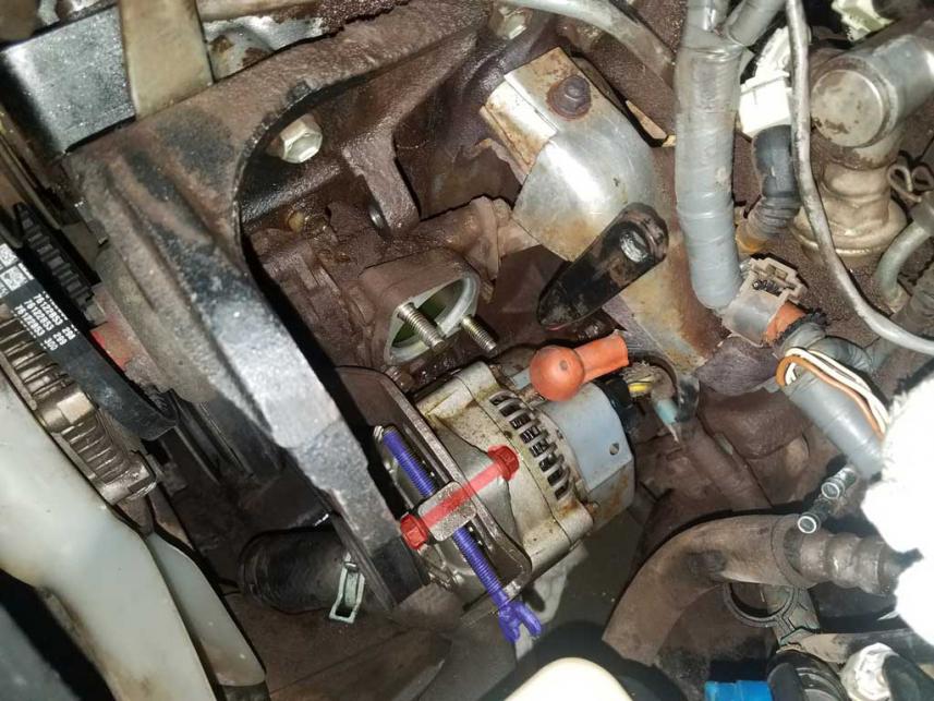

First loosen the red bolt with a wrench. Tighten the Blue Wingnut by hand until you get the right tension. Tighten the red bolt.
Note: the photo shows a nut on the back of the alternator, that should not be there. it becomes inaccessible when the water hose is in place. Whoever put that on there is asking for trouble later. Its a solution when your missing the blue wing-nut-bolt and a slightly longer bolt won't hold on its own (as was mine when I first got it).

As for the belt-tensioner to adjust the power steering belt, the pulley slides up and down using that rusty bolt sticking up and down. However the block that it goes to is tightened down to the pulley so it doesn't slide up and down freely. First you have to loosen the pulley before you can adjust it. Same concept as the alternator but with a hex head instead of a wing-nut. The bolt goes thru the pulley, doesn't need to come off. If you try and adjust the tension without loosening the pulley first you'll bend the thing. Sometimes the pulley spins when your trying to loosen it, apply tension to the belt to tighten it up

Your missing your wingnut bolt. I found mine in a junk yard. Mine was being held in by the tension of the red bolt alone, stripped alternator made it essential to fix with a longer bolt, it held for awhile but eventually the rest of the threads striped. I used a zip tie to the aluminum block and where the blue wingnut holds. Eventually it gave and i replaced it with two. They held for quite some time until I found the bolt.

The upper photo you posted looks like the one Flecker posted, and the lower one looks like the one I posted. But I see a huge difference between the two photos.
The red nut in the lower pic appears to be in a completely different location than the red one in the upper pic. Also, I do not see the alternator in the lower pic! I Do Not See It.
Is there something *removed* from above the alternator in the upper pic? Do I need to remove something before I can SEE my alternator?
Is there a DIFFERENCE between what you are calling the power steering belt and the alternator belt?
The belt that is too slack in my van is the one you can see in the lower photo with the label that reads "PREMIUM TOP (something)" sideways twice.
The alternator is below the power steering pump. Its missing in the photo the other person posted. The radiator hose goes over the back red nut normally.
The alternator and power steering both have a different belt. They both connect to the main pulley.

The main pulley is the big one on the engine. The alternator belt it goes around it, the water pump and the alternator. The power steering belt goes around the power steering pump, belt tensioner and down to the main pulley.
Here's how I fixed mine. I first got a longer red bolt because the alternator was stripped from the previous owner. It eventually stripped out the remaining threads from slipping and needing readjustment. Rather than take the radiator hose off and put a longer red bolt with a nut on the end I chose to use zip ties temporarily (I didn't know the blue wing-nut-bolt existed.). I highlighted the zip ties in blue as it replaces the wing-nut-bolt.

Loosen red(apply tension to the belt to hold the pulley if needed). Tighten blue (spray a few times daily for few days with penetrating fluid if stuck). Tighten Red.

Also, it looks like you have the wing-nut-bolt on the alternator but its hidden from by a metal hose.
Do you see any blue in the photo? colorblind? I used photoshop to highlight the black zipties blue so it would be easier to understand that they are replacing the wing-nut-bolt. However if you got a better photo of your alternator I think it might be there in your van.
And if its the top belt that your trying to tighten that's not the alternator belt. The alternator belt is hard to see, it tucks back into the engine and to check the tension you'll need to reach your hand down into the engine bay and grab onto it down there.

The top belt seems to be too slack. If it's the one doing the squealing, so much the better because I can at least SEE it. I thought it was the alternator belt doing the noise because of when I hear the squealing (it's not when executing turns).

Suzu, in Fleckers picture posting number 8 you can see the alternator clearly because his power steering pump has been removed, in your picture posting 9 you’ve taken a picture of the power steeering adjustment bolt... 2 totally different locations. Your picture of the bolt is directly under the radiator cap and the 3 sensors. Looking at your picture posted in number 19 it looks like you don’t even have a alternator in there let alone the wingnut adjustment bolt? I think that’s what your missing??Please don’t take it wrong everyone is trying to help and sometimes it’s easy to get lost in reading and translations.For me... I don’t see the alternator in posting number 19?<br><br>JDM
<br><br>The adjuster bolt is there, it's just hidden under the PS hard line. <br><br>https://i.imgur.com/9ihKm7P.jpg

Loosen the bolt highlighted by the RED arrow first. (loosen counterclockwise)<br><br>Then tighten the wingnut highlighted by the GREEN arrow. (twist it to the right)<br><br><font face="Verdana,Arial,Tahoma,Calibri,Geneva,sans-serif">https://i.imgur.com/f4OVpMP.jpg</font><br><br>After your done tighten them up again...<br><br>After al this, when you realize that the belt that is actually squeeling is the Power steering belt, hit up Phycotron's photo and instructions.<br><br><br>
When trying to tighten the alternator belt an important thing to remember is to only hand tighten the wing nut. Don't use a tool to tighten it. Wingnuts are used to stop people from over tightening something with a wrench. Chances are if its already tight it won't spin any more. Check the tension on the belt, it should move up and down just a little bit, less than a quarter inch. If its good then its almost certainly the power steering belt.

Since you won't be able to work on it for a few days its a perfect opportunity to spray penetrating fluid on the rusty bolts on the belt tensioner once or twice a day till you can get to it.
As for my graphics; I used blue but I see now how it turned out purple in my pictures. Ignore everything i said about zip ties (though they are highlighted blue/purple, not sure why your not seeing the color if you can see the zip ties)
I fully understand what to do now, thanks to you wonderful folks. Just one question left: In Flecker's latest pic, the bolt with the red arrow *appears* to be directly behind a pulley or something, which would make it impossible to turn with anything other than a crescent wrench unless the object in front of it was first removed. Is that correct? If not, is that thing that must be turned actually *not* behind something that makes it inaccessible to a socket wrench, and it just looks like it is?
