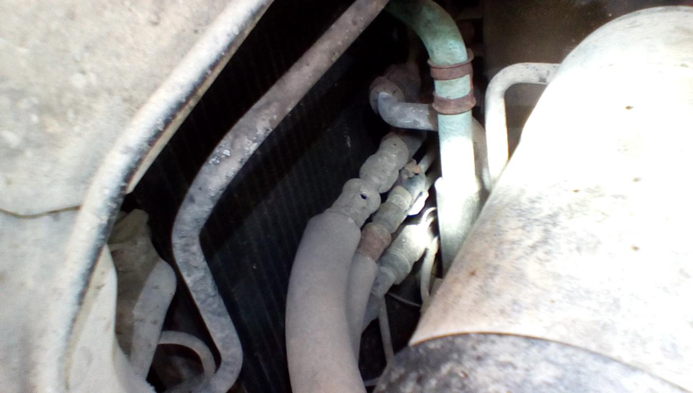

Did you find it yet? On one of my 88's it's right in front of the radiator. Two lines extend from the bottom side of the condensors up in front of the radiator and the switch is mounted between them. I'll try to look at my other van and post a pic later today if you need it.

First pic is from passenger side with receiver/dryer in the right foreground. The flashlight beam is focused on the wires for the upper switch. There is actually two of them. One on top of the pipe and one below.

I circled there location in the diagram in my manual. I suspect the '87 manual has the same pic as my '88 manual but I don't know why they didn't label the pressure switch in the 4WD diagram.

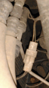

Great picture, thanks! I found mine just where you said it would be:
Attachment 5394
I don't know why there are two of them; more study required.
There are two connectors, one white one between the switches, and one where they go into the harness, Do you know if I can just put a jumper in the connector between the switches, or is it the other one? They're easier to see than to reach, from below for me, anyway.

I stuck a jumper in the white connector on mine the day I took the pic but it didn't do anything. Then I remembered this van doesn't have an a/c belt on it.:doh: I need to do a/c work on both of mine so I'll hopefully be revisiting this soon. You can unbolt the a/c condenser with two bolts on either side and one at the rear nearer to the radiator. At that point the whole carrier frame will hinge down on the center two mounts and the flexible rubber portion of the hoses. You can also finagle it up and out of the two center mounts and pull it down further. This was how I gained enough access to get two hands on the connector to safely separate it as well as to remove the fans and hose the dirt out of everything a few years ago. I glanced at the wiring schematic briefly but hadn't determined the purpose of the dual pressure switches before my lunch break ended the day I was messing with it. I have a camping trailer needing rot repair this weekend that is taking priority over the vans at the moment. We'll have to keep each other updated as we go.
