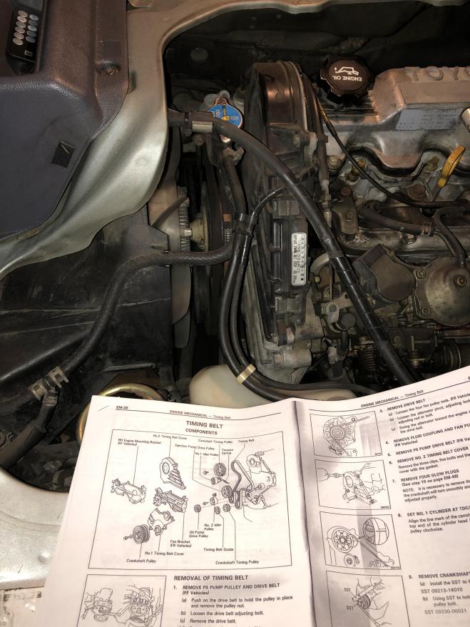

check TDC, remove the glow plugs, align the top pully with the timing marks.
I like to start at TDC
Re: 2CT timing belt change
day 2. :slap:

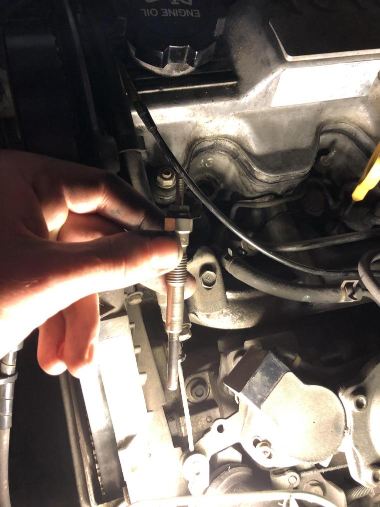

about 30+ mins to remove the glow plugs cuz thats in the manual so you can align the TDC mark, thinking the compression will be to strong to rotate the motor.... however the last glow plug is a bit difficult to get to so I left it in, and no issues, I didn't have to rotate it full cycle , so maybe that the deciding factor. Maybe someone else can verify if really needed. edit, *when you put on the new belt, the manual says to rotate thru full cycle 2 times, I tried with glow plugs in, no go. I removed the 3 plugs I could get to and was easy enough* so removing only 3 plugs is acceptable when replacing the timing belt.

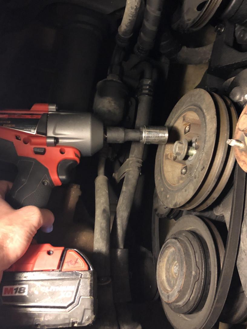

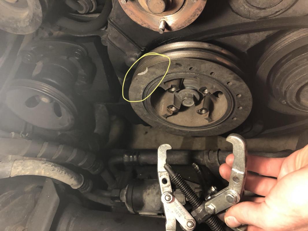

Next, remove the crankshaft pulley, I encourage everyone to invest in a impact, electric was easy enough to use.
19mm or 3/4"
Attachment 9694
and this is where I stopped for the night..... :wall::wall:
I don't know what to do. may just grind it smooth and leave it alone... I doubt I can find a pulley this side of the world in decent amount of time.

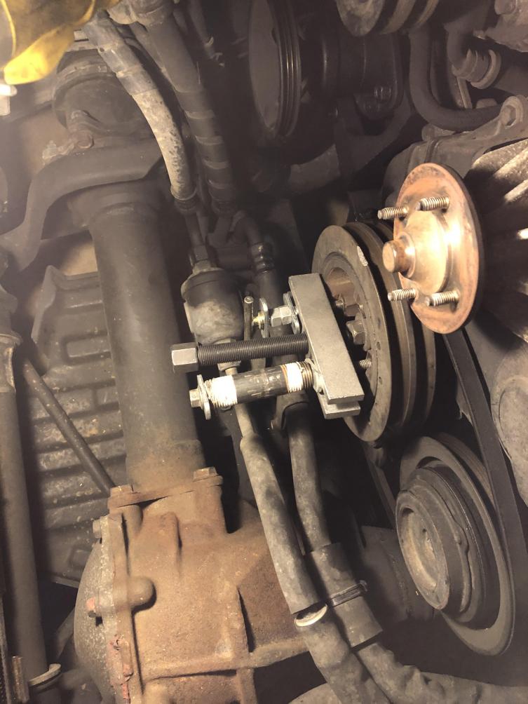

The puller tool has wider teeth, all I have to do is rotate the pieces. Tomorrow morning lets hope the pulley comes loose.
Attachment 9693
I tried to use that style puller also with the same results. You need one that attaches to the bolts, I got one at Autozone. On the TDC you can just pull the timing cover and line up the mark on the cam gear to the head.

Good deal, Ill head up there this morning and see what they got.
Day 3.
rented the timing belt puller, for all of $16 probably should of just bought it.
the 2 bolts that it came with are the wrong thread pitch, so I had to improvise.:wnk:

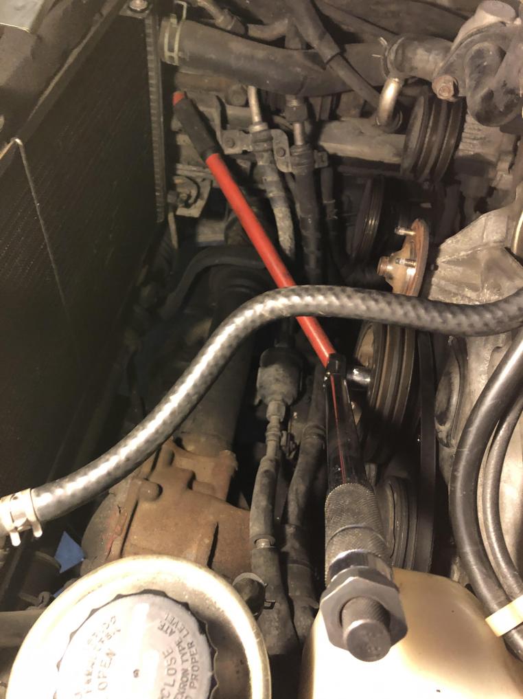

72 ft#, glad I had an breaker bar to use to jam up the crankshaft pulley from spinning,

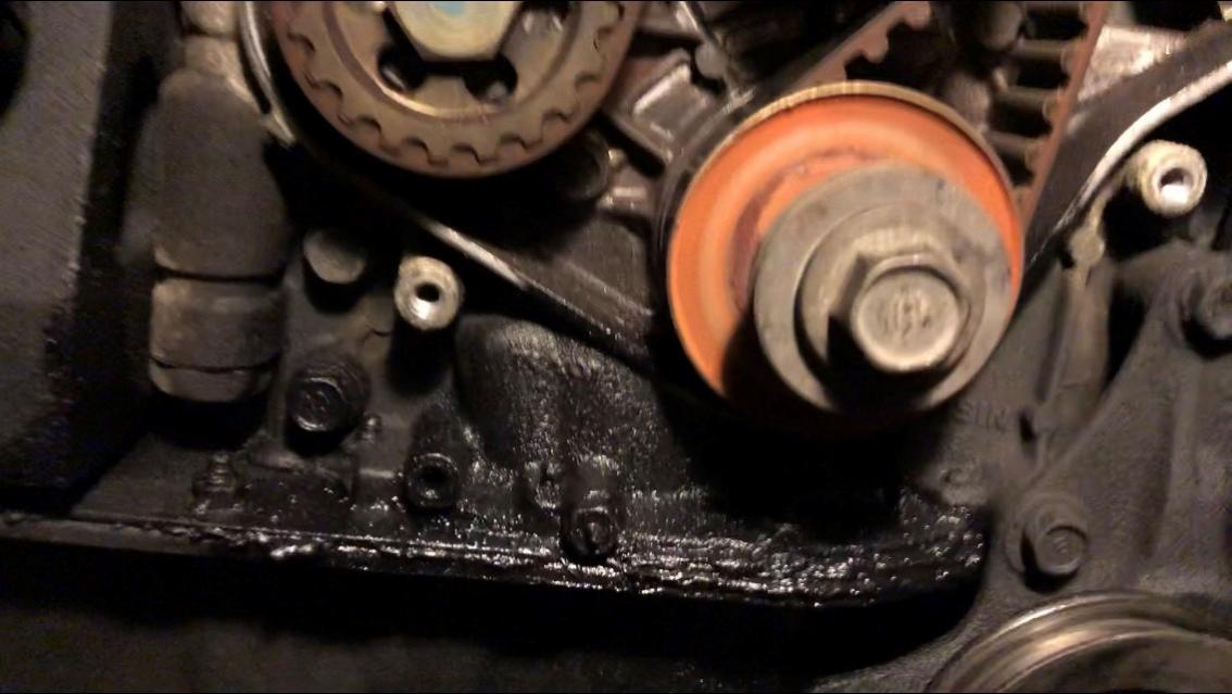

Attachment 9711
Attachment 9710

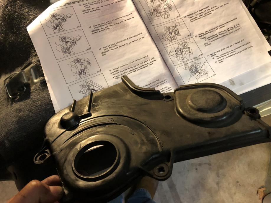

Not only the oil present but also the cover being tore up were the crankshaft pulley is located.
The leak is not to bad at this time, so I'll start buying parts to replace those seals (unless you have to measure first), I was reviewing the manual of how to replace the crackshaft seal but was overwhelmed by the steps.
how did you replace the seal for the crankshaft?
I thought you'd have to drop the oil pan and un-bolt the pistons so the crank shaft could be pulled out. :cnfsd:
Looking at the pics in the manual, the oil pump houses the crankshaft seal. and the oil pump casting is one piece that you remove from the lower front part of motor. that sound right?

The seals get hard with age and can no longer seal the oil. Each of the seals needed to be pulled in order to measure and then replace. No need to pull the crankshaft to replace the seal. I believe I used a screwdriver or a pointed punch, drove into the seal close to the crankshaft without scoring the crankshaft, and was able to pry it out. I coated the sealing surfaces with grease and used a block of wood as a drift and drove the seal in, working one side then the other until it was completely seated. I was able to use a seal puller for the other 2 seals.
The oil seals I ordered from Amazon were: Oil Seal 20X32X5 R Oil Seal Grease Seal TC | 90029-21007 |EAI Rubber Double Lip w/Garter Spring 20mmx32mmx5mm | 0.787"x1.260"x0.197" (I think this was the oil pump seal, but may have been the cam shaft seal. I was able to get one from RockAuto.com and these other 2 I got from Amazon.)
Oil Seal 38X50X6 R Oil Seal Grease Seal TC | 90311-38025 |EAI Rubber Double Lip w/Garter Spring 38mmx50mmx6mm | 1.496"x1.969"x0.236" (This was the crankshaft seal)
When you measure them, it is the bore x diameter x width of the seal. The "R" denotes rubber coated.

I would try and replace the timing covers with new ones. What happens is over repeated heat cycles and oil on them they warp. They will rub on things and not do there job.
hooooo, makes sense, I should probably sealed the tore area with RTV sealer or something to keep dirt and junk out of there....
