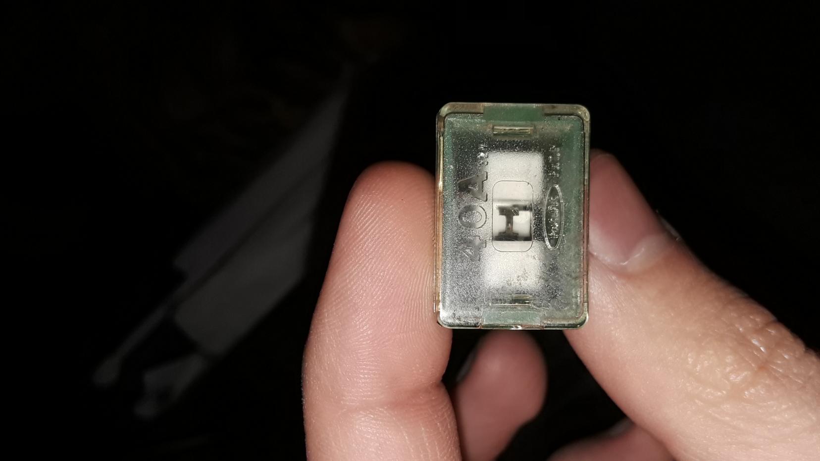

! > Checked the 40A HEAD fuse behind the seat and wouldn't you know, it was blown and burnt somewhat! I'll grab a pic tomorrow, it's dark out and the lighting isn't the greatest for a tiny part like this. Did put in a spare I have and I'll be checking periodically on it when I use the van more. Replacing the fuse did nothing so there's that, new one didn't blow either. :rolleyes:

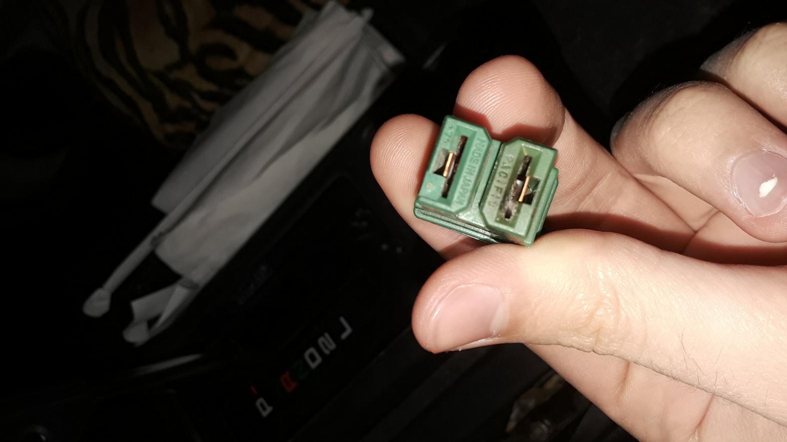

Got a bit caught up in relaxing over the weekend, heres my original fuse's blown condition
Attachment 11913Attachment 11914
One of the pins definetly burnt good. Think it might've been the bottom one I'll double check to confirm it. Not good but at least the fuse did its job.

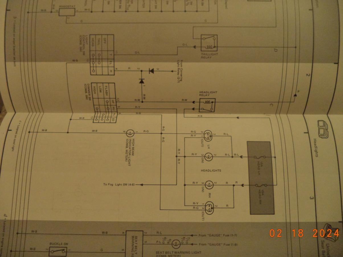

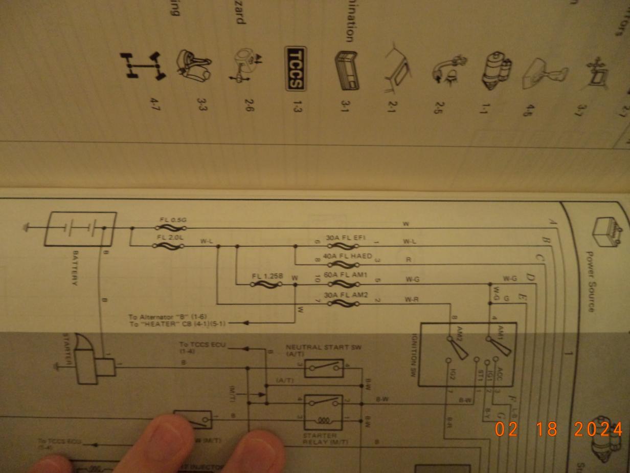

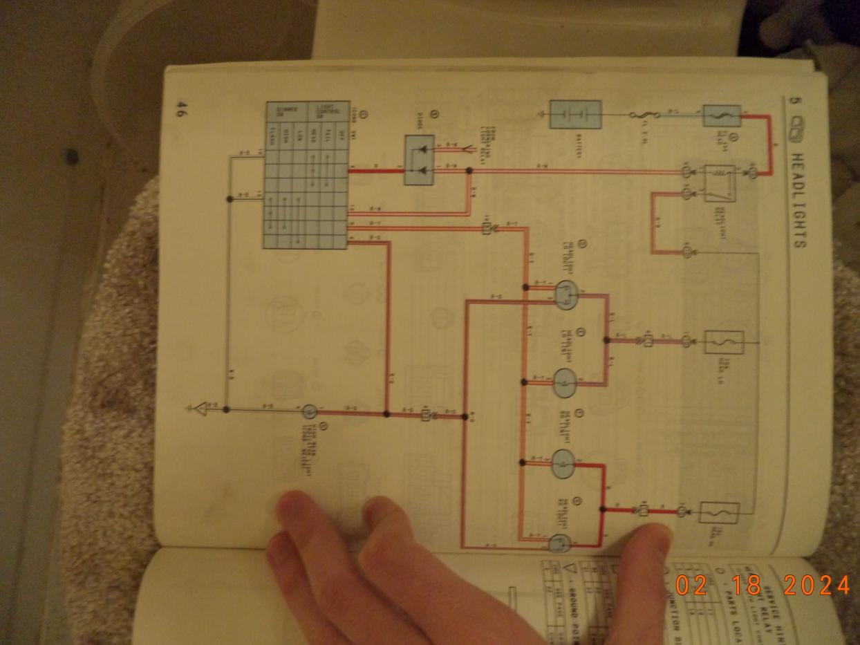

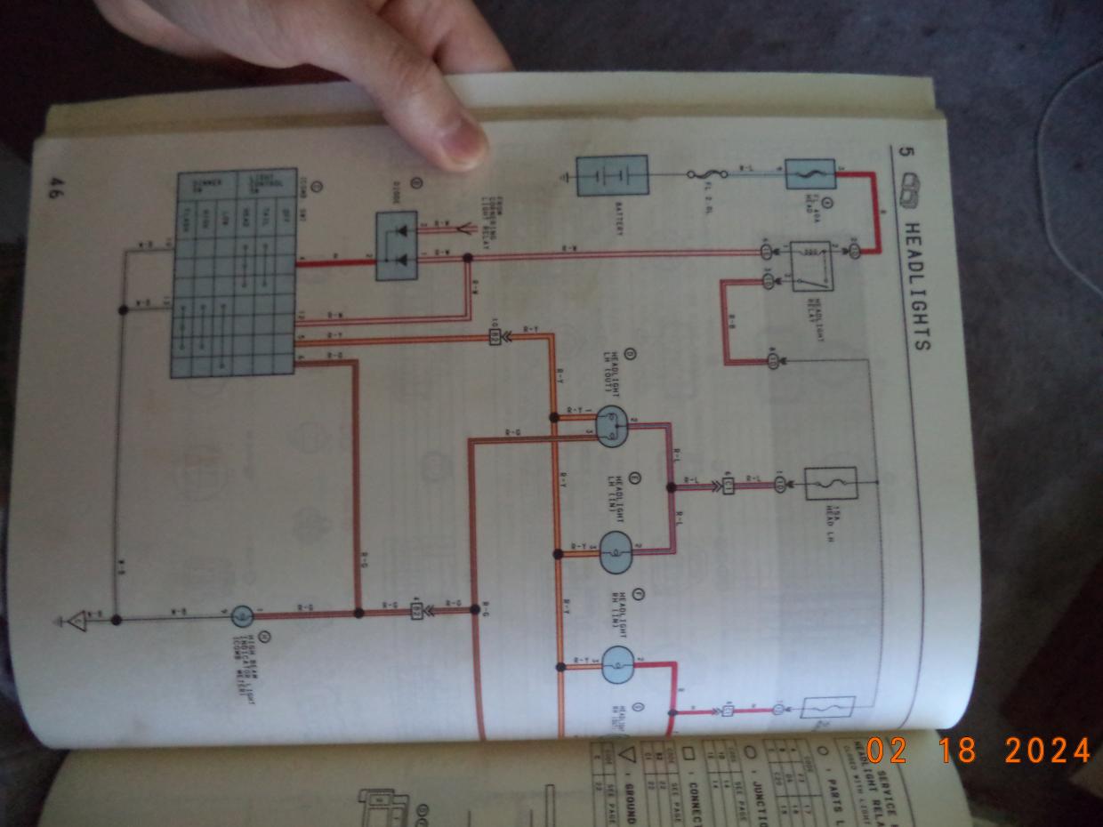

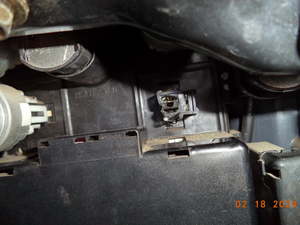

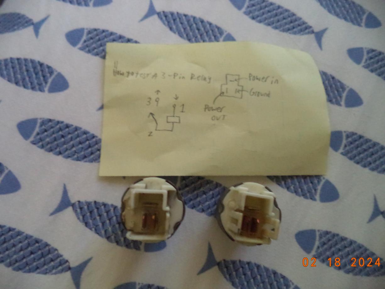

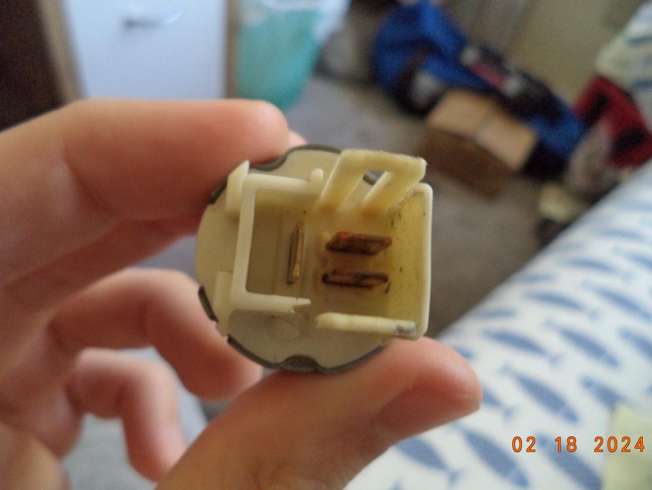

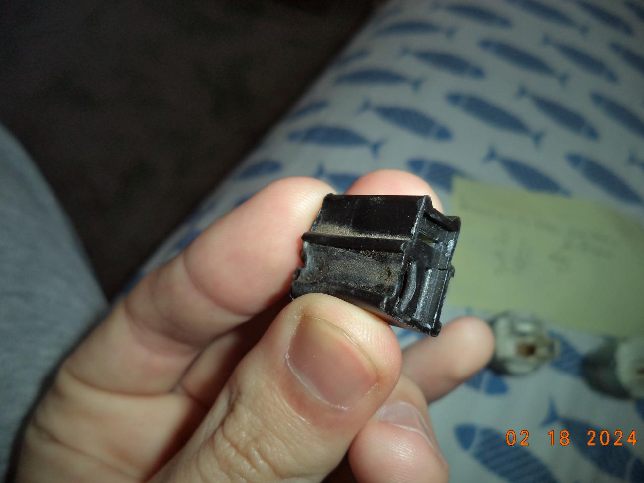

Seems like a fitting update for the thread, pardon the necro... Tonight I (with the help of a classmate and the Factory Wiring Diagram) determined the appropriate power flow of the headlight circuit (Battery -> 40A Fuse -> Relay -> 15A fuses for L/R lamp Hi and Lo assemblies.) Found out my relay had gotten quite warm enough to melt some plastic and that's probably why my 40A fuse popped, but somehow my 15A ones were fine, probably order of the fuses then!
My theory as to how this happened was: Original headlight assemblies accumulated moisture in them, must've been doing something (too much resistance, or pulling too much current?) to get the relay toasty, but the 40A fuse sacrificed itself to prevent damage obviously. Connections on the old relay are pretty crusty, so I might have to postpone my fog light wiring to sort this headlight issue out FINALLY! I will upload my findings and the wiring diagram for those interested tomorrow :thmbup::silvervan:
